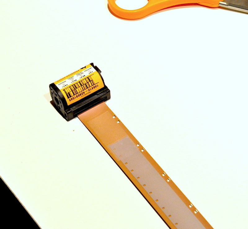

My efforts so far have failed. I got the film cut to the right size, got the perfs lined up. The camera will load the film but just wind to the end and then rewind it. I've tried in Top of the line cameras, mid and cheap. So far no luck. I wonder if Mr. Chong knows something I don't.
The same happened with original expired APS film with bad magnetic strip!

Ok, four months later, I found my one APS cartridge and Advantix camera. The idea of taping 16mm film to the APS film did NOT work. It bound up in the camera.
Even a strip of 16mm film only 20cm long still bound and jammed the camera.
I think I'll stick to reloading sheet film holders, 35mm, 16mm and Minox cartridges for now.
View attachment 358922View attachment 358923View attachment 358924
Excellent idea! You have to use some 16mm microfilm, it usually have a 0,12-0,15mm thick base. And it is unperforated.
The APS frame height is 16,7mm, but for panoramas is 9,5mm -so 16mm unperforated film is enough.
Tо glue only the beginning to properly roll the film... Ideally, make a cutout 0.5 mm deep and 16 mm wide in the frame window plate...
But the problem how will camera understand the multi exposing of the film?
