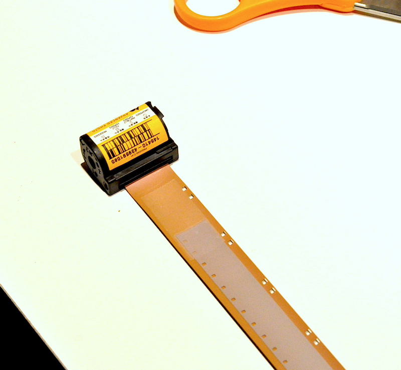

My efforts so far have failed. I got the film cut to the right size, got the perfs lined up. The camera will load the film but just wind to the end and then rewind it. I've tried in Top of the line cameras, mid and cheap. So far no luck. I wonder if Mr. Chong knows something I don't.
I still think I have an APS cassette. I'll check again.

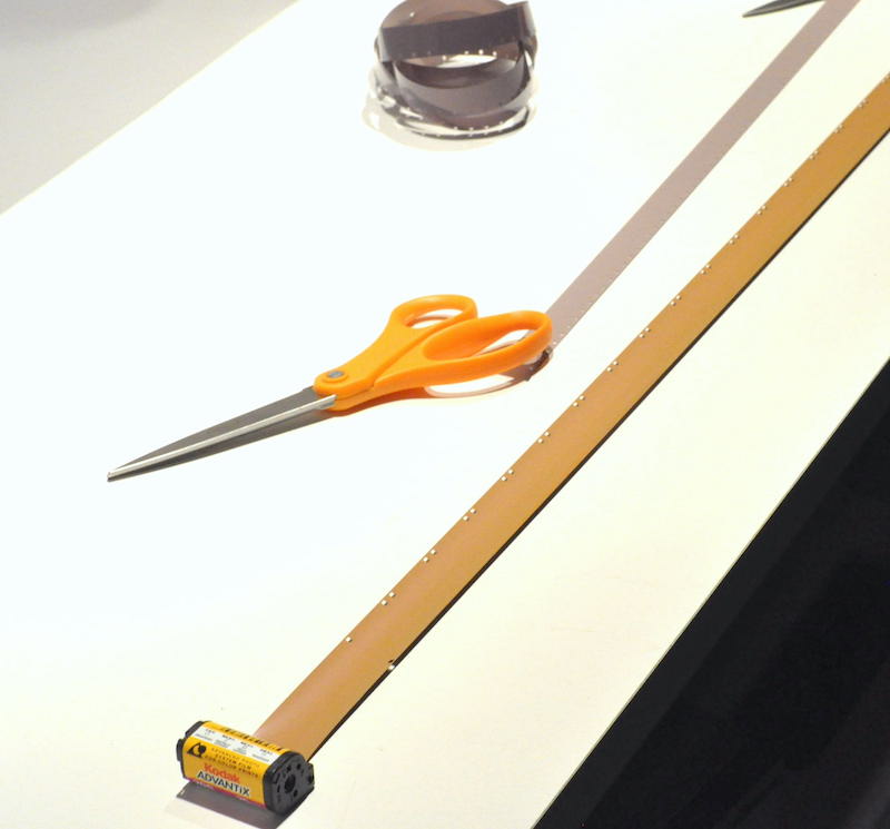

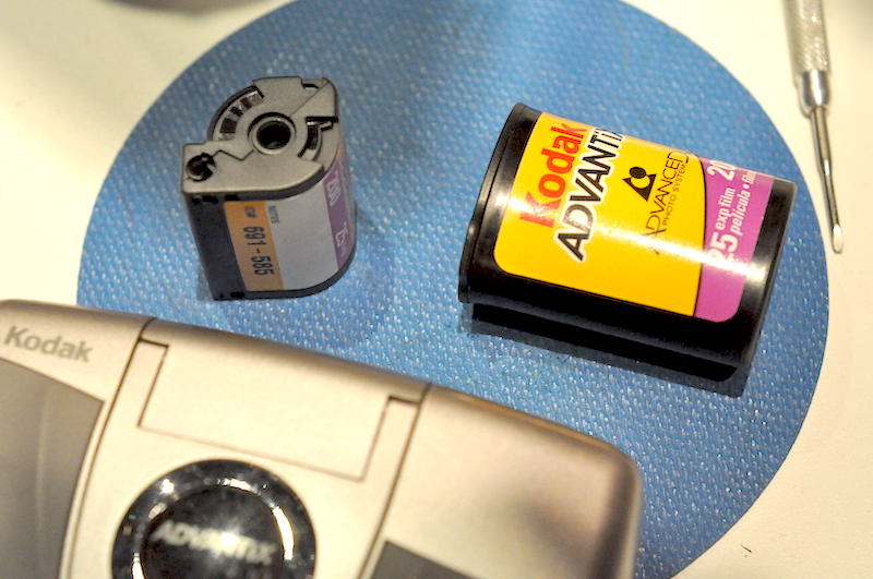

Ok, four months later, I found my one APS cartridge and Advantix camera. The idea of taping 16mm film to the APS film did NOT work. It bound up in the camera.
Even a strip of 16mm film only 20cm long still bound and jammed the camera.
I think I'll stick to reloading sheet film holders, 35mm, 16mm and Minox cartridges for now.

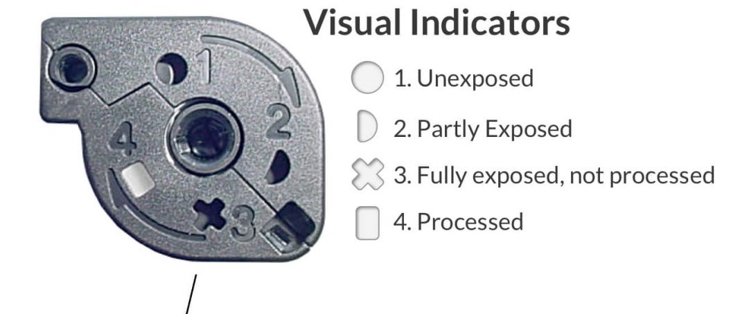

Did you have the film indicator on the cassette at the No. 1 position when loading the film into the camera?
APS had the ability to partly expose the roll and then be removed, to be replaced and resume where it left off. So it must have used the magnetic strip to indicate that position, no matter what camera. Were there any cameras that could not partially expose a roll?
