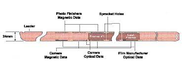

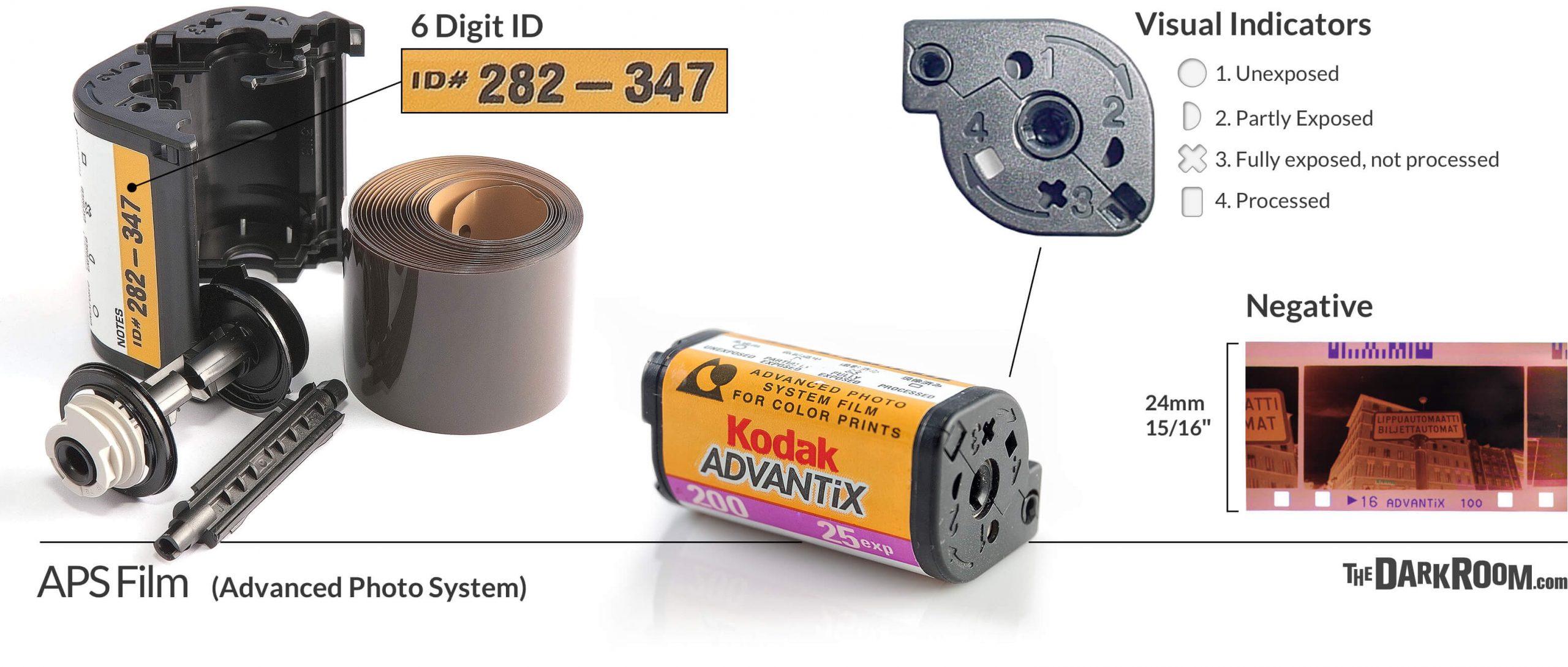

These images might help in understanding how the APS film cassette works.
The visual indicator must be in the correct position (1 or 2) for the cassette to work in the camera. Sprocket holes are needed for the film to work in the low spec cameras, it may also be necessary in the more sophisticated camera (they also use the magnetic data strip).
Note the film end on the right of the image above. These two holes are used to attach the negative roll to the center spool in the cassette. It can be very tricky to do in the dark and not damage the spool, the cassette and the light trap.
