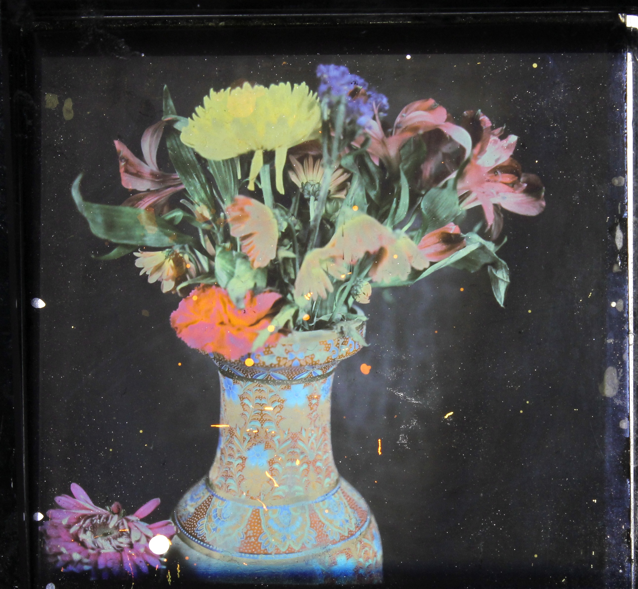

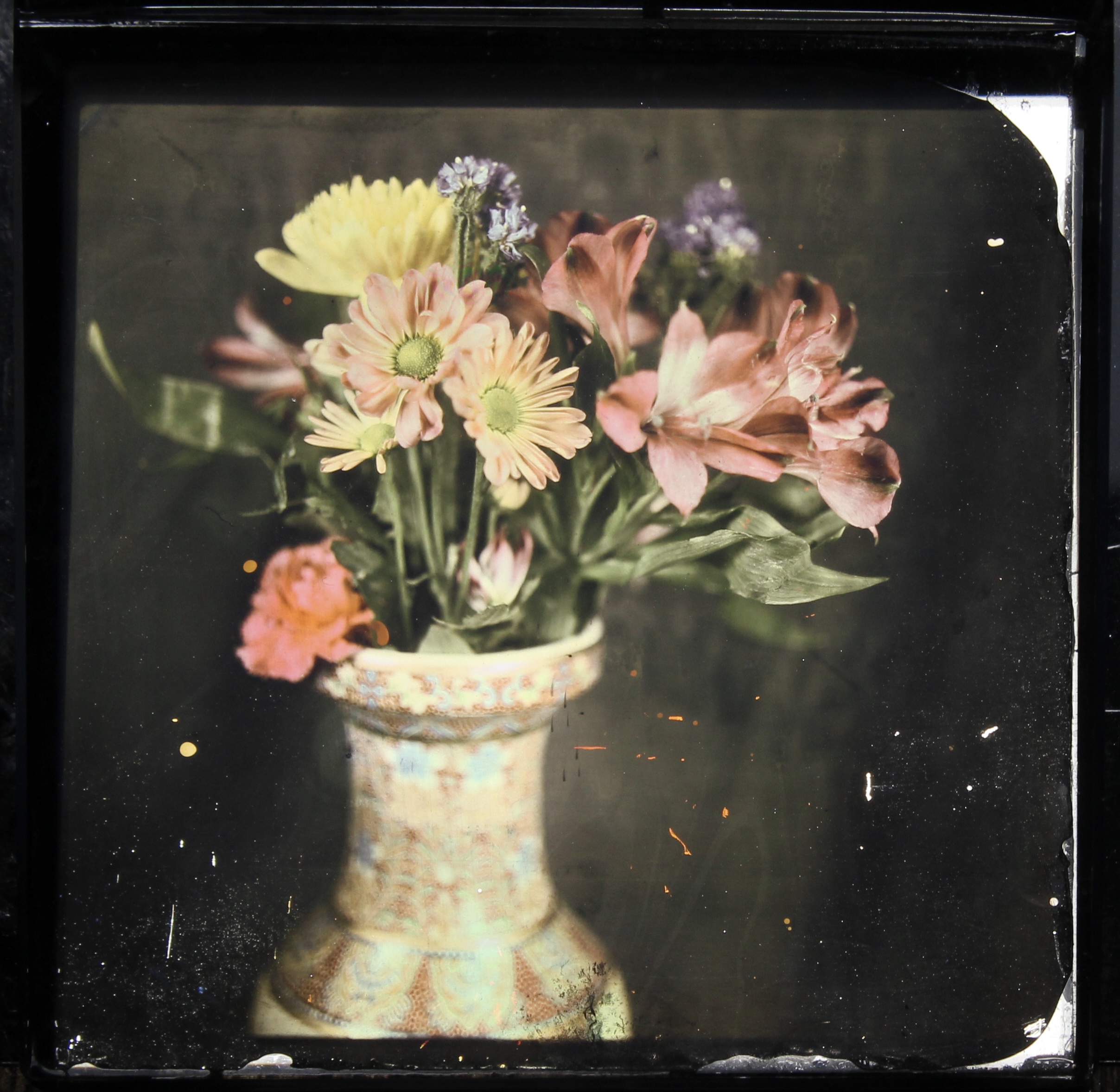

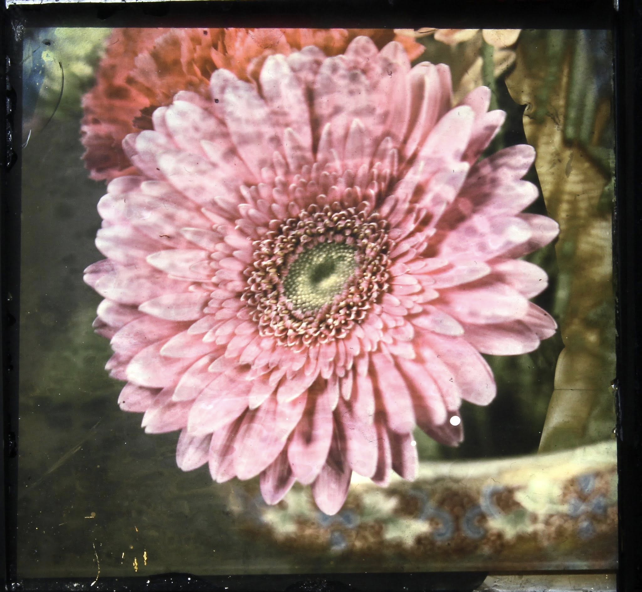

I struggled over the last couple of weeks and made countless batches of plates to replace the ones I was sharing earlier, but I kept falling short - I kept getting very yellow and unsaturated results, and I was struggling to figure out what I did wrong. I started working backwards, and ultimately determined that the hydroquinone I was adding to the emulsion to increase sensitivity seems to be to blame.
As far as I can tell, hq does work, as the first half of the plates I was sharing a couple posts ago did not need any hypering baths, but for now I am omitting it, as it was causing more issues than it was solving. I think it's worth revisiting soon, however.
I haven't quite replicated the results I shared previously, but I'm getting pretty darn close. These are bright and colorful, but still fairly contrasty, so they have a lower dynamic range and a reduced ability to render more subtle mixed colors. But it's a lot better than whatever I was getting before!
"1.5x X into Ag, No Gelatin" seemed to have best tradeoff between producing small grains and a fairly clear emulsion, while still creating polydisperse grain sizes that cut down on the contrast a bit. 'No Gelatin' here refers to the addition solution ("B") during precipitation - the gelatin remains in solution A. Omitting the gelatin here seems to produce more pure blues over variants more in line with Darran Green's original recipe, which have gelatin present in both solutions. "1.5x Ag into X, No Gelatin" produced by far the best dynamic range, but the plates were very cloudy, with tons of halation, causing very dim colors overall.

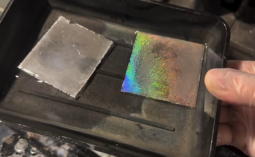

Mica & Processing
After the plates are dry, I cut them down to size with a "Beetle Bits" glass cutter, emulsion side up.
The plates I intend to shoot over the next day or two are hypered in a 0.05% solution of ascorbic acid (100mg in 200mL water) - 2 minutes with agitation.
The plates are left in the bath while the mica is applied 1 by 1. Pull a plate from the bath and blot it between some paper towels to remove most of the extra drops. Tip a small amount of mica powder (I'm using Mehron metallic mica powder) onto the plate and massage it around with a gloved finger for 30 seconds or so. Set vertical and repeat for the rest of the plates.
Once the plates have all the mica applied, use a very soft brush and gently remove all the excess mica. Set in a drying box for 1 hour with airflow.
Expose. This batch seems to take about 12 minutes @ f/2.8 in EV12 lighting.

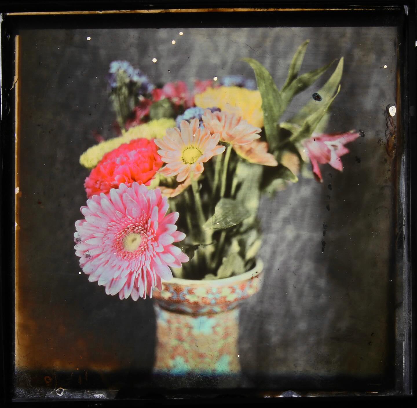

Here's a shot from last night, 1h10m exposure - I think the flower moved slightly. When I initally took these plates off the leveling table and set them to dry, the gelatin hadn't quite set up yet so some poured off - I think that's where that pattern came from.

Gorgeous, I particularly like its dynamic "movement".

I did do some levigation on a smaller scale with the "Let's Resin" brand mica - I mixed up a bottle of the stuff in a 500mL beaker full of alcohol, and then let it settle for 2 minutes before decanting the alcohol into a second beaker and letting it all fully settle out. It definitely worked, the mica was much more smooth than the raw stuff, and the reflection is a bit cleaner, but I don't think I noticed much of a difference in overall results. I'm using "Mehron" brand metallic mica now - the particle size is about on par with the levigated "Let's Resin" stuff, and it seems like it wipes off a lot easier pre-development. Maybe levigating the Mehron mica might produce even better results - I'll have to look into that.

Here are some early tests with MM-Collo-1. The results are quite interesting, and I will continue to play around with it. The colors are very pure - with GP-2 it seems like I'm always fighting some sort of "cast" or "tone" to the images, be it red, yellow, or blue, but here MM-Collo-1 seems to just develop the colors more or less the way I expect the plate to look. This is an excellent data point for me, as I wasn't exactly sure what the cause of the yellow tone was - whether it was something due to development, or the emulsion itself.
^GP-2
Same exposure. The first image was MM-Collo-1, 1:5, 10mins with agitation. Dim but pure. The second was 1:50, 30min, no agitation. Bright, but overexposed.
Overall they are a bit dimmer than GP-2, but I still need to dial in the exact exposure/dev parameters - I'm hoping I can get it fairly close. Contrast, if anything, appears to have increased with these plates - I imagine this is due to GP-2 producing a level of base fog that softens things a bit. The "negative" is indeed yellow-orange with these things.
It's able to render some very subtle coloration on the butterfly wings - particularly those blue spots. MM-Collo-1, 3:100, 30mins, no agitation.
I'm noticing some discoloration of the stock solution already - I'm guessing this does not have the best shelf-life.
Even if MM-Collo-1 doesn't pan out in the long run, I see it as an incredibly useful tool for determining the spectral response of the plates/color corrective filters.
I had a batch of plates a couple of weeks ago that had a nice dynamic range, but were overwhelmingly red/yellow. They have long since been wiped... I wish I had saved a couple to see how MM-Collo-1 would have performed with them!
