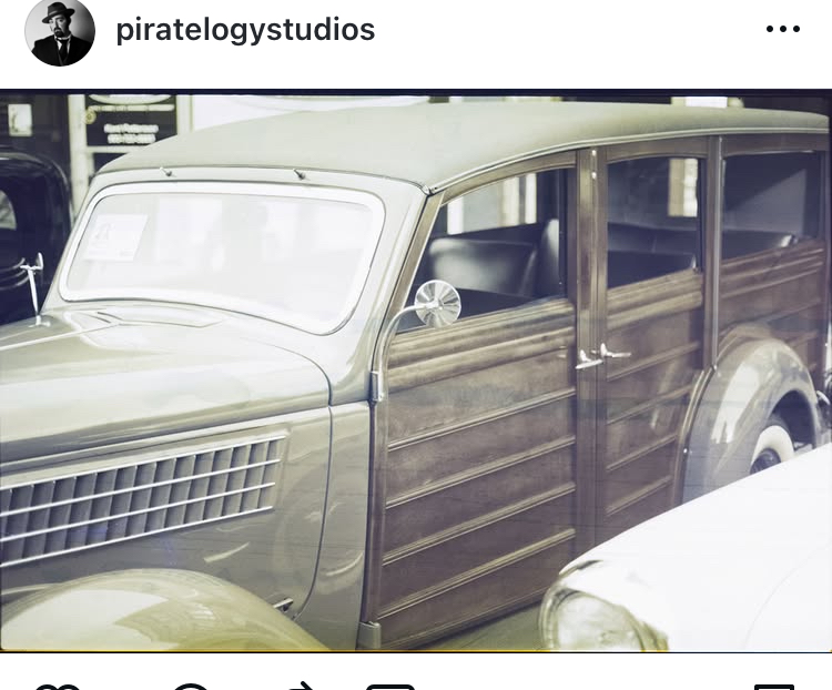

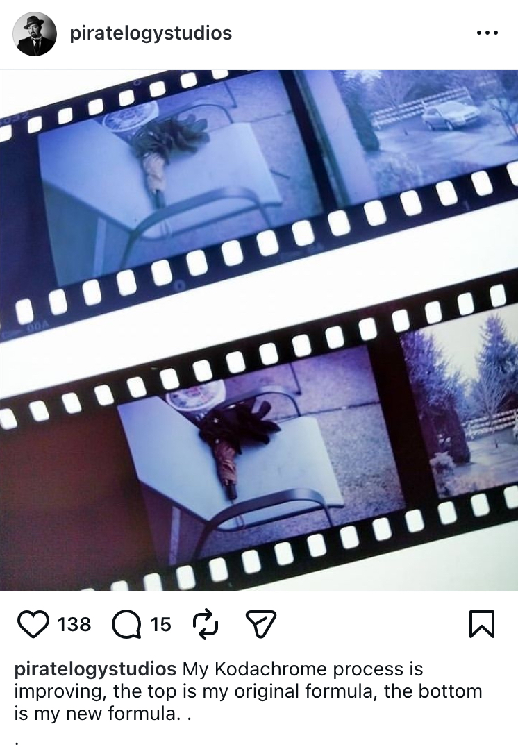

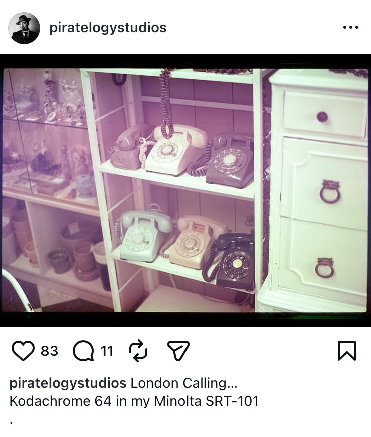

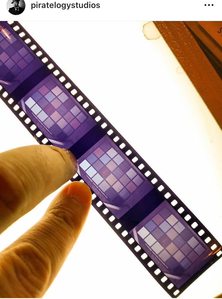

I actually found some results from a guy online (piratelogystudios), but there’s very little out there. Looking at his tests, it's pretty obvious he's having major issues with the First Developer (FD) and the overall color balance.
Based on the literature I've been reading, I'd guess there are two main reasons for this:
  • He hasn't figured out the precise timings for the optical flashing (re-exposure) steps.
  • The couplers he's using are partially washing out of the emulsion because their molecules are too "light" (lacking sufficient molecular ballast). But that's just an educated guess.
By the way, I found a really interesting detail in the patent. It states that each color developer actually contains an additional developing agent, like Phenidone or an Aminophenol. While it helps to further develop the layers, its main purpose is to essentially "pave the way" for the CD (Color Developer) molecule to reach the coupler more effectively (acting as an electron transfer agent).

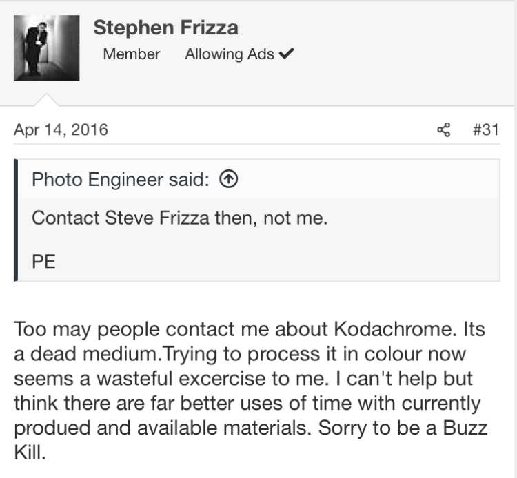

The guy on here from Australia who figured out how to do it was Stephen (Steven?) Frizza. He hasn't been on here or on his social media for ages, so I don't know what's going on with him. He ran a commercial photo lab in Sydney for a while and so had the tools and facilities to try and do it. He was also independently wealthy.
He was using mostly original kodachrome chemistry (which came in tins mind you right to the very end) with an improvised yellow using the older 1930's patents.
The issue today is expense, you can have chemical companies manufacture the colour couplers but be prepared to spend thousands of dollars in any currency. nobody else needs them so you're asking a big company to make a small amount of an otherwise useless chemical times three!
This is why Adrian takes a far more artistic route, using all sorts of novel materials as couplers to form rather amazing images. Kodachrome is a great medium for this, as you can add any coupler you like within reason. the combination of different couplers and colour developers is damn near endless when you're in that deep.

I honestly think that Mr. Frizza achieved his goal of processing Kodachrome and moved on. Having proved the point to himself and the photography community, he simply walked away from it. And the reason he doesn't publish his methods and research is because he doesn't want hundreds of people asking him about it.
