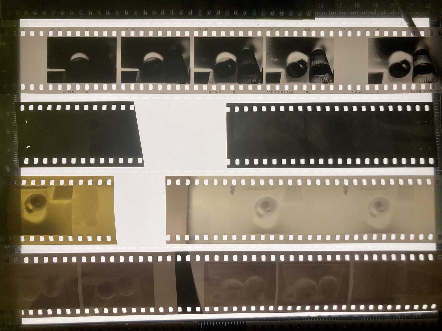

Yes I have developed Kodachrome in B&W successfully.

Yes, I’ve actually had success with that already! I managed to remove the yellow mask and even reverse-processed it into a B&W slide.
As for the trichrome technique, that's an interesting idea, but I think it makes more sense to just shoot trichromes on something like T-Max 100, for example.
