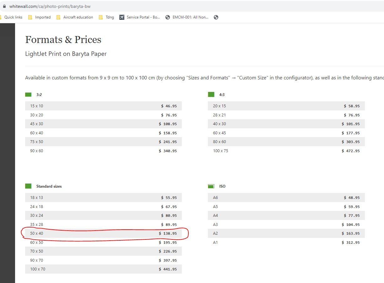

How much? What about a laser print of it.
Here is a price list for a C-type print, from a digital file. Maybe you can scan the negative first.
Here's for black and white on Ilford paper.
Need to mention that dimensions in this pricelist, for laser printing on Ilford paper, are in CM not IN. So a 16x20" print is about $140 and 8x10" about $60. I will stick to my own printing, and maybe make an enlarger from my 8x10 camera.
