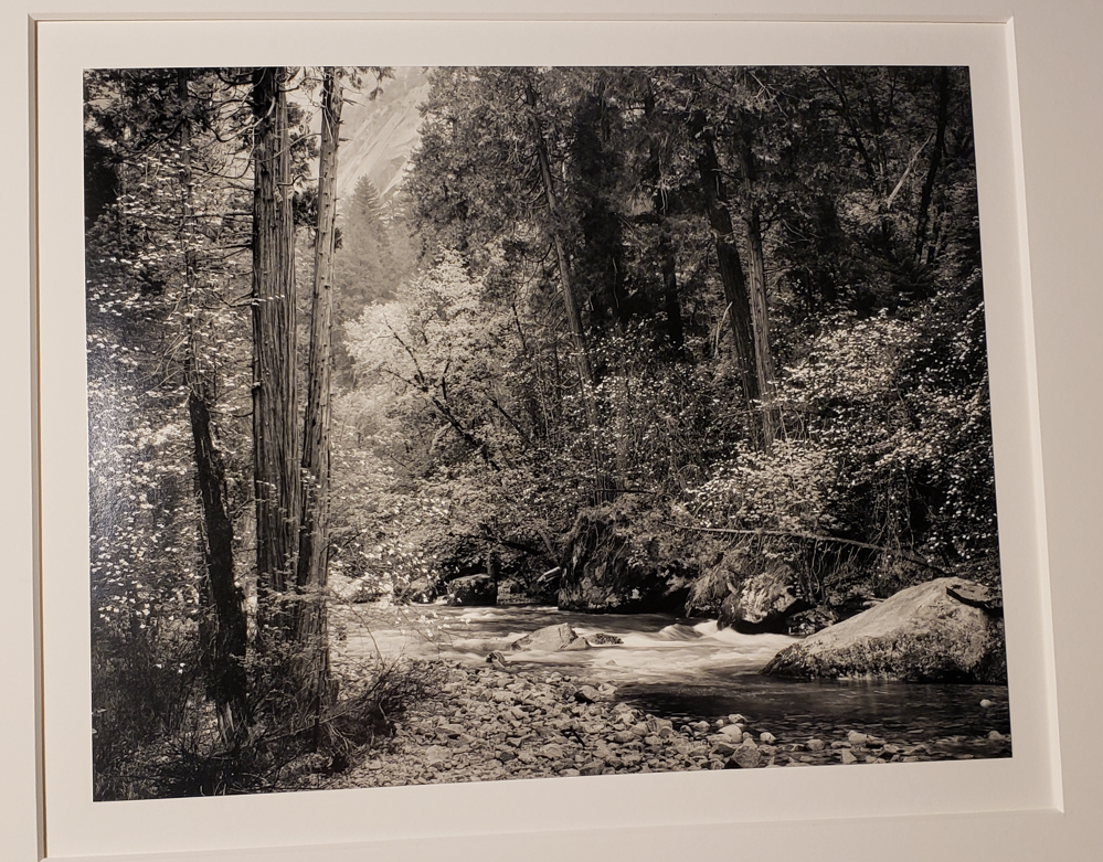

So I got my print today, gotta say I'm satisfied. Feels like a contact print. Would be better if the blacks were darker. Overall very sharp throughout. I will send some closeup pics in the morning.

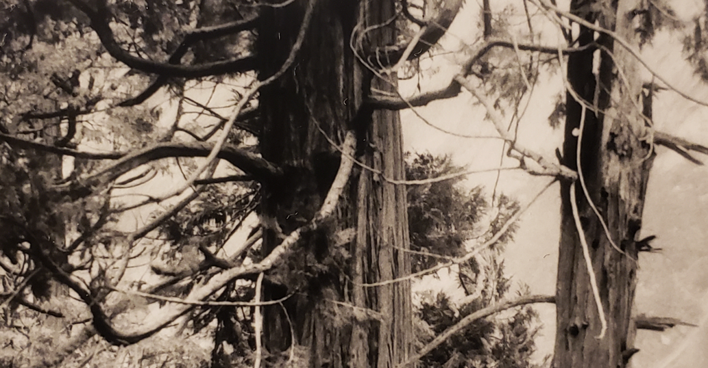

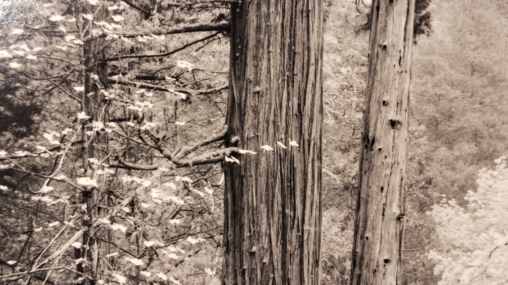

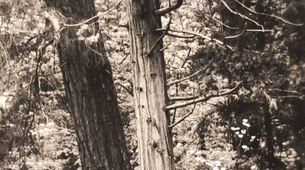

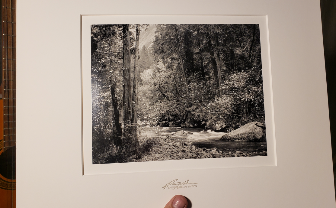

so the print is worth the buy for me, I keep looking into it, detail is quite good. The photos are with my phone up close, its a bit better in life.
Cannot tell if this is FB or RC paper as it's mounted. But it does feel thick.

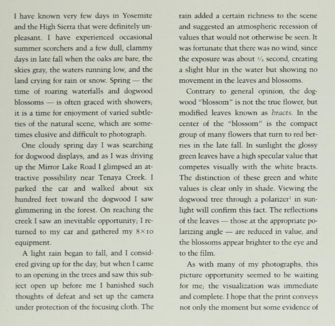

I guess AA really had to stop the lens down to get everything into focus, maybe f/64. I tried 8x10 on subjects this close at f/8 and only some of the scene goes into fine focus, the rest is a blur. Although the site says the exposure for this shot was 1/2 sec, so maybe not f/64.
Anyone knows at what f-number the diffraction limit begins to take over the depth of field in terms of sharpness on a contact print, for 8x10 negative? For this type of scene.

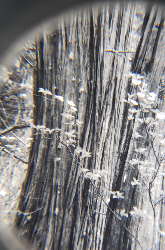

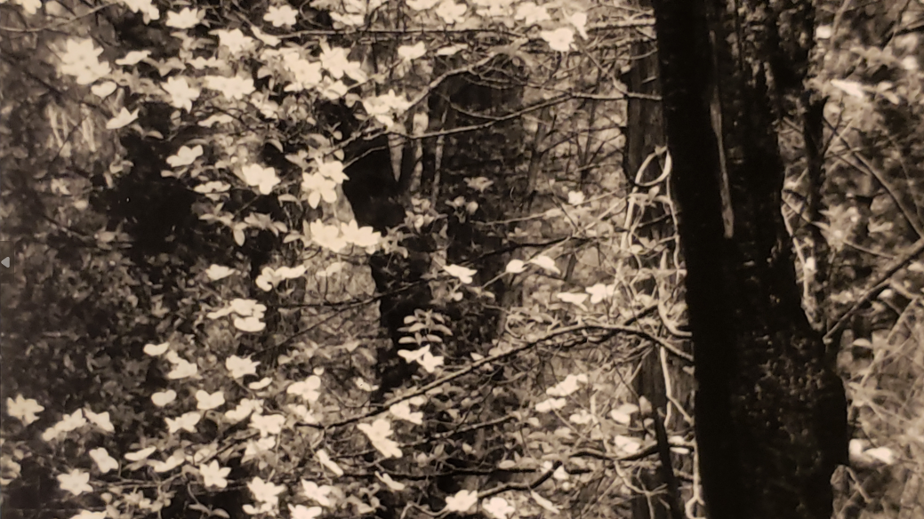

Three trunk through a magnifier. Sharpness is good, cannot complain about it. You can see the grain, which I think is the original negative grain, not the print paper grain.

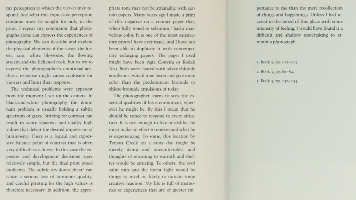

AA book, examples of 40 photographs, does not say much about f-number of type of film, etc.
View attachment 350519 View attachment 350520
His books and others rarely talk about f/stops and shutter speeds because paper, chemical and equipment are constantly evolving. Putting such details are extraneous, would be quickly out dated and would never apply to a particular darkroom.

I mainly bought this print to use as a standard to compare my prints. Inspiration for composition and sharpness of print. The only thing is it doesn't seem black enough, it has a slight bluish tint, maybe it was selenium toned.
