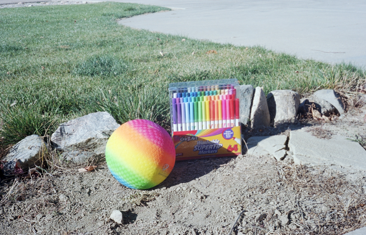

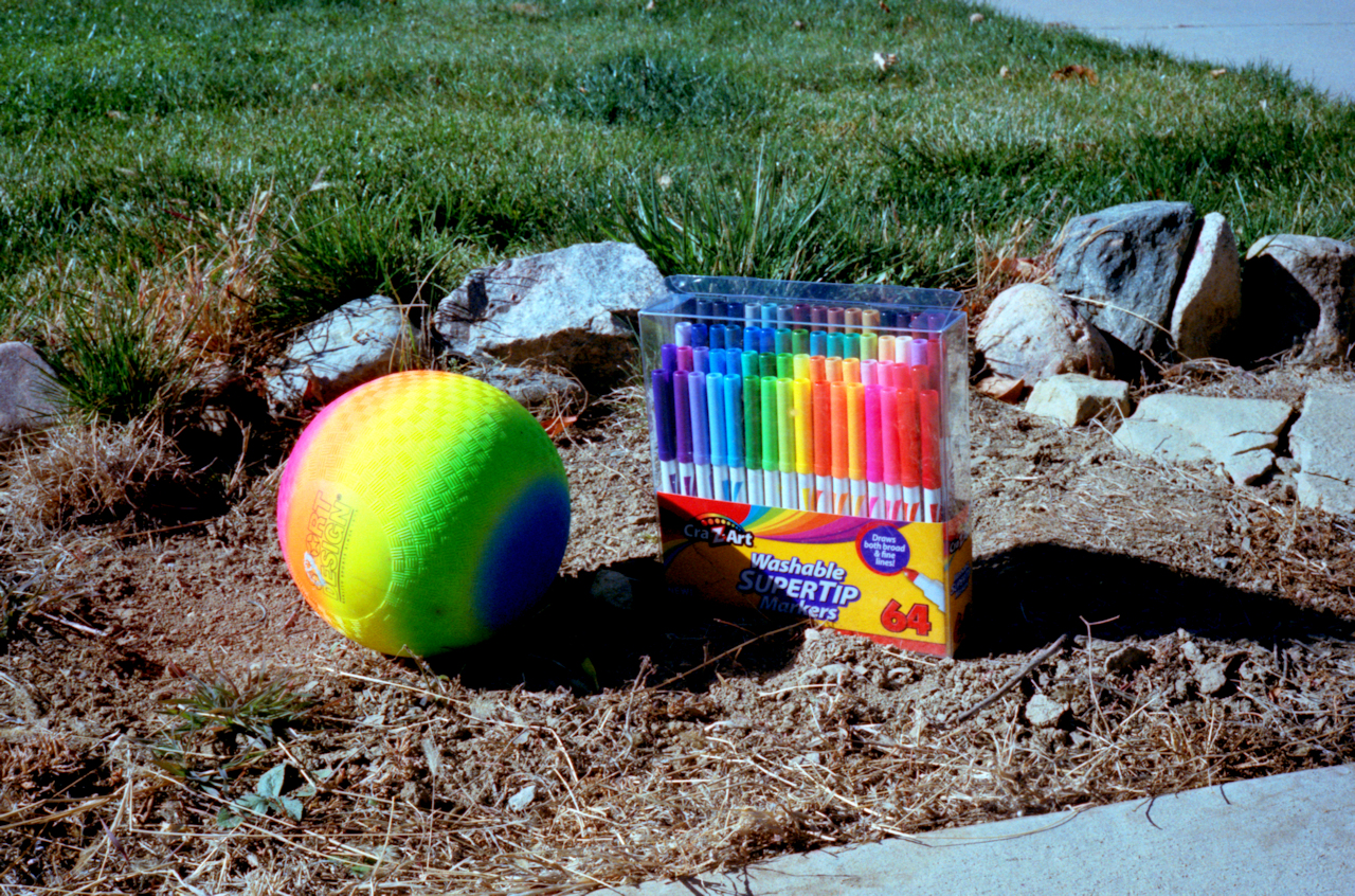

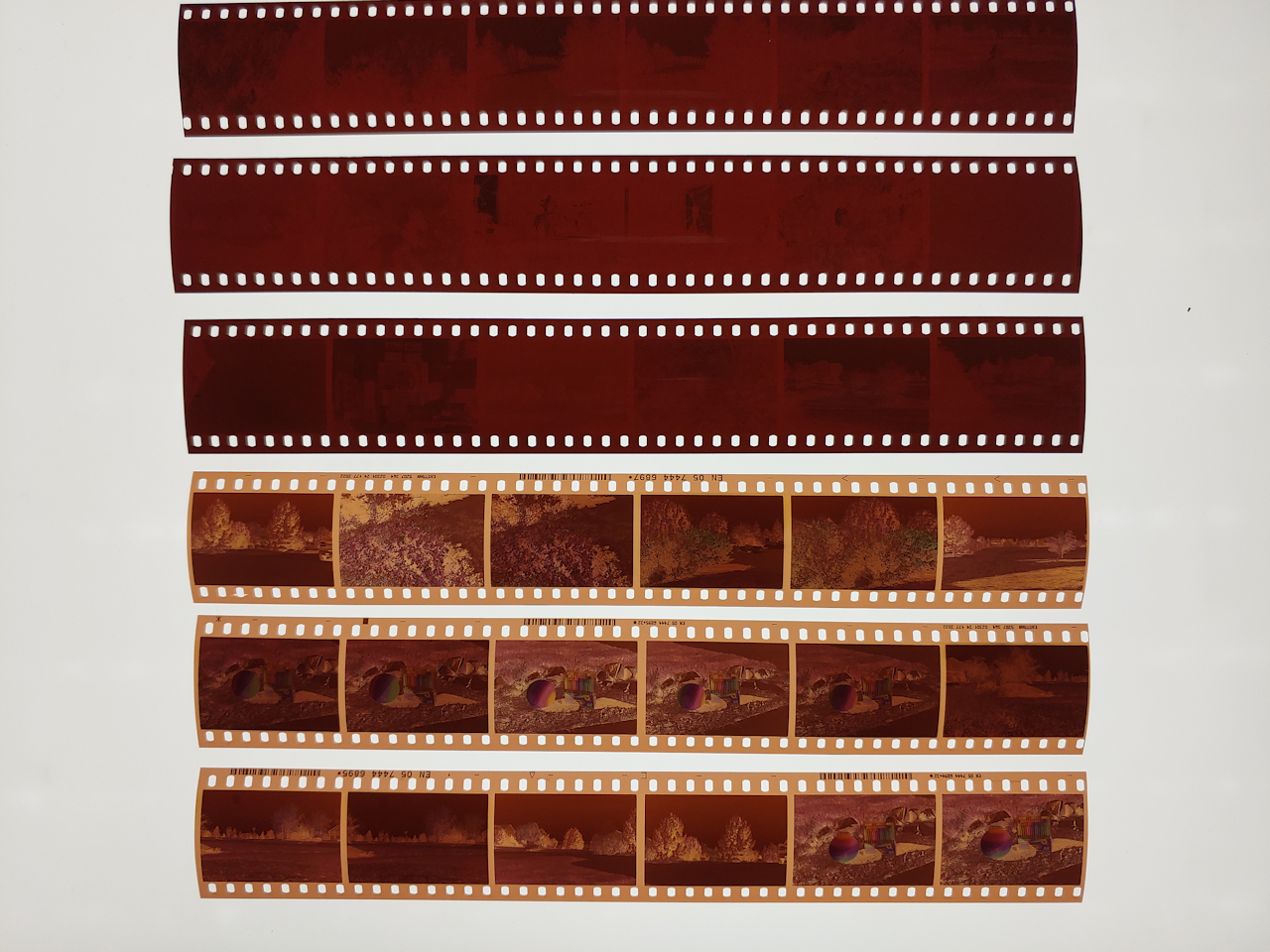

I shot two rolls of film. First one I processed by removing the remjet first. Results were consistent with what I got early on, muddy looking negatives, really grainy and poor images with streaks and splotches. If you need to reuse the chemistry, I think something milder like the baking soda or soda ash for a little more kick. Seems you will still get remjet in your chemicals.
I used the same camera set to auto, both rolls were about 30 minutes apart. Each got process in a fresh mixed batch of chemistry. Only difference was DWC first for one and last for the other.
Attached are what I got, what's what should be apparent.
View attachment 320304 View attachment 320305 View attachment 320306
Yikes.
Looks like I'll be sticking to baking soda. I've found the Borax or washing soda gives a grainier look. I don't really get remjet in my chemistry using baking soda. Most of it clears off on the pre bath and whatever is left gets scrubbed off after the rinse before the stab. Whatever ends up in the chemistry doesn't seem to affect the future rolls.

I would say the DWC super-activates the developer (or something like that). Looks way over developed to me. Or it really amps up the orange base. I've been using Kodak's formula with Lye, and then several washes before the dev. Still needs a mild cleaning at the end.

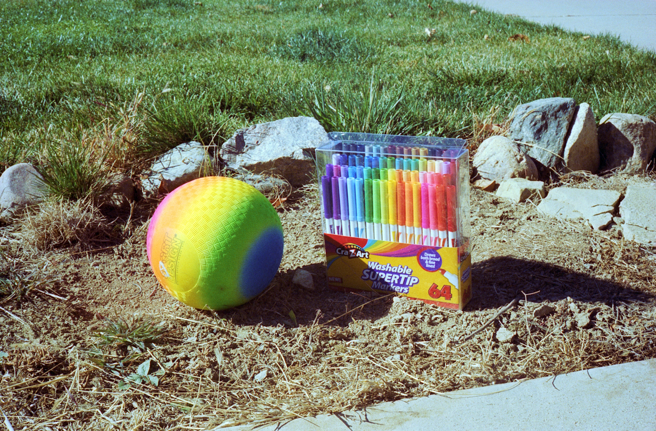

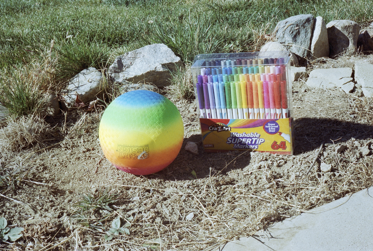

When I relooked at the image with the ball in the markers, it struck me as being pretty dull. I rescanned it and also scanned a slightly different image from the same roll using Silverfast and Vuescan. For Silverfast I use a filter I made for the Vision 3 film. In Vuescan I used the built-in Vericolor III Pro filter. I kind of like the Viewscan version better ( VS in the file name ) though I think it is over saturated. In any case, all three of these are better than the one I posted above, not sure what I missed.
I also added an image shot with Ektar just for comparison.
The Ektar shot looks of remarkably low saturation and appears to have a cyan cast. It looks wildly different from how my Ektar looks if I print it on Crystal Archive. It's a matter of taste, of course, but as a comparison, it may throw people off a bit because it's not really representative for what the film does in reality.

Here's the Ektar shot with a little more saturation. Looks better.

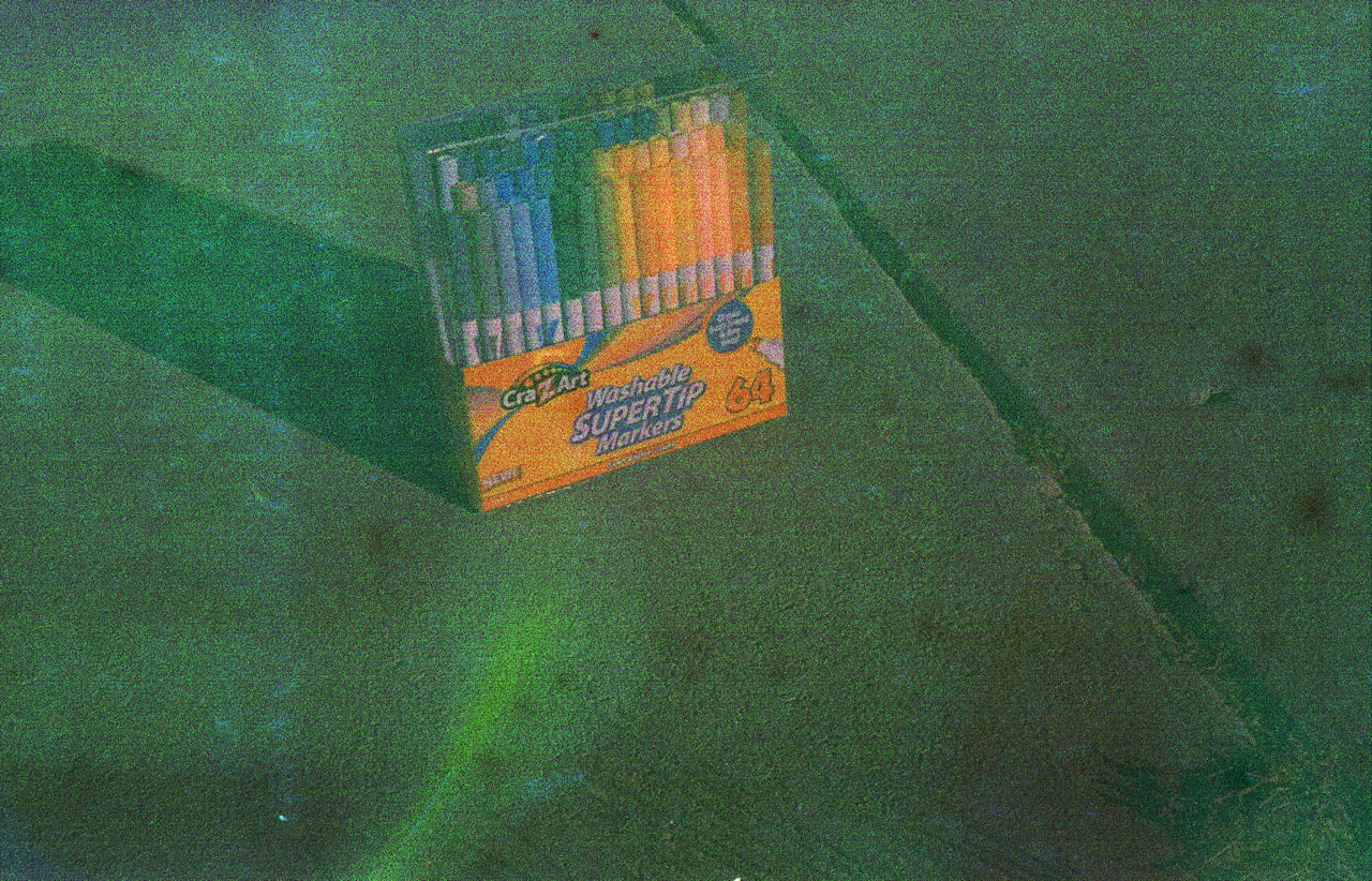

I went out and took the same pic with my 5D4, now the cyan cast is very apparent and I have something I can look at side by side.
