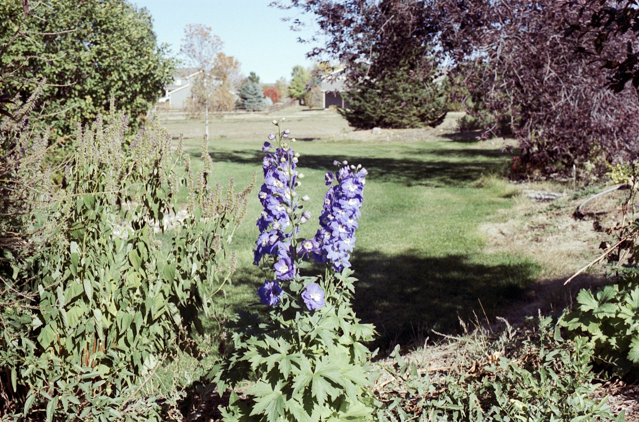

Today I tried some Bellini C41 chemicals. This is the first time I have seen C41 with only one part for the developer. I do like the separate bleach and fix.
My first inclination is to say I think the color is better. Still using driveway cleaner and never have to manually remove remjet from the film.

Here are my results
Kodak Vision 3 250D @ 200, Yashica FX-2 Zykkor 28 2.8, C-41 Powder Blix kit, Zep Driveway Cleaner after Blix.
Colors are nice, but I see streaking. Not sure if it's remjet leftovers or the film is scratched but I'm leaning strongly into leftover Remjet
Most definitely remjet on bottom of this one, bottom center right
I don't see any on this one
Bottom center of this one some left in Remjet.
In conclusion, colors are nice. There's what to keep testing with this. It's not any more effective than baking soda for removal but it might keep the colors from getting wonky. Lots of bubbles to deal with. Also, temp of solution might need to be a bit higher and it might take a few shakes and rinses with more of the DWC. With the baking soda after the shake the water would come off black. I didn't see that with this.

Follow up.
Here's a shot on 250D from last year. Chemistry was fresher and it was not as well used. Say roll #30 instead of #45 for the DWC roll.
Elan II, 250D, Baking Soda before Dev and everything else as per powdered C-41 blix kit instructions.
DWC looks better to me color wise.
