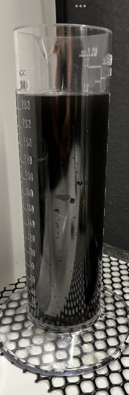

Just did it.
I can not see if the ramjet was stuck to the emulsion yet. Seams clean for now.
But yes my flexicolor Dev got black.
And the slime on my reels is impossible to fix.

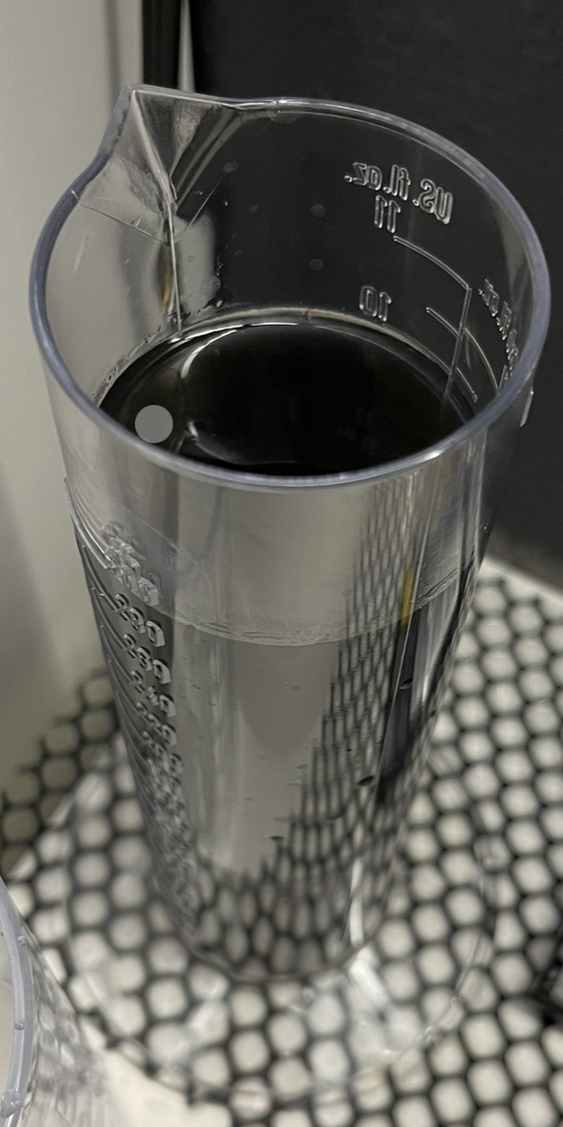

My Dev

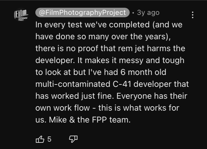

This is their response:
I also don't think the remjet contamination affects developer activity. The main disadvantage is that some of the remjet stuff will make its way into the emulsion, and this will be more so the case if an already contaminated developer is reused. But I find that mechanical cleaning of also the emulsion side is necessary to completely remove all remains of remjet.
