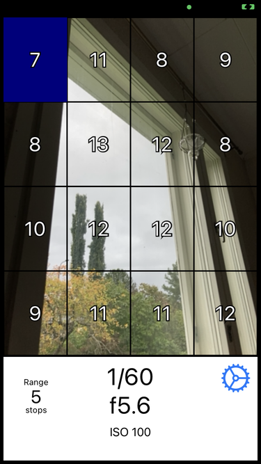

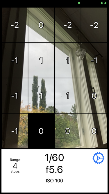

Resurrecting this project ..
I was doing a band shoot with direct positive paper and it was a bit tedious to measure the dynamic range of the scene I was shooting. So I decided to continue working on this app.

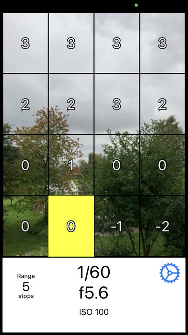

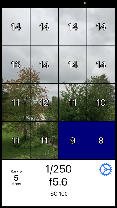

Basics are the same but now it shows EV(100) or difference (to locked yellow block) in stops. So it is easy to see what is the difference in stops to certain area on the photo. The one example photo here has black block as reference (captured previously with different color as indicator)
I've also added light meter, I tested this against Sekonic spot meter and it seems to measure correctly!
Some screenshots so you get the idea:
The blue blocks are indicating "underexpose" (configurable over/underexposure indicator).
When block is selected and difference is showing, the light measurement is done from that block. So basically kinda spot meter functionality. Except on this app you can define the area size where the measurement is done.
