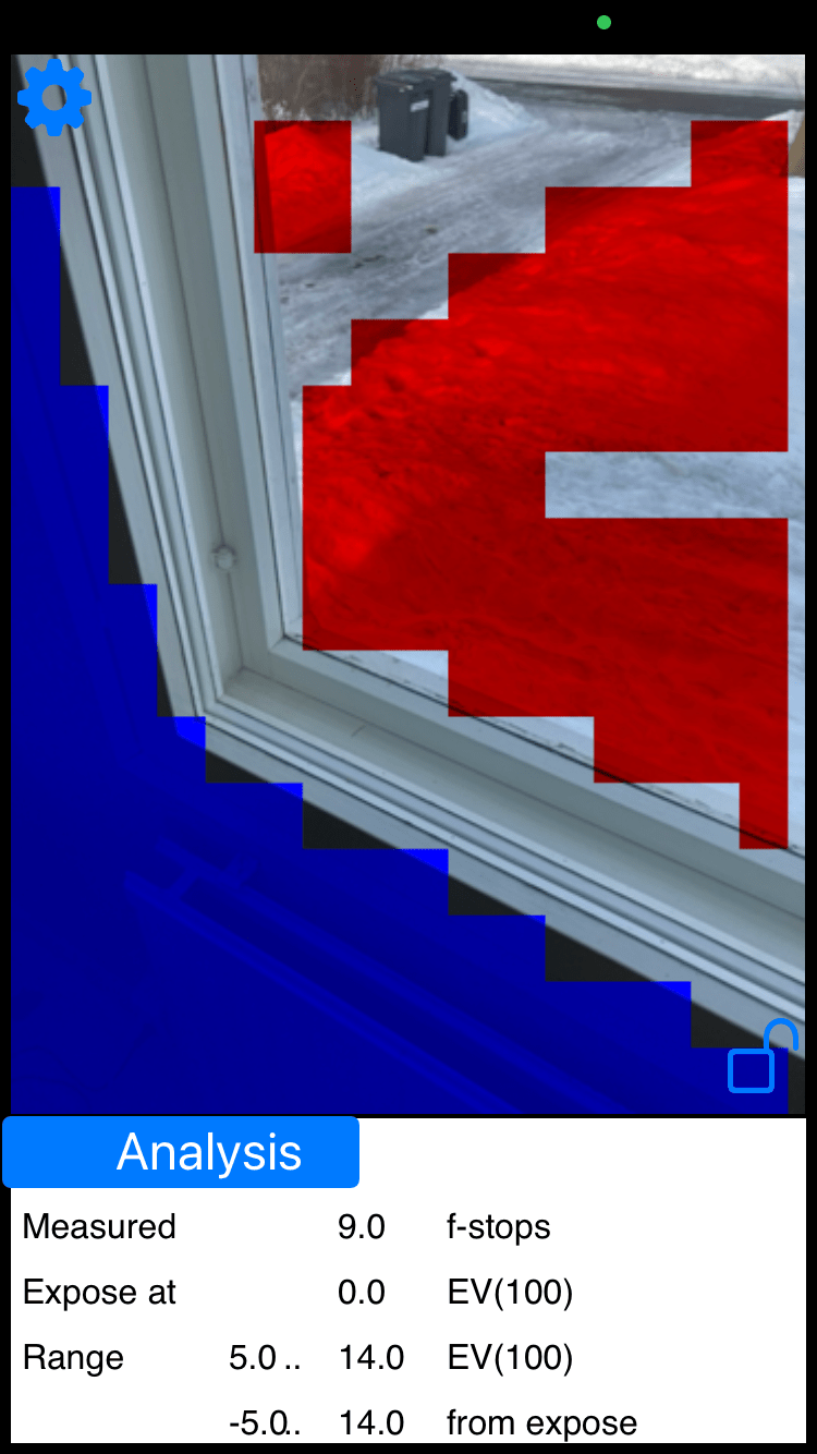

I implemented new color coding; only groups that are over/under the configurable limit are shown. This method is really promising, quickly tried in indoor lightning and it brings attention to dark/bright areas for sure! How does it work in higher dynamic scenes, we will see tomorrow. Thankfully there are many clear sky+sunny+snow days ahead, good for testing (and not so good for photography).

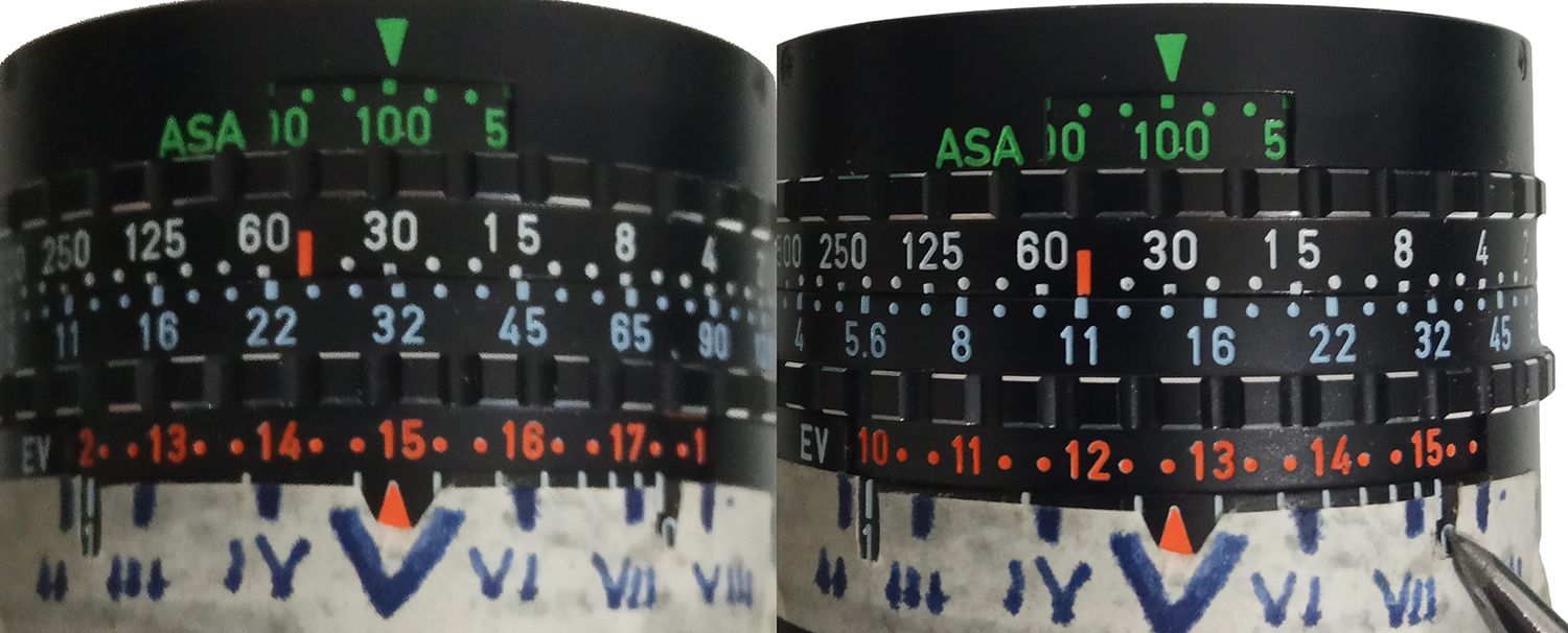

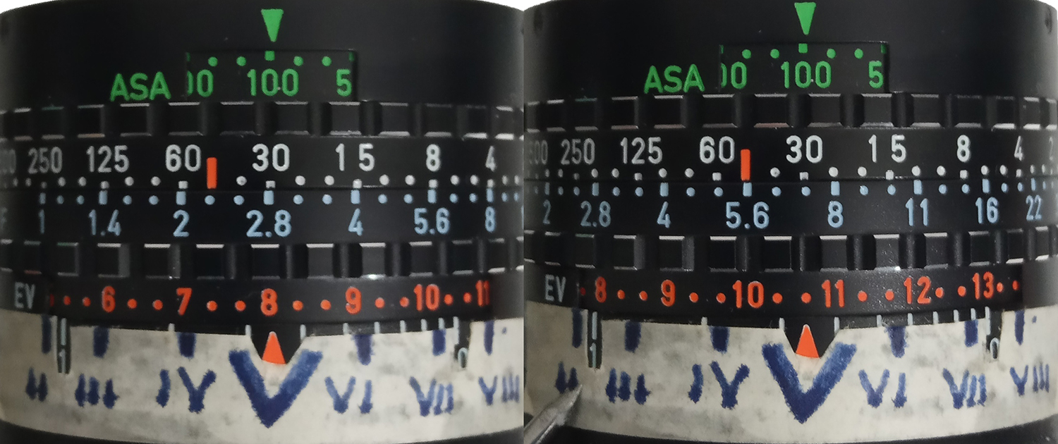

I've attached some very quick phone pics of how highlight and shadow keying works using the IRE scale - they're very cropped phone pictures done under bad lighting, so apologies for the focus being questionable (I also rapidly realised that you need three hands to demonstrate it properly and take the picture...), but they show the important details... Bear in mind too that the meter I used for these pictures acquired a homemade (and very well stuck down) zone sticker at some point in its past, which I've cut away to expose the IRE 10 ('1') and 100 ('10') engravings. 'Highlight indexed' shows how you would index a detailed highlight that has an EV of 15 to IRE 100 (where the scriber point is) - this is what you'd do for a narrow latitude material. 'Shadow indexed' shows how you would index a detailed shadow reading of EV 8 to IRE 10 (where the scriber point is) - this is the one that matters for negative (especially BW negative) exposure. If these images are useful to people, I'll redo them properly with a tripod & studio lighting.
Thanks for the photos, which are great. I just don't know how that thing is used and how to transform that to an app? Choices are:

Just an update of the UI to others as well. Here you can see over/under exposure visualization, I've set the limit to 1 for demonstration in this case.
Now I implemented exposure lock, the app starts to take its wings. This might have some potential, really.

In this first beta there might be some hickups in the start, tap on the "settings" icon (wheel) and go back and everything should be running smoothly then.. I hope.
There is a bug which shows everything in red at first, thanks @relistan for reporting.
Use the lock icon once (lock&unlock) and it should start working. I try to hunt the bug.
I'm using ios13.7 on my iPhone 8 plus and there is no blue setting wheel on the upper left of my screen. What is the green dot on top?
I'm working on that missing wheel, I try to uploaded new build currently.
The green dot is probably the iPhones "camera on" light on status bar.
