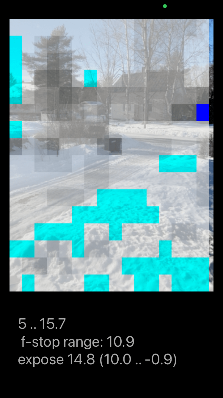

I implemented a concept app which purpose is to easily get understanding of scene subective brightness range (SBR). It works as any other mobile light meter except it analyses the scene in blocks. Idea is that it can measure parts of the scene like using 100 spot meter readings at the same time.

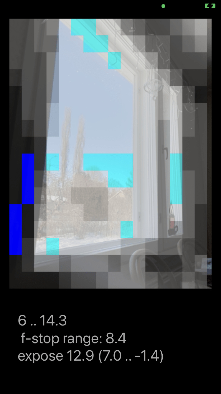

Here are some screenshots of the prototype. First line shows EV(100) min-max range.
Next line (f-stop range) is just the difference of max-min. This is the beef of the project.
"expose" - row is the suggested exposure (in EV(100)) calculated in traditional mobile light meter app style. The values in parenthis are just differences to the first row values).
The block color coding is following: cyan = highest EV, blue=lowest EV, grayscale coding = black is low EV and whiteish = high EV.
I would like to hear your thoughts of this idea; worth of developing further or ready to go down to the trash?
Also please go ahead and write down ideas if you have any; I can try them out on this prototype.
The app is implemented on iOS so it is currently iPhone only app. If you are interested testing this idea please send your email to me and I can attach you to TestFlight program which allows distributing app before releasing.
My own analysis of the samples:
View to the street: f-stop range 10.9 is probably correct. Typical scene where you cannot get shadow & highlight details on same frame in normal exposure & development.
Window view: range 8.4 stops; probably right too. One can squeeze some details from inside without pushing details outside to the shoulder?

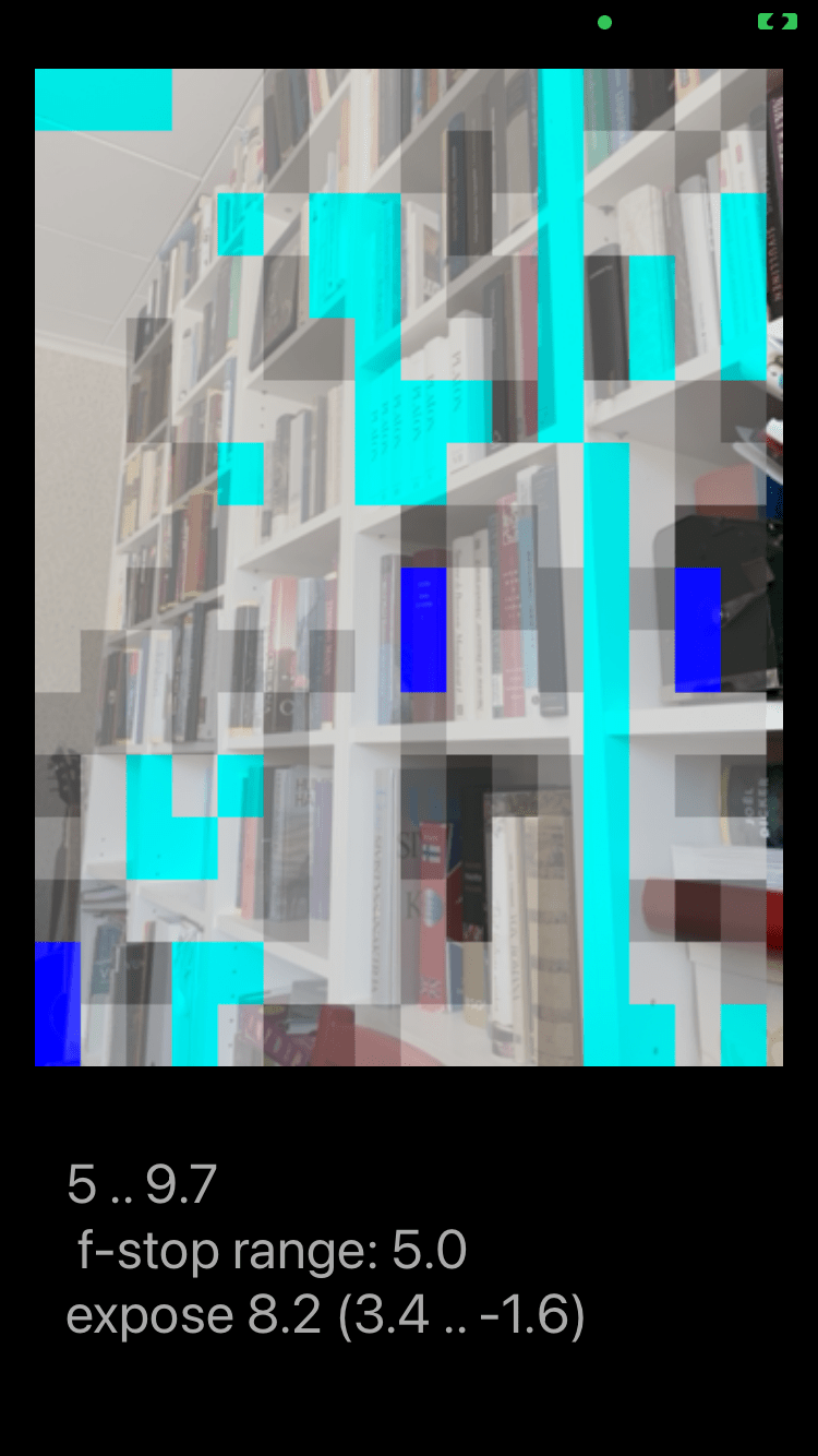

Shelf view: range 5 stops; easy peasy to capture. Typical indoor scene SBR?

11 stops in the first picture seems far too much. The others look right to me but that first one seems very high.
Def keep going with it tho - this is a very good project.
I hope tomorrow is similar bright day, I can then check with my spot meter how these app value compare.
The day was really bright today when I took that capture. Really clear sky and some areas in good shadow (dark trees) and all calculations are done with same algoritm. So that might be or might not be correct.. We will see benchmark this idea for sure!

could specular highlights in snow be tricking the meter? (that's a random totally unsubstantiated guess)
how many stops does an iphone camera sensor have? We see a top notch 35mm digital sensor top out around 14 stops but what is the range on a phone? Random uneducated guess is 10.9 stops is the max range of the phone sensor without HDR activated and something is tricking the app. That could be complete garbage tho
Ah yes. Probably limitations hitting the wall. At that SBR level the app is probably already quite useless. There isn't any trickery on that part since the light calcualtion is done from single exposure. It might be possible to make multiple exposures and then get larger range..
