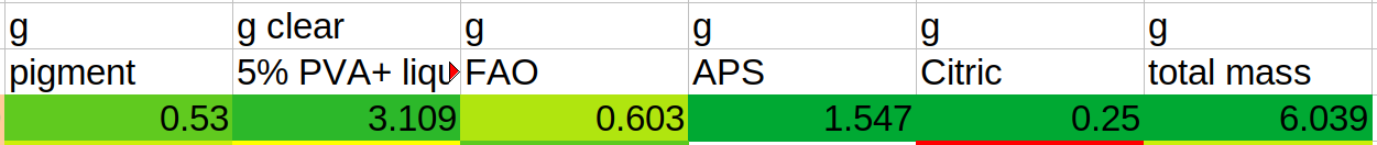

I'm going to try this ammonium persulfate recipe too: https://www.alternativeprocesses.org/post/the-chiba-system-a-safer-way-to-print-with-gum:
hmm, so this is the combination I used for that persulfate experiment:
It made a messy looking coating that was very unevenly coating. I exposed it but there was no image made at all after sprayed with dilute peroxide, it just did not dissolve but I brushed it off. I left the paint brush in it and forgot about it for a few days. Now I come back to a beaker that has a coating on the interior surfaces and a puddle of yellow chemical over it. I proceeded to wash my paint brush thinking it would just dissolve and nope.
It feels like rubber with a leathery texture. the yellow stuff was probably just FAO, APS, Citric just remaining there. anyway, this is relatively interesting because maybe there is something to be had from it. APS is supposed to have a slow dark reaction. maybe I just needed less of it. Maybe I don't need peroxide for this. I should give it a second try. if anything this could be a good sizing material maybe.

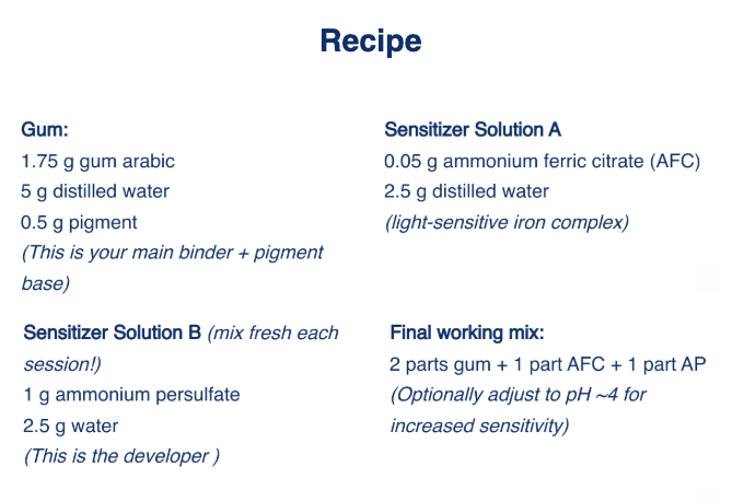

I got to try that gum and APS (Ammonium Persulfate) mix. Its as good as the PVA mix actually. I translated the recipe in percentages because that recipe requires you to make more than I wanted to try:
per: https://www.alternativeprocesses.org/post/the-chiba-system-a-safer-way-to-print-with-gum
I sprayed it with hydrogen peroxide, but accordingly the APS in the mix is actually hardening the gum as it is exposed to UV. I was reluctant because that gum material and FAC does not inspire confidence because of past failures. With gum I always had the issue of it just dissolving away, but I can assure you that this mix does not dissolve away where exposed. I did not pre-coat/size my paper and the mix did not stain. I used yellow Vangog 254, PY184 lemon yellow. The mix was really watery and I thought for sure it would be a total loss like all the previous ones and I was pleasantly surprised.

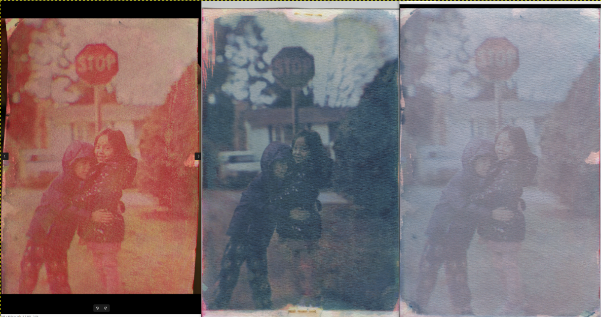

I noticed that this APS Gum Chiba formula seems to have more tonal range, maybe one or two more steps on the Stoufer 21 step wage than the PVA formula. Even though the water percentage is high, at the end of the day its the pigment per unit area that counts. Anyway, I made a tricolor, same image as I've been using before. Here you see on the left a very saturated PVA Chiba print using florescent mica. In the middle is my new APS Gum Chiba print and on the right is the PVA Chiba but with water colors at low pigment. A thing that I noticed about APS Gum Chiba; Indeed it appears to harden the image during the exposure, I did use hydrogen peroxide spray during development but I probably don't need to. I will try that soon. The reason why I am sure is that if you hold the tissue at an angle to the light you can see the exposure. Meaning that the UV light has done something to make the exposed areas shiny while the unexposed areas remain matte looking. I noticed that it is maybe two or three times faster than the the last PVA formula I posted. Finally, the image is much harder to wash away. for the center image I used the APS formula for yellow and magenta. During the yellow develpment I did notice that it had a lot of detail and too much pigment when dried. For the blue I used the CMC+PVA+NewCyanotype mix. I noticed that there was still some FAC in the first two layers because the Cyanotype layer began developing on its own without exposure. I waited patiently for it to dry and then exposed it for under a minute. I just need to use less of the NewCyanotype in the mix to make it a lighter tone. Overall this formula with APS seems to be really easy to work with:
You can see the background has more detail on the truck and the house with the brick chimney, the roof and windows. The blue, as it was self developing was actually very interesting to watch.The rain coat has cleared the paper white for the little white hearts and the spiderman pants have more detail. The green has darkened a lot because all layers had too much pigment. On the top right on the APS print you can see some ripply clouds that the other two prints missed almost completely.

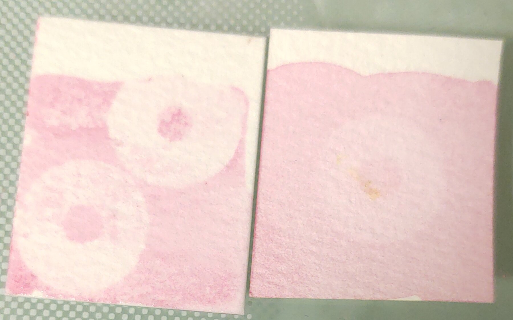

oh, interesting. It appears that the same effect of the ammonium persulfate in the emulsion is possible with PVA. It definitely needs to be a different recipe because the effect I saw was not well balanced. The PVA percentage probably needs to be very small or at least much smaller than 14%gum in the gum recipe. I did a simple 0-1 exposure using a washer on a small coupon. This resulted in an image that I had to clear aggressively by putting the image right under the faucet. I might do more on this. I like how rugged the images are. but then also gum Arabic is cheaper than PVA? not 100% sure on this because the PVA would be used at a smaller quantity. PVA is clear and UV transparent, GA is neither, its yellowish and blocks UV quickly.
I know these are not great looking examples but...I made this APS PVA Chiba emulsion last night. The less contrasty used 5% pva in place of dry Gum and I developed it last night. The more contrasty was 5% pva and 2% CMC and I developed it this morning. That second one took 5 minutes to show any signs of having a salvageable image in it. They are very robust compared to other gum emulsions where the gum washes away if it stays too long in the water.
Well it looks like the APS Chiba can polymerize in less than a minute if you adjust the recipe for that. Also you don't need hydrogen peroxide at all. Just expose and then dunk in water. it can be cold water or warm water. I over exposed something and then over developed it and some details returned, so it seems to keep some of the information. hydrogen peroxide helps clear the image. so you can use it for that.
