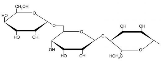

This is CMC:
Note all the OH groups
Here is Iota Carragenan:
more OH groups

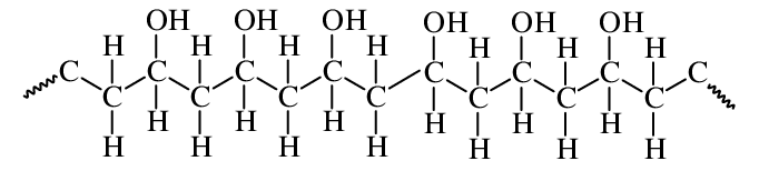

PVA:
Gum arabic:

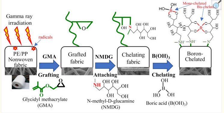

The OH hydroxilic groups are where the carbon chain join during the process. I went to ask our evil friend RAM brains about it. Here is my summary:
UV exposure in PVA/FAC (ferric ammonium citrate) or FAO (ferric ammonium oxalate) emulsions triggers photoreduction of Fe³⁺ to Fe²⁺, initiating crosslinking with the polymer's OH groups. This mimics gum bichromate but uses iron instead of chromium, hardening the emulsion selectively in exposed areas for photographic prints.
UV light excites the ferric complex ([Fe³⁺-citrate] or [Fe³⁺-oxalate]), reducing it to ferrous Fe²⁺ and releasing CO₂ or other byproducts from ligand decarboxylation. The Fe²⁺ then coordinates with adjacent OH groups on PVA chains (or residual OH in the emulsion), forming Fe²⁺ bridges that link polymer strands via oxidative coupling.
Unexposed Fe³⁺ remains soluble and washes away, while exposed areas are initially lightly crosslinked by Fe²⁺. Adding H₂O₂ reoxidizes Fe²⁺ back to Fe³⁺ (Fe²⁺ + H₂O₂ → Fe³⁺ + OH⁻ + H₂O), tightening the bridges and insolubilizing the PVA matrix permanently. H₂O₂ provides O₂ for oxidation without carbon involvement, unlike the initial UV step.
Supposedly the citric acid helps absorb UV and buffers the PH when ferric is going back to ferrous. Similarly boric bonds are a little stronger so while things are pulled by the ions it pulls polymers together closer than iron so it produces tighter matrices after the peroxide does its thing. No idea if that's true or not.

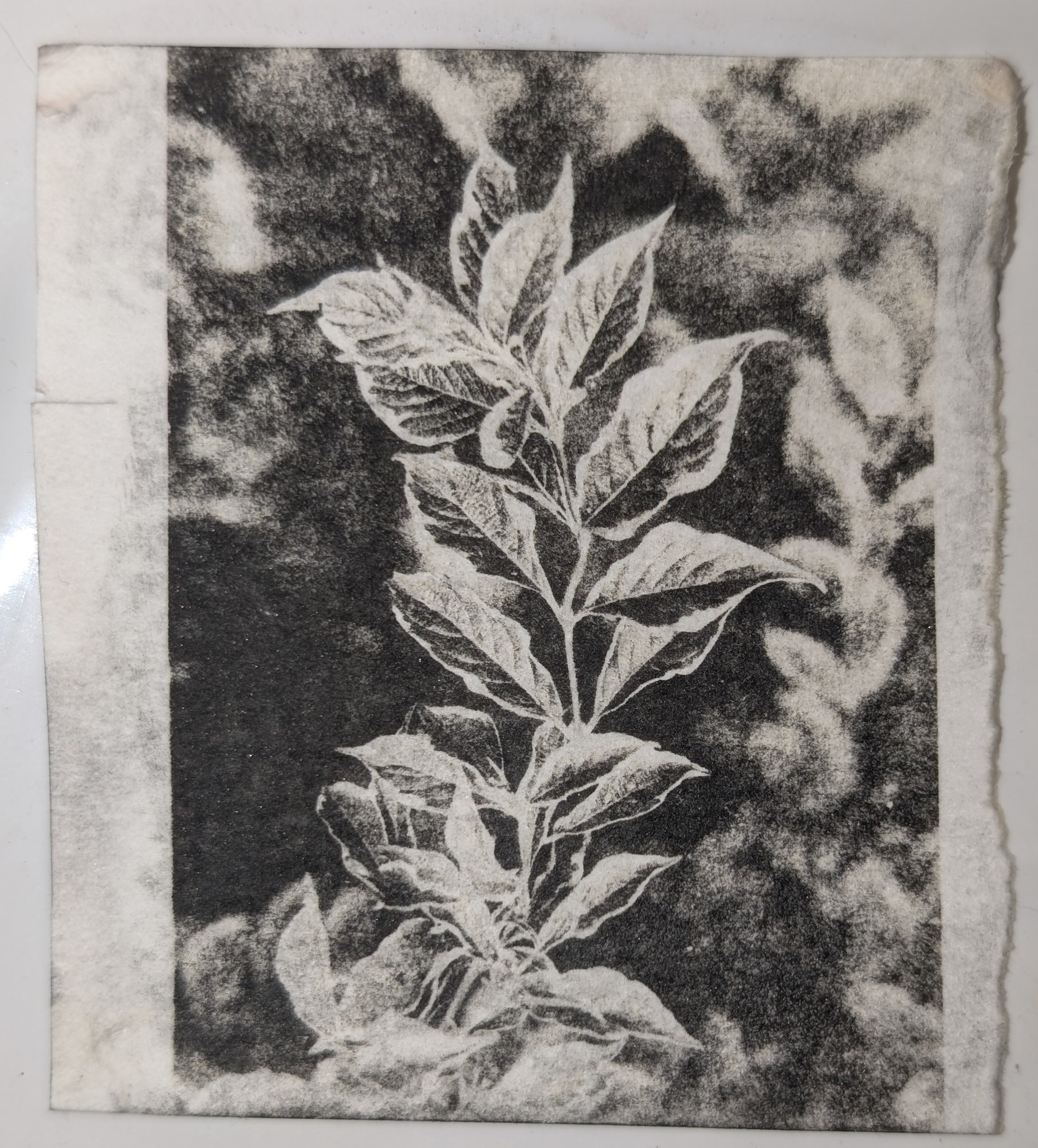

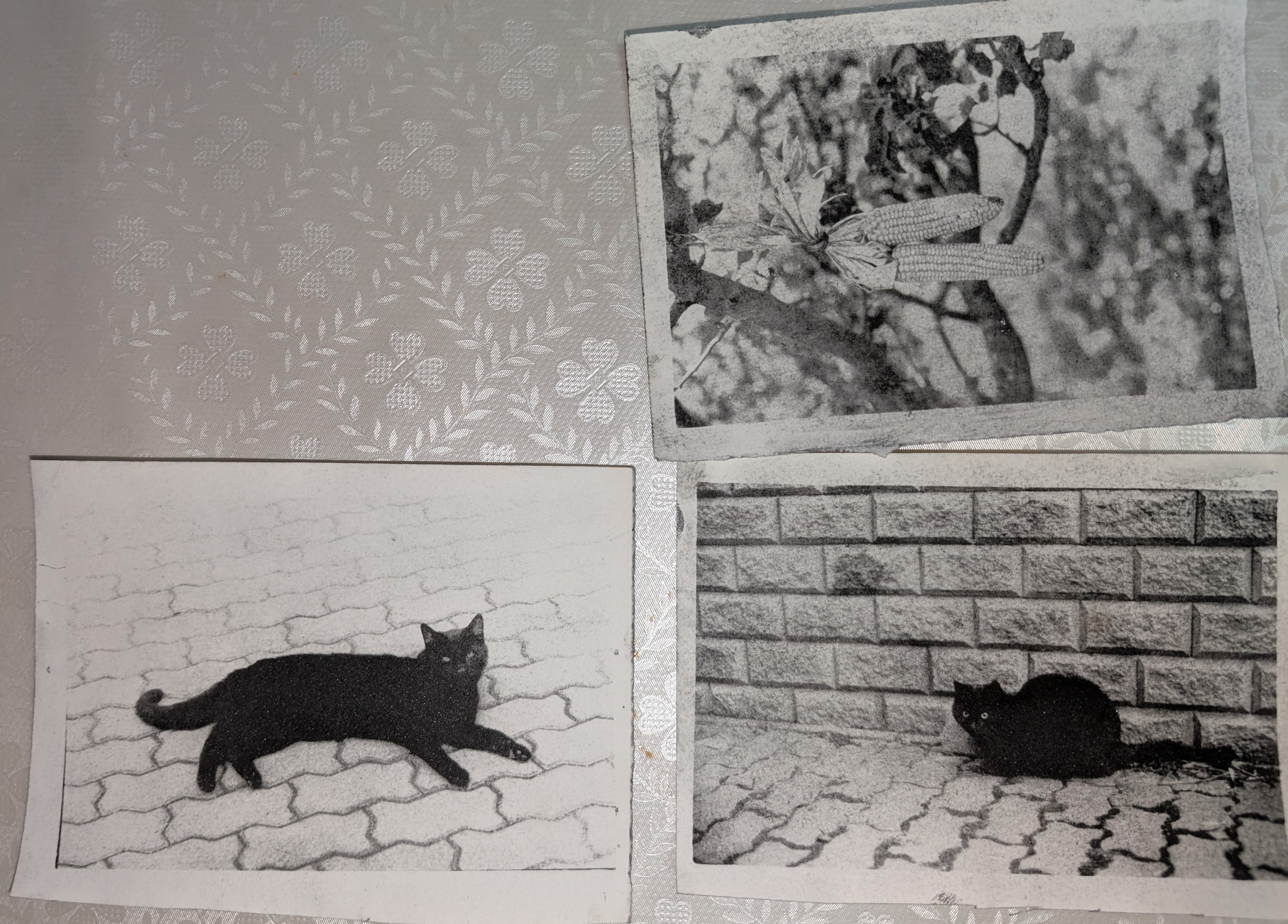

Here's some ~10x15cm prints I made with a UV enlarger from 35mm negs with my approach, and the print from the experiment with oxide yellow (~8cm long edge). Note the slight staining - it is a very fine line between getting too much contrast and getting lots of staining.
The white dots are actually the sparkle effect of the charcoal powder I used.

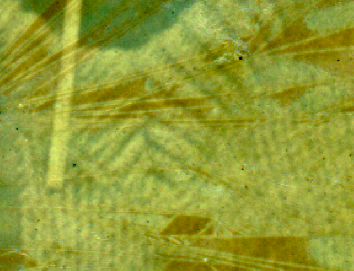

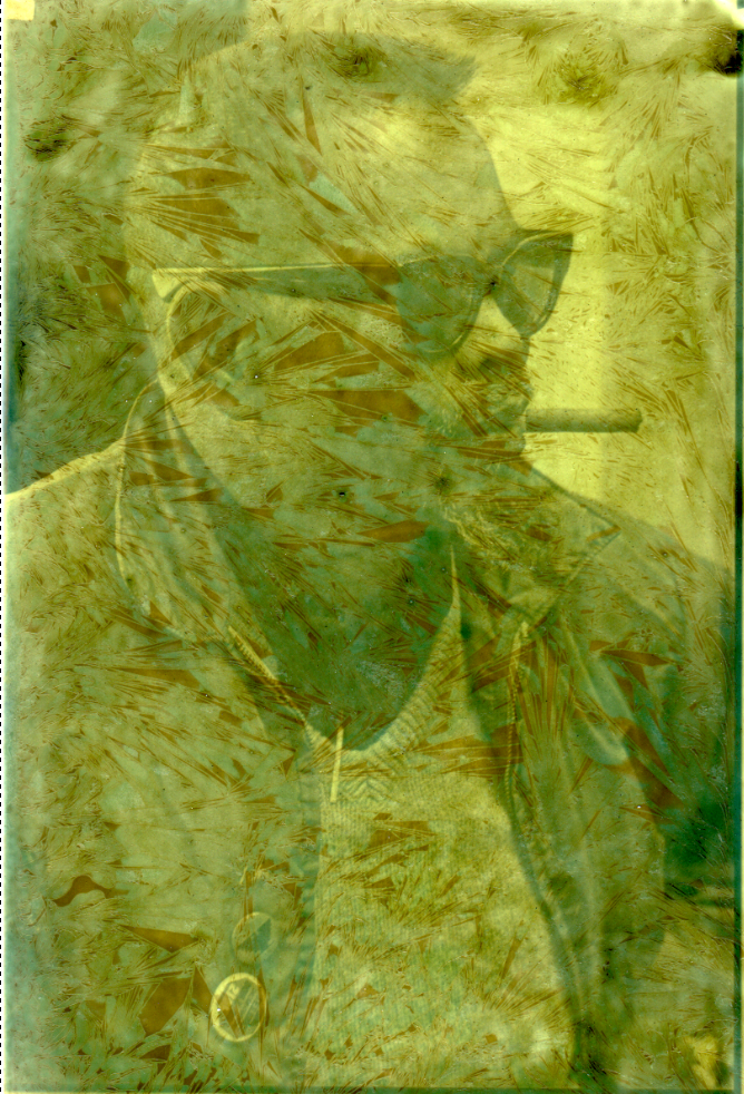

Well, what do you know, it does do something;
There's an odd reversal going on which is probably because the subject didn't receive enough exposure and I suppose the matrix remained so soft in that area that it basically just inked through. This was as quick & dirty a test one could imagine, but I'm quite surprised I actually get something of a recognizable image.
