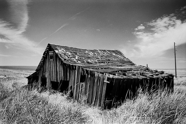

I develop HR-50 in Beerenol with great results. The recipe I use is similar to Caffenol-C, with beer instead of coffee. I found that anhydrous Sodium Carbonate works best. I bake washing soda in the over for about 90 minutes at 250F.
Old Paluse Barn by Bryan Chernick, on Flickr
That's a very nice outcome. How do you find Beerenol for shadow detail? Do you have to rate it much lower than ISO 50? When I used BTTB I had to rate it no higher than an EI 32 and actually EI 25 would probably be better. Of course, that's my style metering, my meter and my vision of the scenes lighting. YMMV!
That's a pretty good result. Which formula are you using exactly?
I don't think HR-50 is the best for shadow detail but Beerenol does pretty good for shadow detail with most films. I often rate films slower than the box speed, but I find HR-50 does great at 50.
