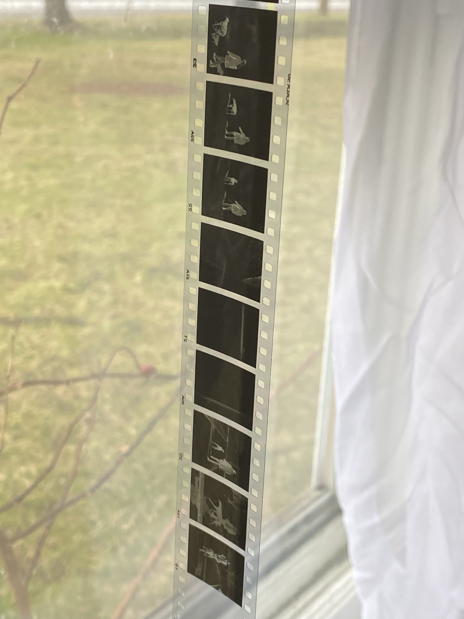

I recently tried 510-pyro with a roll of HR-50. Haven't scanned it yet, but I can already tell the results have higher contrast compared with Hartung's semi-stand Rodinal recipe.
Those negatives do look pretty "snappy". I've read where some folks use 510-pyro with HR-50. Looks like you used a Rolleiflex 35mm square format camera.😁
Olympus Pen FT - 3x4 ratio, not quite square but looks like it at the angle this picture was taken.
A lovely little camera for sure and with great lenses to boot. Maybe that's why the negatives look so "snappy"😉. All kidding aside, I didn'think 510-pyro was a good candidate for stand or semi-stand development. Maybe it can be made to work with HR-50 better than I thought?
I don't think so either. This was a normal agitation development, just testing if I can get a recipe I like better than the Rodinal one, also that unique recipe requires me to develop HR-50 separately from other films, instead of having one I could mix and match films in the same batch. Oh well, the testing continues...
