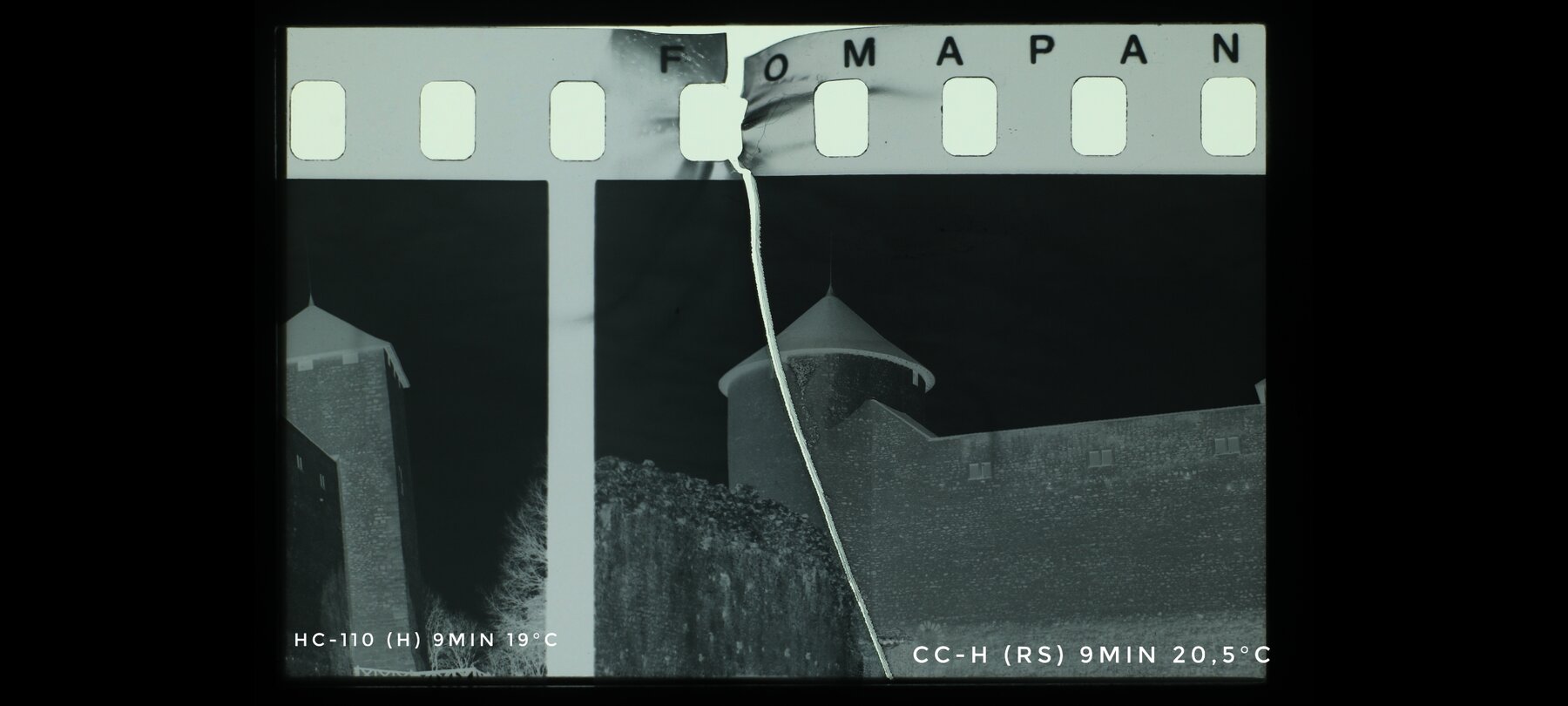

About the effect of iodized salt on staining :
Roll of fomapan 100 cut in two strips
- On the left the part developped in HC-110 (h)
- On the right the end of the roll developped in caffenol C-H (rs) with 10g/L of iodized salt instead of Kbr. Package says 15 to 20 mg/kg of sodium iodide.

So the one on the right is with just plain olde table salt added? Sure don't see any difference from my monitor. I'll still use pickling salt since I have a large amount of it in the cupboard.
Yes, ubiquitous brand of iodized table salt found over here
Well, it sure seems to work just fine from what I can see. Did you check the negative under magnification to see if there was a marked difference in grain structure or edge sharpness between the two halves? No big deal, just curious.
I'll check with my "magnifying glass" which will be a 50mm lens if there's noticeable difference in grain, but this was a first shot at finding a good developing time for both HC-110 (h) and caffenol C-H (rs) with my usual film (fomapan 100) shot at box speed. I don't exactly start from 0 with both developer so the density is somewhat similar in both strips but I can do better. I plan in the near future to shoot the same scene in the same light with a tripod for a whole roll and get to as close as I can to the same density between frames developped in HC-110 and caffenol. Then I'll have much better data to compare.

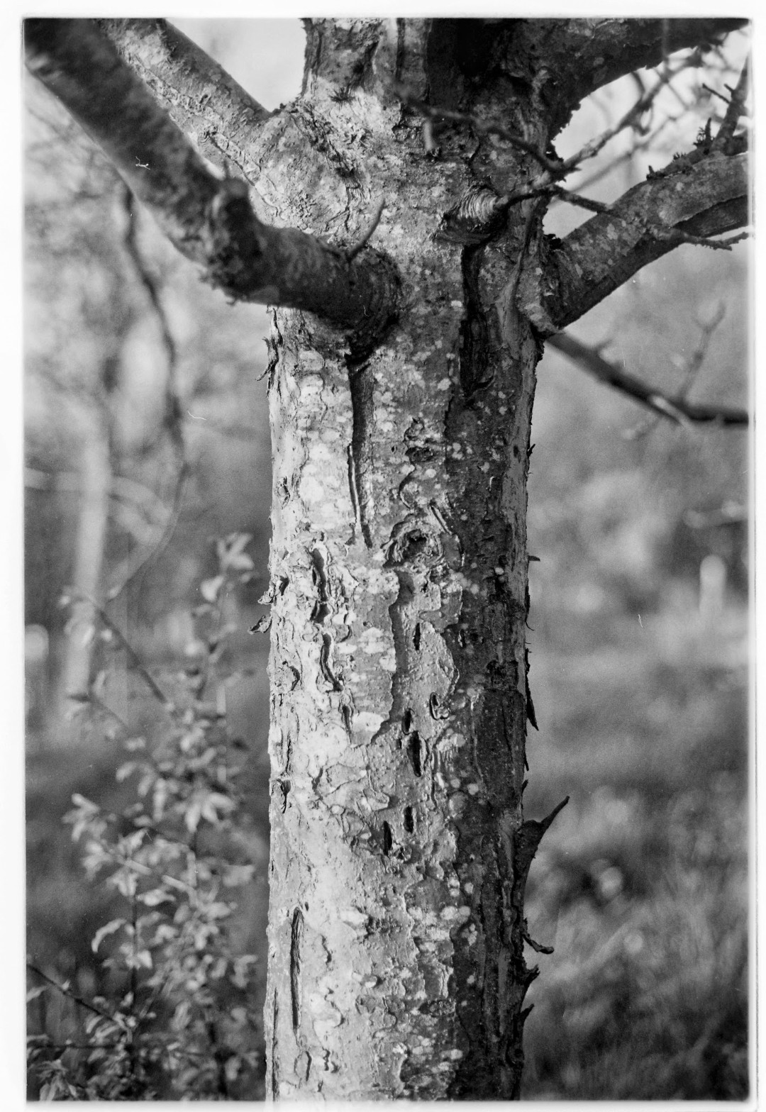

But right of the batt fomapan 100 @100 developped for 9min in CC-H (rs) using the standard Ilford agitation and with ten time the amount of iodized salt instead of Kbr works just fine. Full recipe is :
500ml water room temp
20g anydrous sodium carbonate
8g ascorbic acid
5g iodized salt
20g instant coffee
Add ingredient in order. Coffee need a little time to dissolve, let if sit after mixing for a few minutes. Be aware that the T° will rise after adding the ascorbic acid (or was it the carbonate ?). PH should be around 9.5

You probably won't see much difference if any. That tree trunk shot is very nice!
