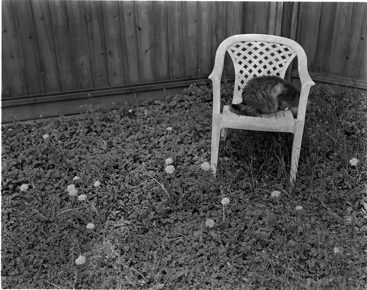

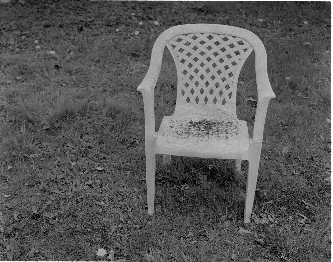

Here is a scan of two negatives. One developed in Caffenol LC (16:00). The other (with fence), in POTA (9:00). Both were semi-stand developed. Both were shot on a sunny day, in the shade. Same lens (Nikkor W150). Both EI 10. It looks like Caffenol LC is indeed a very low contrast developer, compared to POTA...
POTA (My cat jumped in during the 4 second exposure!)
Caffenol LC
Adox CMS II @ EI-12
POTA @ 23C for 9m
Agitate for 30s then 1 agitation every 3m after
Negative was scanned on a Plustek 7600i with no adjustments (sorry but my enlarger is not up and running.)
Low contrast, may try an agitation every two minutes next time.

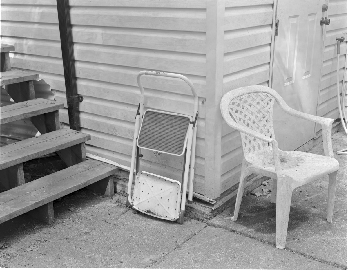

POTA. 4x5 CMS 20 II. EI 10. Reciprocity correction added. Total exposure time 80 sec at f/22. Agitation 5 sec every minute. Tray. 24C. I've ordered a couple of bottles of Adotech IV to compare.
