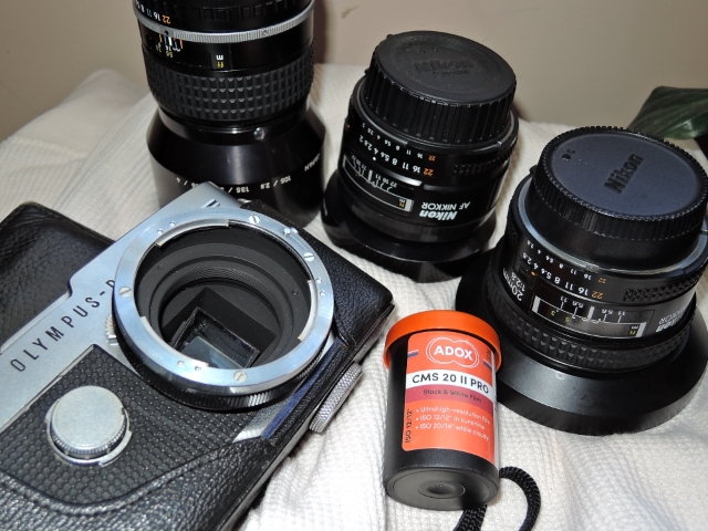

Over the next days or weeks I'm planning on shooting a series of 8 half-frame exposures on CMS 20 II with the kit below and developing each strip in a different developer. Loading and chopping out the film in the dark should help conserve more of the 72 exposures. Rating at 12, no filtration, with an incident reading or zone 3 shadows w/ notes on exposure & ambient conditions.
Developers on the list so far (in no particular order):
1. POTA (Phenidone)
2. Pyrocat-HD @ 1+?+100 (Phenidone + Pyro)
3. DK-50 @ 1+1 (MQ, borate alkali)
4. HC-110 syrup @ 1+119
5. B&W reversal attempt?
I'm open to to suggestions for times for the above developers or other suggestions for a particular combo (filtration, reciprocity, etc).
