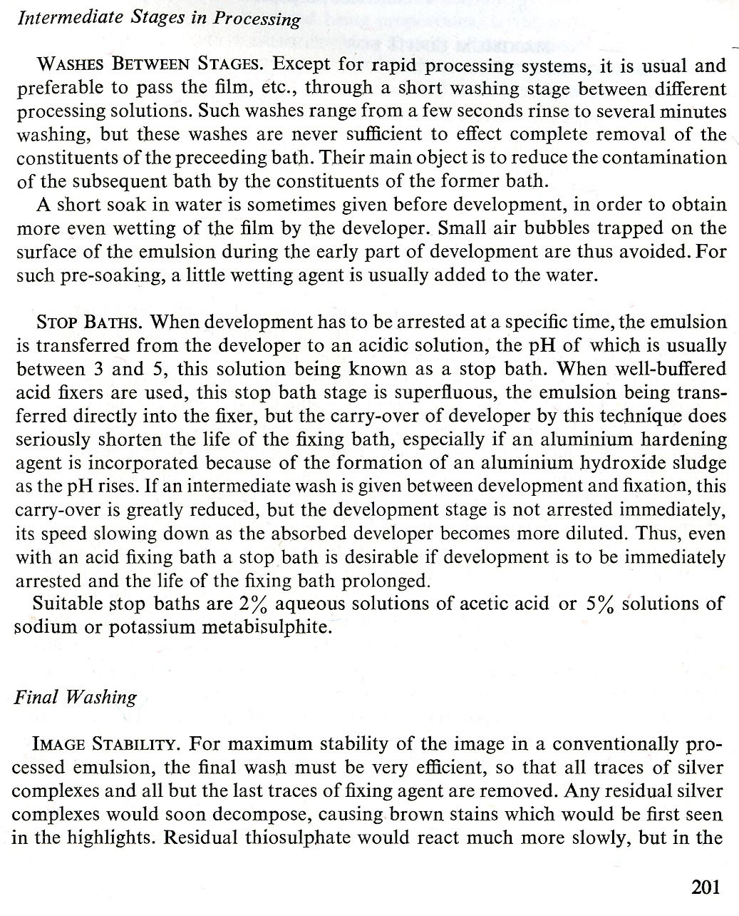

Ian has again abridged Mason's statement which I scanned and posted earlier. I will quote Mason here: "When well-buffered acid fixers are used, this stop bath stage is superfluous, the emulsion being transferred directly into the fixer, but the carryover of the developer by this technique does seriously shorten the life of the fixing bath......" There, in the whole quote you see how the meaning is changed over the what Ian has suggested in his post above. Ian states that he is not referring to leaving out the stop or rinse but the quote from Mason refers exactly to that situation when he uses the word "superfluous" and thus it totally negates Ian's argument.
I have never said that you NEED a stop with TF-4, I have said that you can use one if you wish. I do.
And, a stop will help prevent excessive swell with film products that are prone to greater swell due to lower hardness. That is another reason for using a Stop. The readers may also wish to go back and look at the reasons I posted. I've also stated that I have had yellowing with prints when I omitted the stop, but not film. The literature is not entirely clear on this, and I will assume that this refers mainly to FB papers.
Both Mason and Mees say that a rinse is acceptable for film, but a Stop Bath is better. That has been my position from the start. I prefer a Stop. I recommend a Stop. That has been my position from the start. I have presented both sides of the case, I have stated my preference, I have stated my actual practice, and I have given the reasoning behind it and supporting references.
Do what works for you!

Ian, as you point out, Kodak and Fuji apparently use a wash step. Mason was referring only to cases where there is NO step between Development and Fixation.
Here is a repost o the entire page. Please look again at the Stop Bath section.
PE
PE
I have.
It says that if you don't use an acid stop bath, development will not stop as fast as when you do. And that you can reduce the life span of fixer if you move from developer to fix immediately.
Nowhere does it mention any of the problems you keep telling us we should fear when we use a water rinse instead of a stop bath. Not a single mention of ruined negatives, or even the danger of ruining negatives.
I have said so before: you are presenting a very lopsided view of this matter.
Quite balanced, indeed, when you say that both options work, that both options are endorsed by film manufacturers, that both options are in the literature, that neither option creates problems. So far so good.
But then you give the entire thing a slant by warning us about the dangers of not using an acid stop bath.
What keeps puzzling me is: why?
Why, if you say that both options work, that both options are endorsed by film manufacturers, that both options are in the literature, that neither option creates problems, do we need to fear problems?
Problems (again) that i have never come across, and you too say have never come across? Problems that film manufacturers don't seem to fear either?
And why do you quote texts that don't appear say what you say they would, in support of a view that you, in your balanced reporting, say you don't support?
Q.G.

See post #140 for scan of the orginal text by Mason....

Re Mason:
Going from the cut and paste data...
Does someone have that reference?
I can't find it at this moment (name title date)
I was going to comment independantly,
but found PE has already and repeadtedly,
pointed out that Mason does not really say that stops are superfluous...
Yes he says those words but that is not his message.
What he is saying is:
[the] stop bath stage is superfluous,
[in the sense that the required pH is present],
[of using no stop or just a water rinse]
Thus, a stop bath is desirable
if development is to be immediately arrested and
the life of the fixing bath prolonged."
I cannot see how this can be read as saying Stop Baths are Superfluous;
to me, I would say Mason feels that a stop bath is desirable.
100% necessary? Maybe not.
It's up to you.
