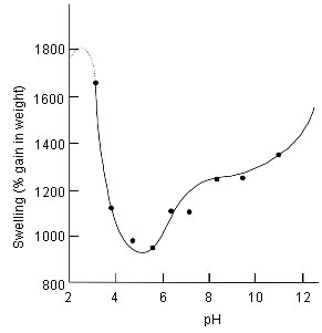

On the more mundane and currently OT subject of Stops, I have been reviewing Anchell and Troop, most particularly page 103 on Stops in Chapter 12.
I have discussed these points with Bill personally and also with 4 fellow Kodak engineers including Grant Haist. Here is the consensus.
1. pH variations generate heat and can cause grain clumping.
This was an early theory which has never been proven anywhere. Energy calculations based on concentration preclude that sufficient heat be generated. Therefore, this is dismissed by all with whom I have discussed it. The theory stands as unproven in any way.
2. Acid Stop can cause pinholes with carbonate developers.
First advanced by the book on photo processing chemistry by George Eaton in the 50s, this has only been seen in deep tanks with films before and in the 40s. It seems that the deep tank will allow for formation of CO2 gas in film and that hydrostatic pressure in the deep tanks of photofinishers would restrain release of the gas. When the film was quickly raised out of the Stop the gas would release causing pinholes. It was never seen in small tank, tray or any other method and never seen in the 60s or later with harder films.
I have personally tested films and papers from 68F to 120F in Carbonate developers during our conversion from Borate to Carbonate in the 60s, and have seen no problem using a stop. Kodak now uses Carbonate developers for all color products at up to 100F and a following Stop causes no problems.
3. Acid Stop may cause excessive swell.
This was true about 100 years ago with Pig Gelatin based photo products. Today, using Bone (Cow) gelatin and polymers, this is not true. In fact, the conversion took place in the 50s - 60s.
See the attached curve for swell vs pH.
Bill and I had planned on including a larger revised and corrected section on Stop Baths in a revised edition of Anchell and Troop but this will probably never take place. Portions of this have been posted elsewhere.
PE

The pH of Vinegar is about 2.9 and is about a 1 molar solution (5% - 6%). Stops are in the range of 1% - 2% and are therefore much weaker than that and have lower buffer capacity. Many Stops are found to be in the pH range of 3.5 - 4.5 and many acid fixes are in the range of 4.5 - 5.5. Above that point, the fix is generally considered neutral in pH. A Stop must not be above 2% in concentration for good results.
The generation of Carbon Dioxide can take place in either a Stop or an acid Fix at pH values from 3.5 up to about 5.5. Above that, much of the CO2 will tend to stay in the water. The formation of pinholes from outgassing was never demonstrated to take place in tank or tray processing in any way with any film.
The matter of gelatin swell noted above is based on type of gelatin. Manufacturers use mainly bone Gelatin, not pig Gelatin. So the argument of swell vs pH is not one of hardness per se, but rather one of the type of gelatin used. Only the manufacturers can tell us for sure what type of gelatin is used. Kodak uses Bone Gelatin, Ilford and Fuji appear to use Bone Gelatin. The majority of photograde gelatins made today are Bone Gelatin. QG, I refer you back to a previous post here on swell vs pH.
I have fully discussed this item elsewhere and have discussed it with Bill both in person, on the phone, and on-line. Ian, you have commented here on 3rd party books many times. :D My opinion of A&T is very high. I merely point this one bit out as an exception that would have been fixed in a new edition.
In no case has the neutralization been shown to cause problems with clumping nor is there any excessive heat in the emulsion. In fact, one of the engineers broke out in a fit of laughter when I brought it up. It is classed as "one of those old myths"!

OK, OK, Ron, enough! I accept what you say on this point. But the point was given to me by Grant, so I thought it was worth running with. Both of us wanted to promote alkaline fixing and used every argument there was. Some of the arguments are good, some are less good, and this is one of the less good. Most people here wouldn't know what an uphill battle it's been to get neutral-to-alkaline fixing accepted at all. But it has been. Even in 1998, the year FDC came out, many of those who read the manuscript thought I was nuts to discuss it. Zawadzki, Dickerson, and Crawley just did not like it. And remember I already had my alkaline fixer formula out on the market for a decade before that. I would never have had the courage to do that had it not been for the encouragement of Haist and HD Russell. By the way, I join you in the hope that Steve Anchell will let us do a second edition of FDC together - - it would be fantastic to be working directly with someone of your calibre. Steve, are you listening? Pretty please?
