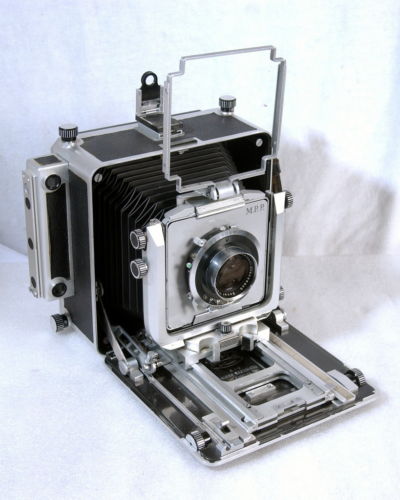

This would be a far superior outfit, for less money too.
eBay item number: 121231290457
If you want a 4x5 view camera MPP in good condition takes some beating.
RR
Regular Rod
Aug 6, 2012
665
Derbyshire
An English camera maker, Micro Precision Products, which flourished for a while and made very high quality cameras and other equipment.
There is a healthy user group and just about anything can be obtained or made to keep your camera operational.
Here is the website: http://www.mppusers.com/
RR

removed account4
Jun 21, 2003
29,810
hi raffay
if you are going to use camera for portraits only you don't really need a view camera
with movements like a sinar p.
while a sinar might be a good value ( years ago the same camera sold for much more )
why buy something you don't need ?
you can get away with portraits and landscape ( if that is what you like ) some architectural / site work as well
with something like the mpp, or a different brand press camera. some have a in camera shutter ( speed graphics, besslers )
which allows for barrel, brass, enlarger non-shuttered lenses as well.
i've had a speed graphic for decades, it was my first lf camera, purchased just out of school .. and have used it for everything mentioned above even product-stuff.
in my no so humble opinion, the press cameras are the most useful cameras for non-specialized photography.
if you were doing table-top product photography, or perspective distorted portraits &c i might say go for the sinar, but
the portraits you have posted of your family lean me towards the press cameras.
good luck !
john
Regular Rod
Aug 6, 2012
665
Derbyshire
Hi Raffay,
John is giving you very good advice here.
Local to you I should imagine it would be possible to find usable MPP cameras due to the historic connection between Pakistan and the UK. Has your local police station got one in a cupboard that is no longer used thanks to digital? Could it be bought for a reasonable price. A police or military MPP kit is usually very well equipped with all sorts of useful items as well as the camera. Probably there are several of these languishing in cupboards and drawers waiting for the day someone comes along to appreciate them again and put them to work...
RR
