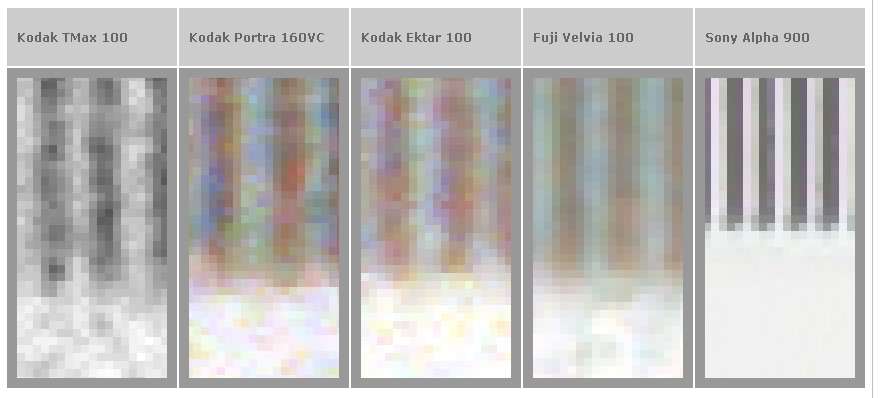

http://www.boeringa.demon.nl/menu_technic_ektar100_resolution.htm

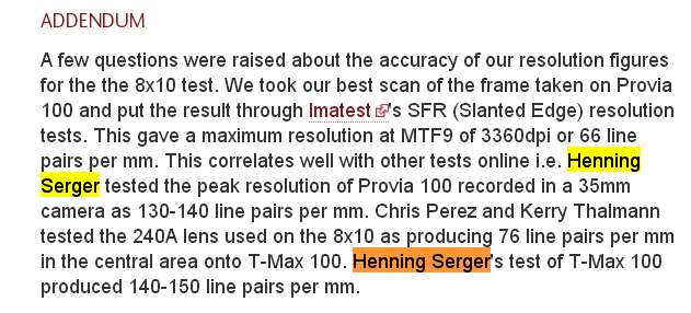

Forget this guy's results. Try Henning Serger.
Before trying to discredit a source like Parkin, read well the test... (https://www.onlandscape.co.uk/2011/12/big-camera-comparison/)

I did. Parkins findings are well below mine and Hennings.

Marco Boeringa (http://www.boeringa.demon.nl/menu_technic_ektar100_resolution.htm) showed that Ektar and Portra (VC version) had a very similar yield, samples are scanned 8000 dpi in an Imacon (flextight), also showing a clearly higher MTF in the TMX case.
Also the ancient (2008) Apha 900 (5.91 µm pixel pitch) was showing something (the doc explains why the bars look smaller, film is relatively oversampled).

There is no reason why the low contrast resolution ,quoted in post 123, should suddenly drop off from 88 lppm to 50 just because no test chart is included in the picture.
You have disagreed with the results I have referred to from the commercial scanner dealers Scandig.com in post 117.
You have disagreed with the results from the expert who did the tests for Amateur Photographer for many years , post 123.
