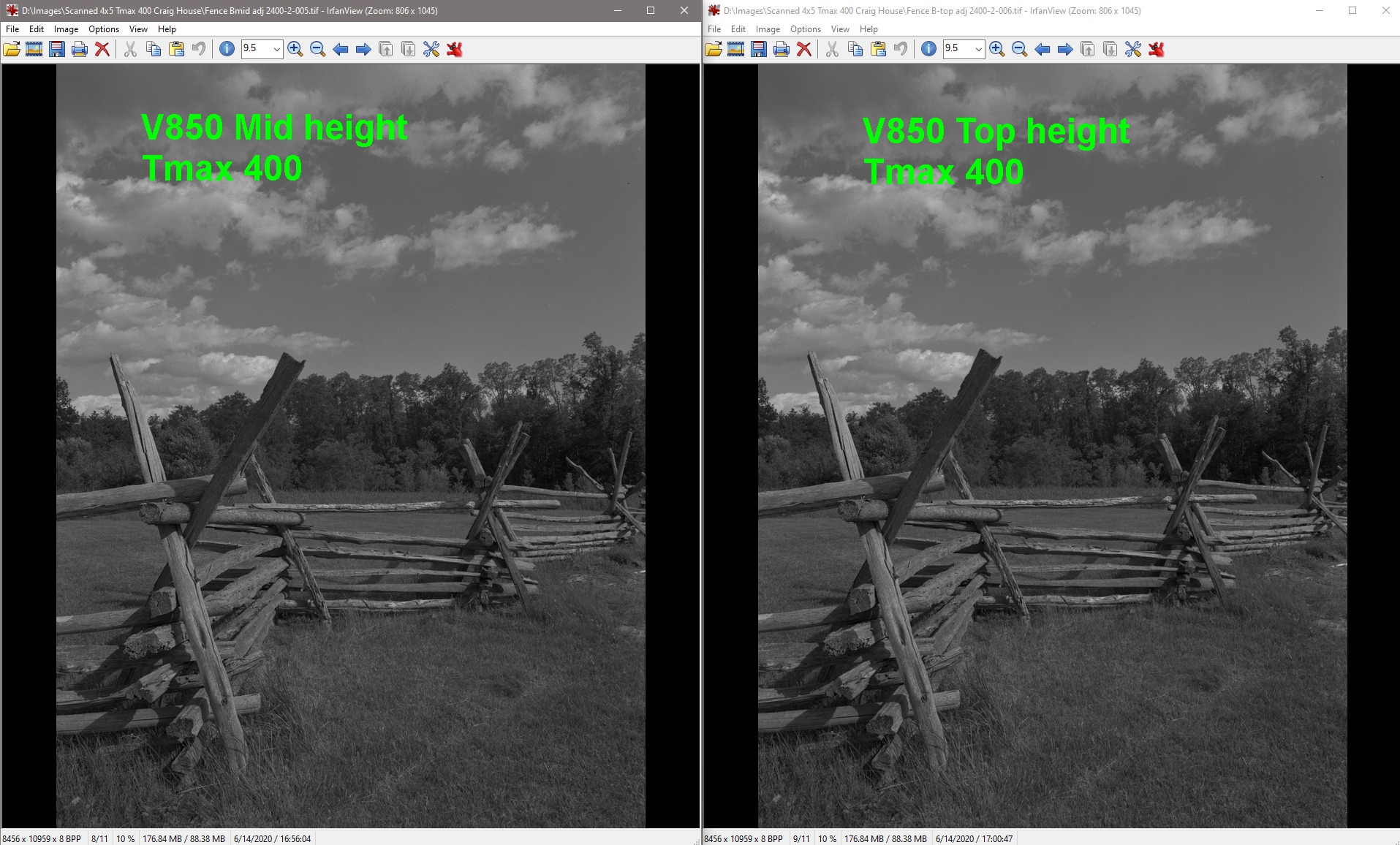

Here is another comparison showing focus based on height adjustments of the Epson V850 Pro 4x5 film holder. No sharpening was applied. This is another photo on different type film. Tmax 400 instead of the previous Tmax 100. While you can;t see the difference looking at the whole picture, the sharpness is very obvious when zoomed in. The scanner comes with two holders for each format. So you have to check the correct height for each one. The two 4x5's were actually different. One was best focused at Middle of 5. The other was best focused at the 4th of 5, second from bottom.

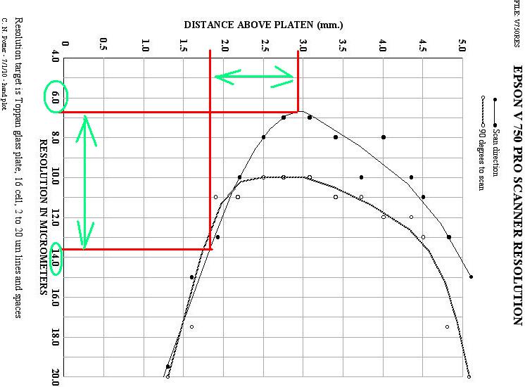

With a 1.2mm curling the Epson losses half of its performance, see this graph, resolution falls from 7 microns to 14:
