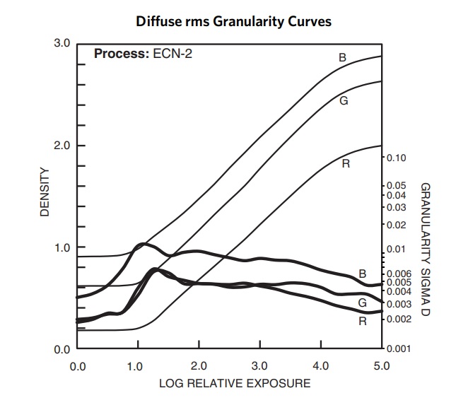

Вormental, negative film is designed to record an insane amount of Dynamic Range, well beyond monitors or paper may show.
Kodak and Fuji both disagree with you, as they publish different information in the data sheets for the films they sell. The only advice I can offer is "go and study". And as you'll be learning about DR, stick to just film and sensors, leave monitors for a later time (you're not up to date on monitors as well).

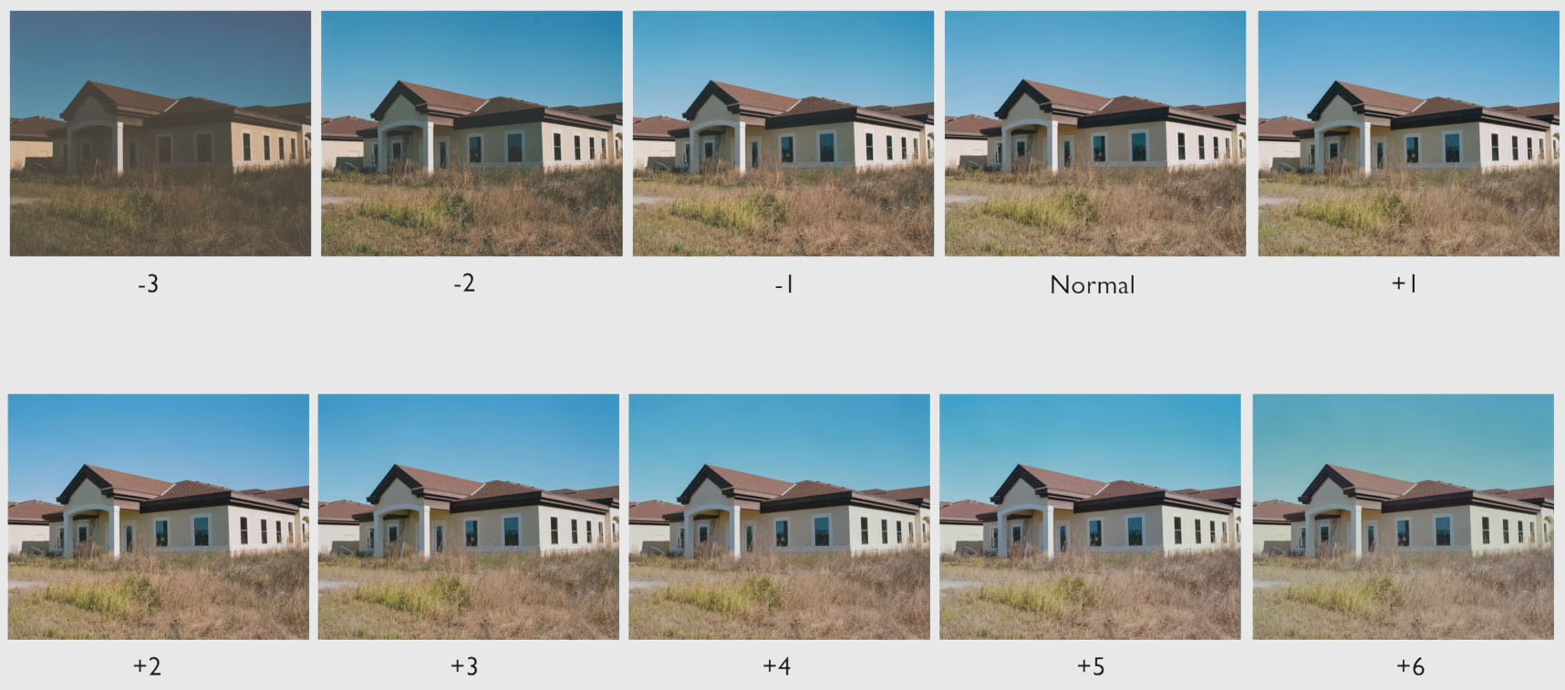

This is an exposure test with Portra 400:
https://petapixel.com/2018/02/05/test-reveals-exposure-limits-kodak-portra-400-film/
It shows a 10 stops dynamic range without exhausting the film capability, and in the +6 shot you have sun bathed walls that would be additional +2...

This is the Vision 3 (Cinestill) similar to Portra, each H unit is 3+1/3 stops:
So it has 10 linear stops and 4 additional stops in the shoulder, without pulling development. If you pull you add several additional captured stops to 16 or 17 total.
