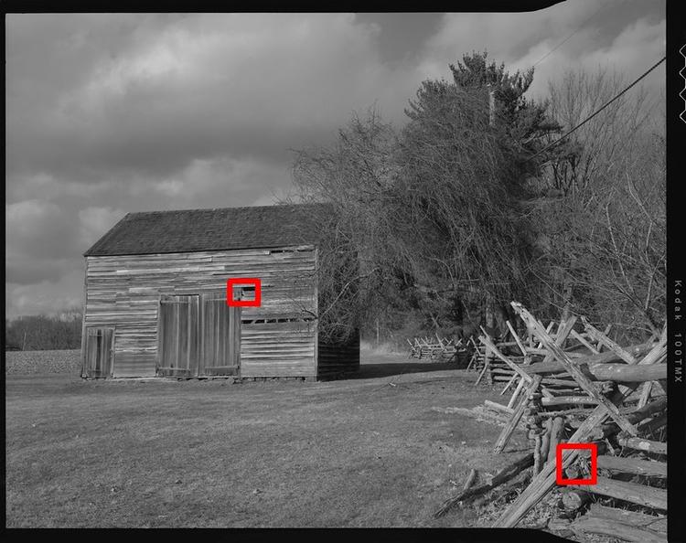

I guess you missed the crucial microscope crop part at the end. Everyone knows the Plustek scanners, while certainly better than any flatbed ;-) is not optimal in any sense of the word.
And also you missed the microscope images in the Parkin link of yours.
Even Tim Parkin concurs that good DSLR macroscanning is the superior solution over drumscanning for 36x24 and smaller.

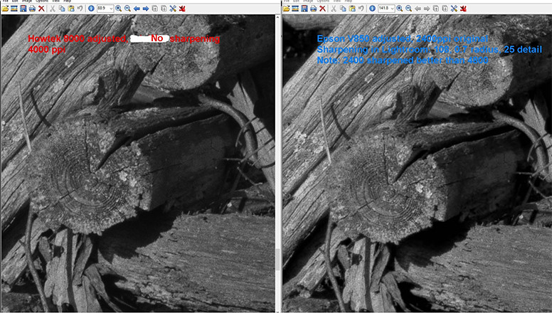

You may find intersting this particular thread, comparing a howtek at 4000 dpi with an Epson V850:
https://www.largeformatphotography....wtek-8000-Drum-vs-Epson-V850-flatbed-scanners
__________________________________
A V850 yields 2300-2900dpi effective depending on the axis, a plustek reaches 3500 effective which is the same than a Drum at 4000. The drum may scan at 8000dpi or more...
A DSLR scan, if stitching enough crops, may reach 10000 dpi effective, for example if stitching a 3x3 mosaic for a 36x24mm frame, this is something I personally evaluated with a USAF 1051 glass slide, with a reversed enlarger lens. I you want I link the thread.
Anyway you may know that scanner performance is a plain overkill from some certain point, if the film does not resolve more...
____
Let me post the howtek drum vs V850 result ( bad news for the epon haters:smile: ):
I really have little experience with the Plustek scanners. All I can see is that the results is a notch above the positively soft 850, and below the (already barely acceptable) 2004 Pakon standards.

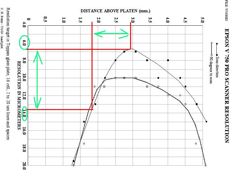

This is a urban legend, coined by people not knowing how to focus the epson and having little skills in image edition.
With a 1.2mm curling the Epson losses half of its performance, see this graph, resolution falls from 7 microns to 14:

The pakon is inferior to the plustek, IIRC.
The focus, the stitching, the color inversion, dust...
The epson detects/corrects dust in the infrared dedicated channel working perfect specially for color film.

I tested the two 4x5 holders that came with my Epson V850 Pro. There are five stops of height adjustment. I found on one of the holders, the middle slot was the best focus. On the other it was the slot between the middle and bottom. The difference was fairly apparent when comparing unsharpened scans.
Needless to say, you should test the heights for best focus when you buy one of these scanners.
Alan, you are privileged because you have the new holders, beyond adjustable height, with the curling up the ANR glass ensures flatness, which is of great value because if not there is no way to focus all the frame if some curling is there, with the former holders in the V700 it was necessary to get 3rd party holders to obtain the results you are obtaining straing from the box.
Also, as obviously you have discovered, Epson images require a proficient edition to shine, once you get used to it then you do it in two clicks. Personally, I prefer a very raw image from the hardware and making manually the optimization, specially for portraiture.
What is not debatable is that the Epson is a top notch performer for MF and up, there is no doubt, that side by side you performed is smashing evidence. I don't know if you are totally aware but you are rivalling a good Howtek drum with the Epson, not everyone would be able because it requires a proficient scanning and a proficient edition, this takes some effort, but wet mounting the drum takes way more effort.
