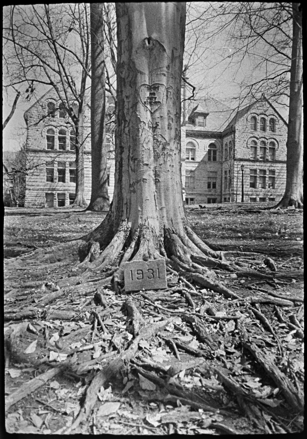

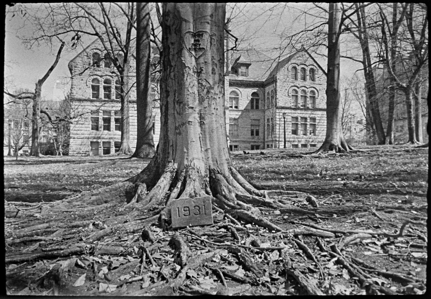

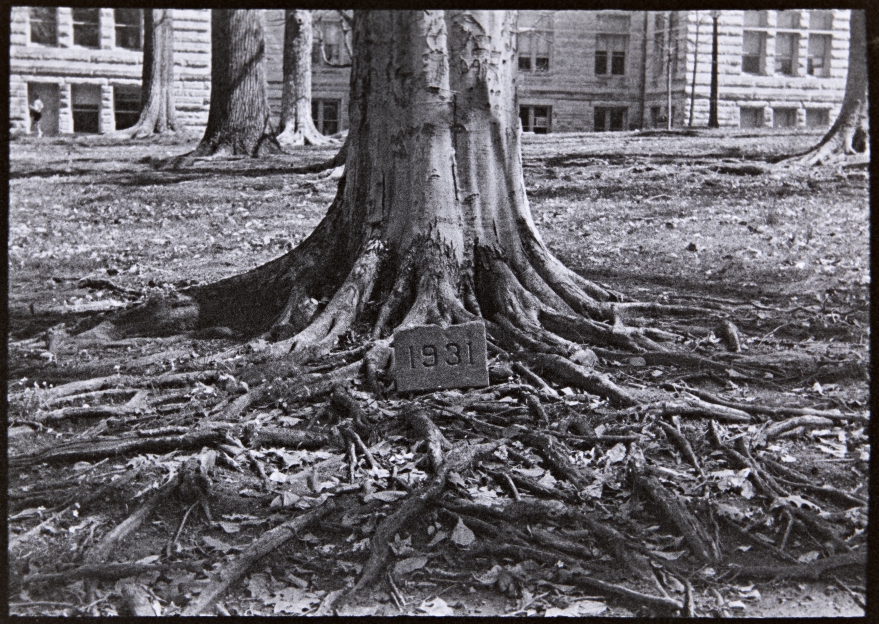

Mamiya 16 'De Lux', f/4 1/25s
Fuji HR-21 @ 12; Parodinal 1+100 25'
D850 negative scan w/ El-nikkor 40mm on bellows

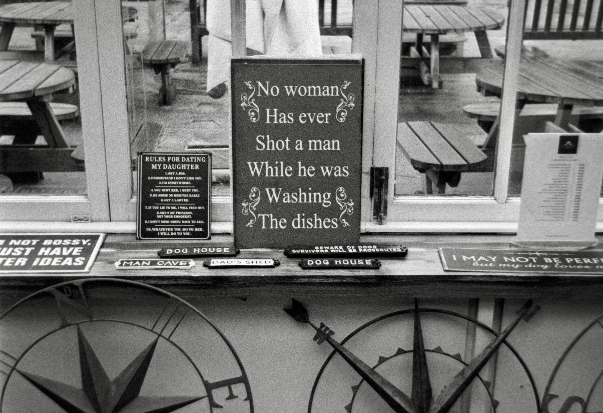

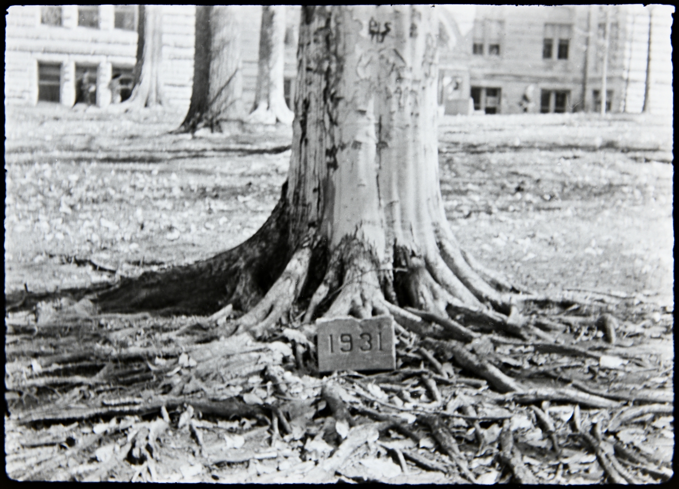

Minolta 16ii, f/11 1/125s
Double-X @ 250; Pyrocat-HD 1+1+100 11'

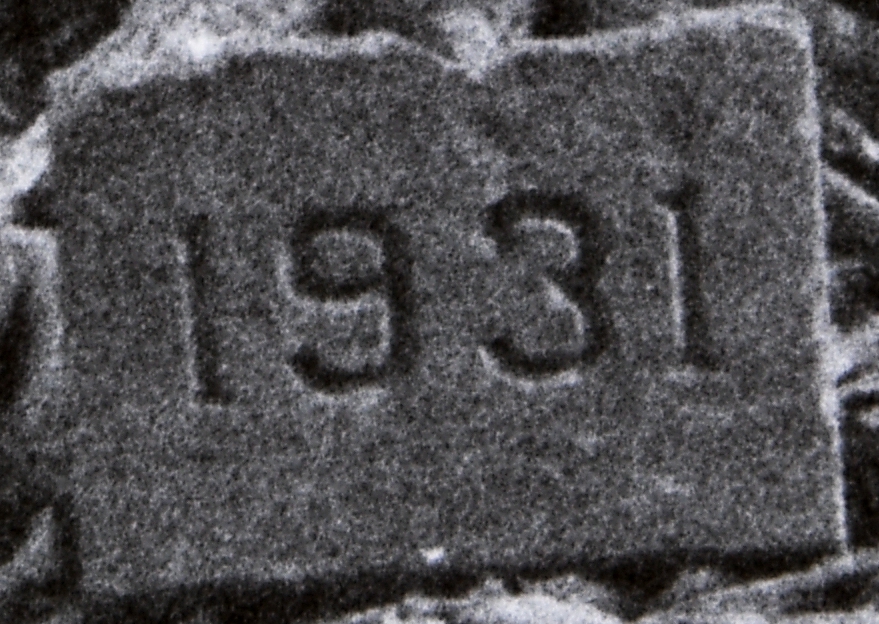

Edit: 100% crop for the pixel-peepers

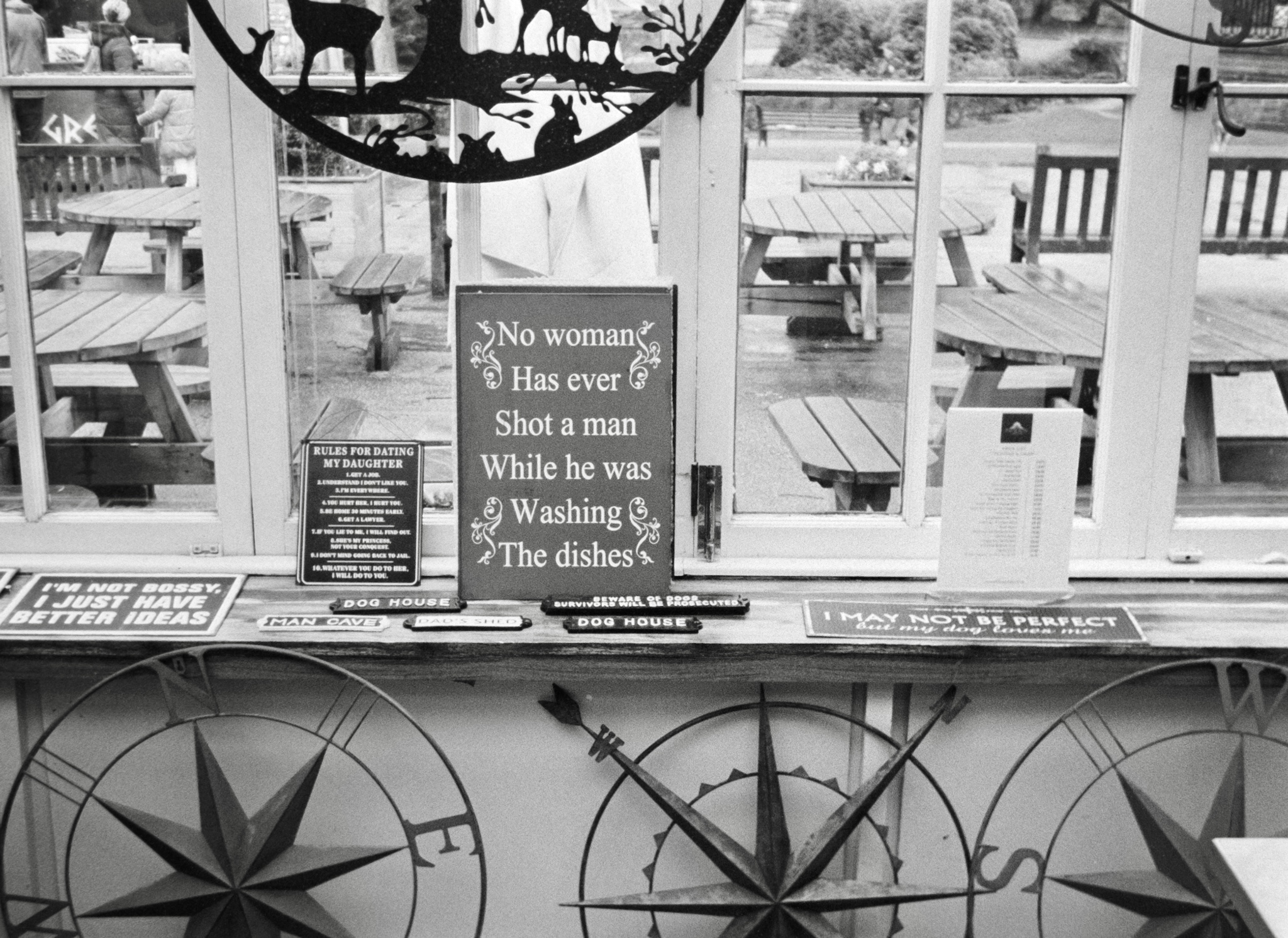

Rollei 16 w/ Mutar 0.6x, 'A' mode
Double-X @ 100; Pyrocat-HD 1+1+100 9' (N-1)

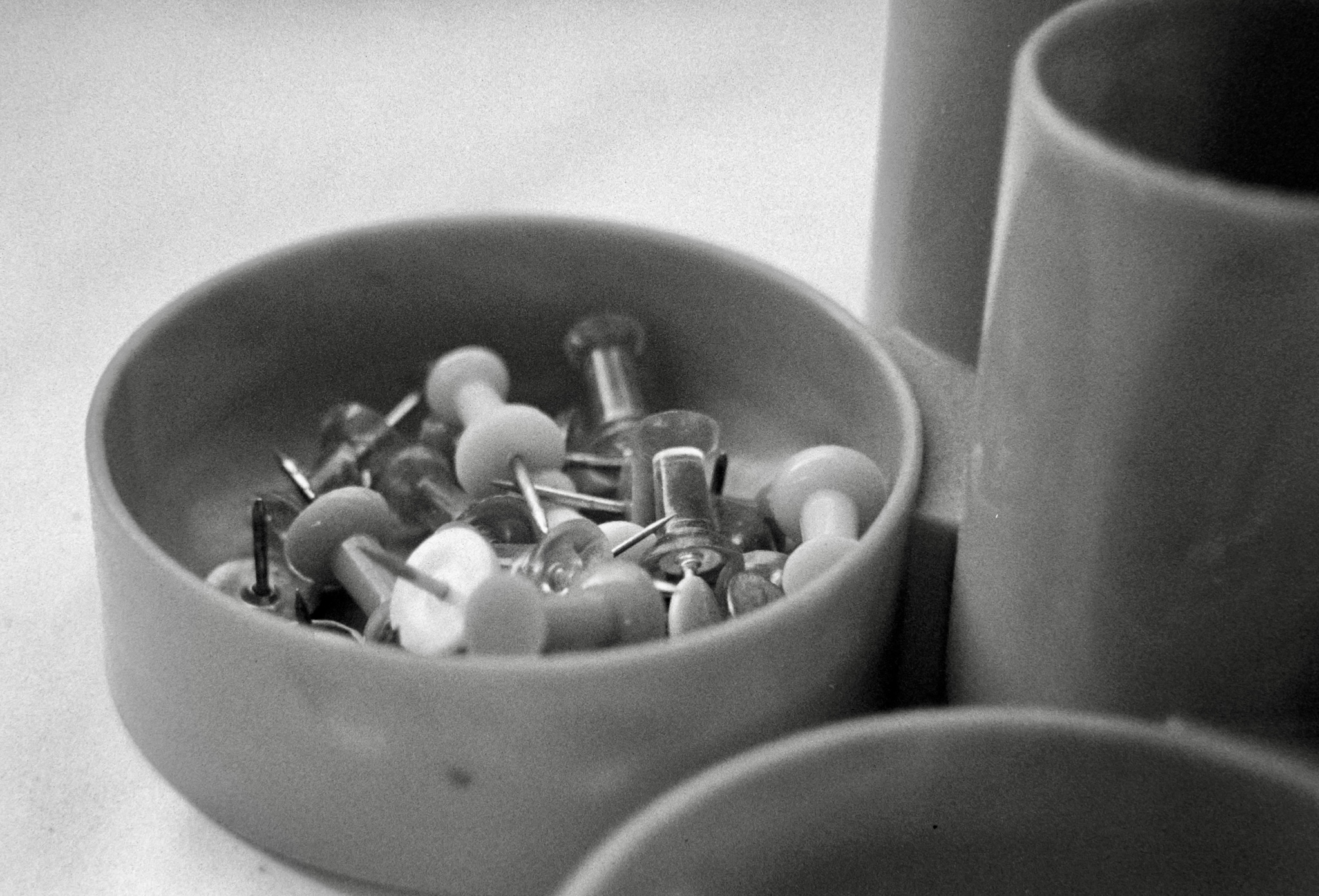

Pentax Auto 110. 24mm with closeup lens. Shot on expired Eastman 5231 (Plus-X).
Rollei A110. Lomography Orca developed in Rodinal 1:50.
Minox B. ADOX HR-50 in ADOX HR developer. Compare this with the much larger negative used for the shot in my previous post.
