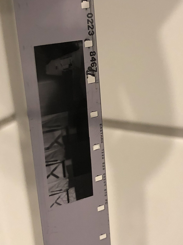

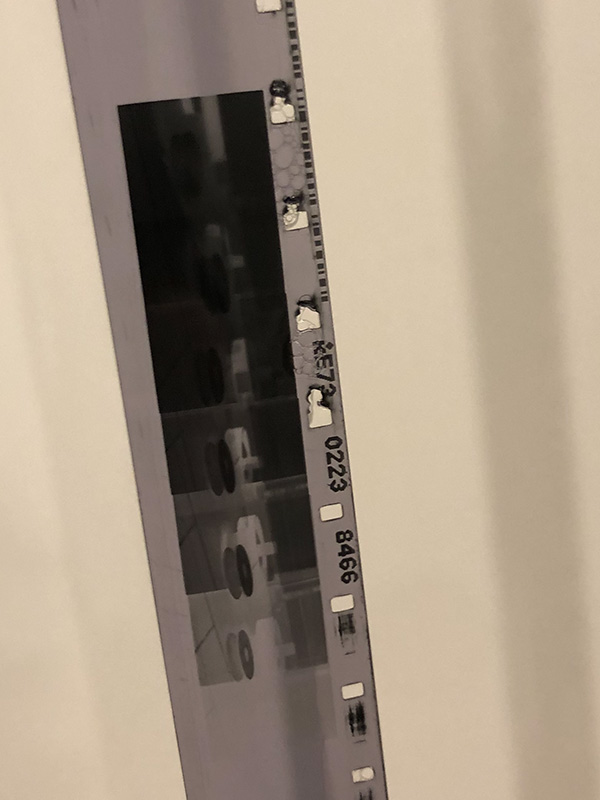

I have developed my first roll of Kodak Double-X 16mm using CineStill D96 and Adox Adofix.
Unfortunately, my MEC 16SB seems to have some feeding issues. I have attached some screenshots. It has also added tear on the feeding perforations.
How can I fix this issue?

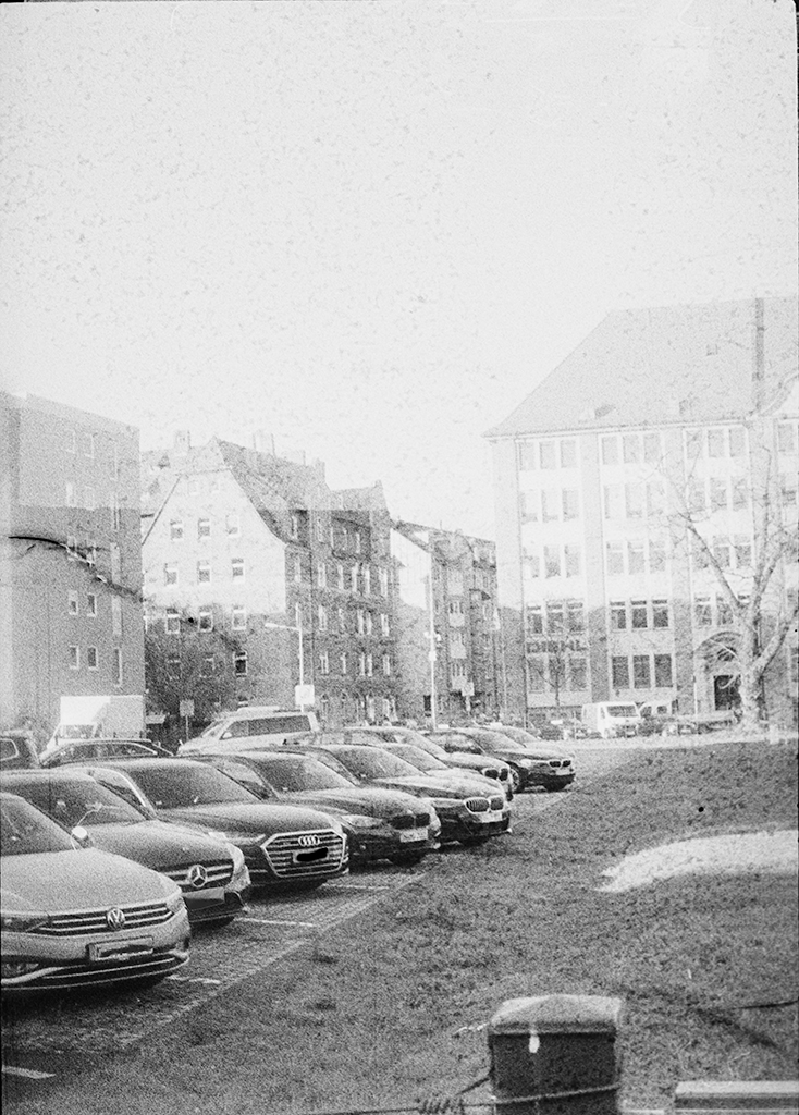

I have to find someone who is able to fix old cameras. I am quite surprised that the sharpness is not even that bad.
Anyway - does someone know how to get rid of those spots in the sky? Probably something I did wrong during development?

My understanding is that the MEC uses sprocket teeth to pull the film out of the feeder cassette and push it into the take-up cassette. My guess is that either the film is having a hard time getting pulled out of the feeder cassette or is having a hard time getting pushed into the take-up cassette -- or both. I'd check out both cassettes, reload them with scrap film and see if you can find any obstruction with the lights on.
The spots in the sky look like a development problem -- bubbles? Do you use a prewash?

Check the cassettes. Does the film exit and enter smoothly? 16SB should be able to use both double and single perf.
Feed the failed film through the camera and observe closely what happens when the claw crabs the film and pulls it. Are all the springs there?
Ripped sprocket holes can be both too much tension on the film, or incomplete grabbing of it.
