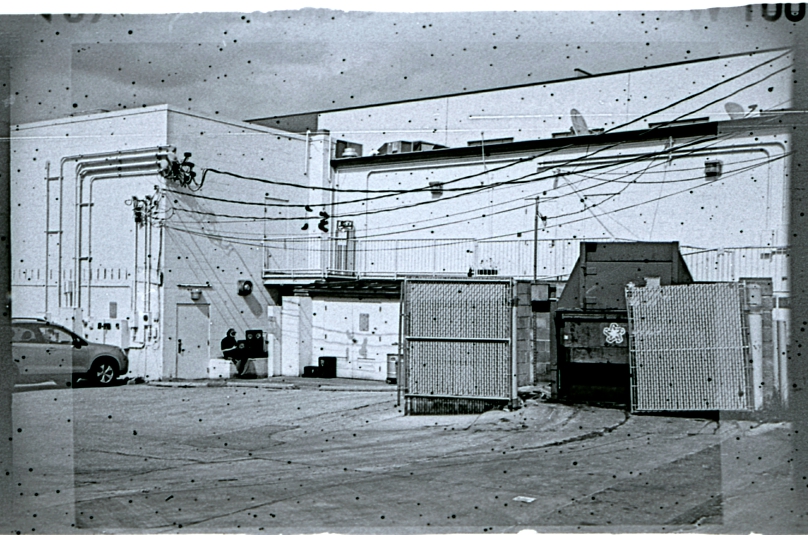

Spots are iron oxide ?
Not sure, but it is the 2nd roll of spotted Orca from a pyro developer, so the two likely aren't compatible.
Edit: this is a negative, so the spots are areas of undeveloped film
It happened to my first rolls of Rollei ATP 1.1 (20asa), and it took me a while to realize the myriads of black spots on the negatives were actually iron oxide from tap water. Switched to distilled, the spots went away completely.

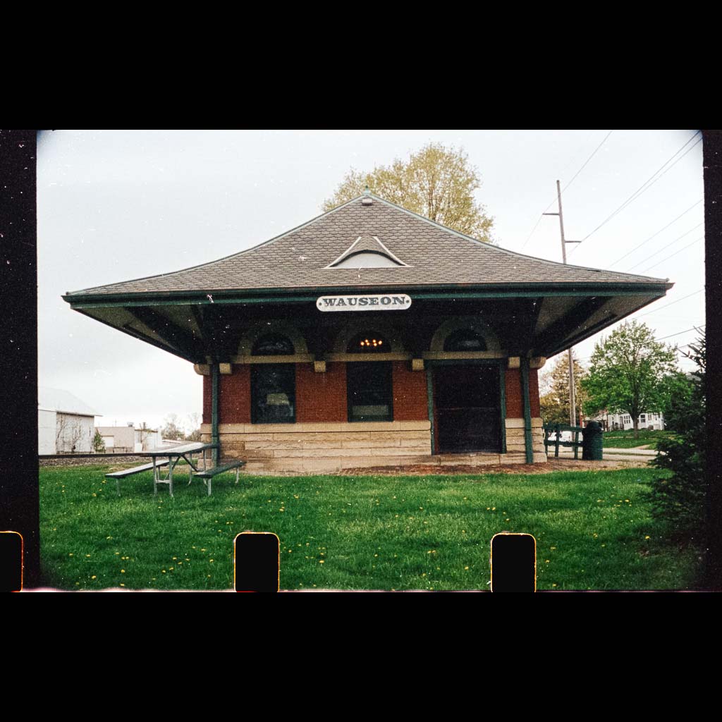

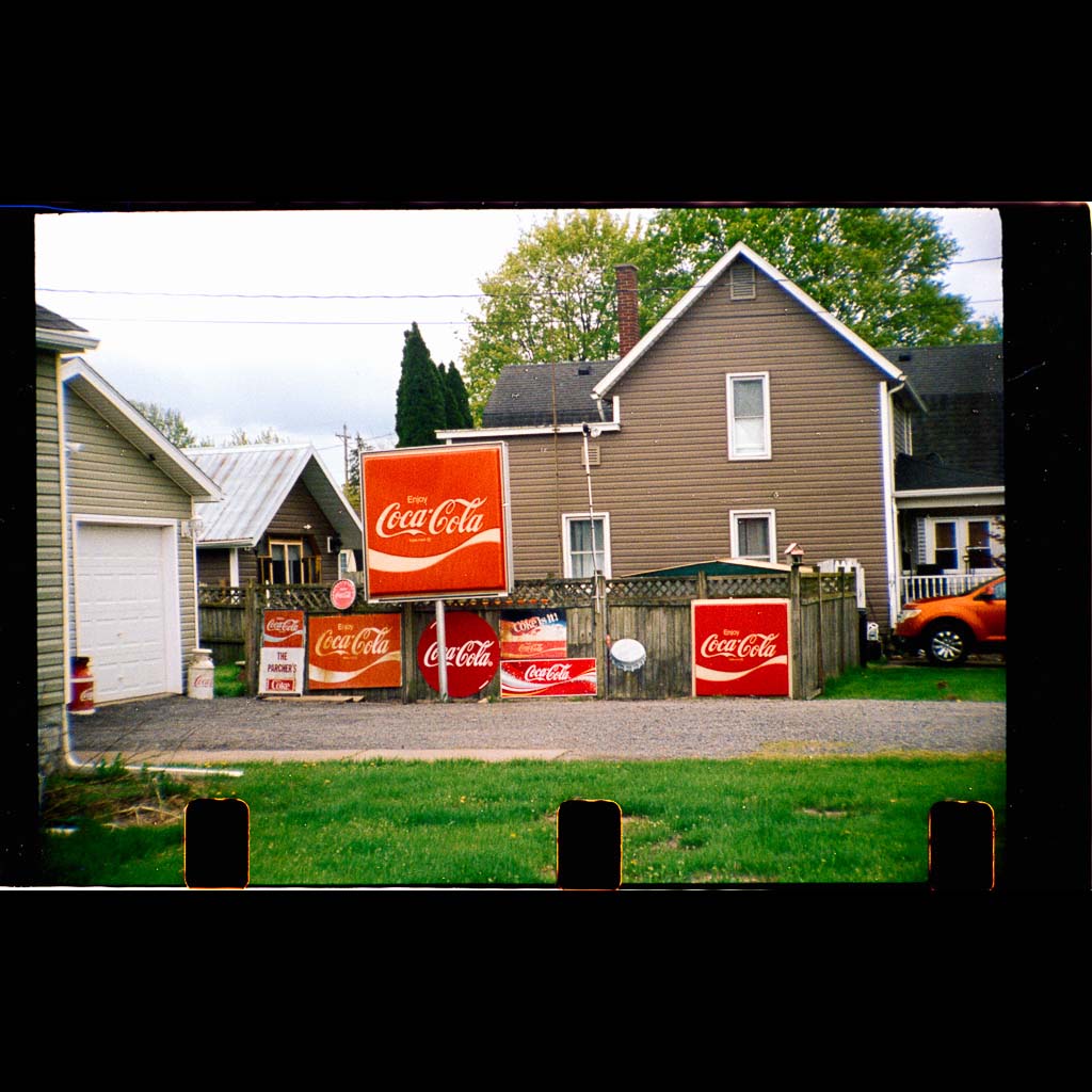

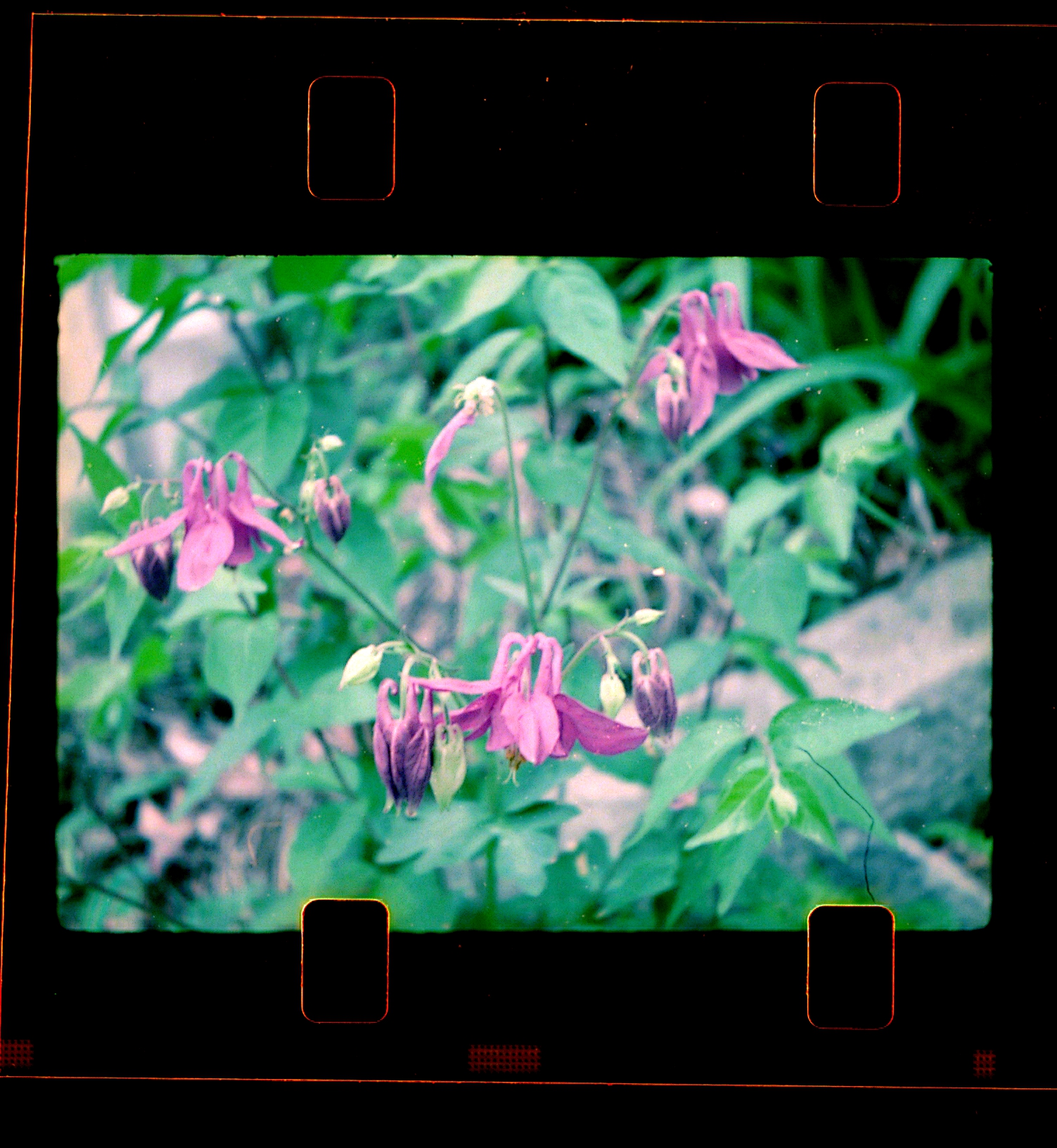

Two pics from my first rolls of reloaded Kodak 110 cart with Vision3 50D 16mm film.
From my Pentax 110 auto super with 18mm & 20-40 zoom. Pushed 1 stop in Kodak flexicolor C41 since slow film on the 110 is 100 asa. Seems I may have a bit of remjet spotting which needs better cleaning.
A superlative example of top 110 gear paired with a modern film emulsion. I've lost a couple 110 reloads recently due to the lack of light tightness in a camera body (not a pentax 110). Was the cassette or camera sealed any more than usual? I've got some un-perfed 50D on hand but the only 110 camera that will handle it is a Canon 110 ED (20).
Major remjet contamination is more 'smudgy' than spotty in my experience but digitization with an infrared channel / Digital ICE would handle the spotting in the first frame quite well.

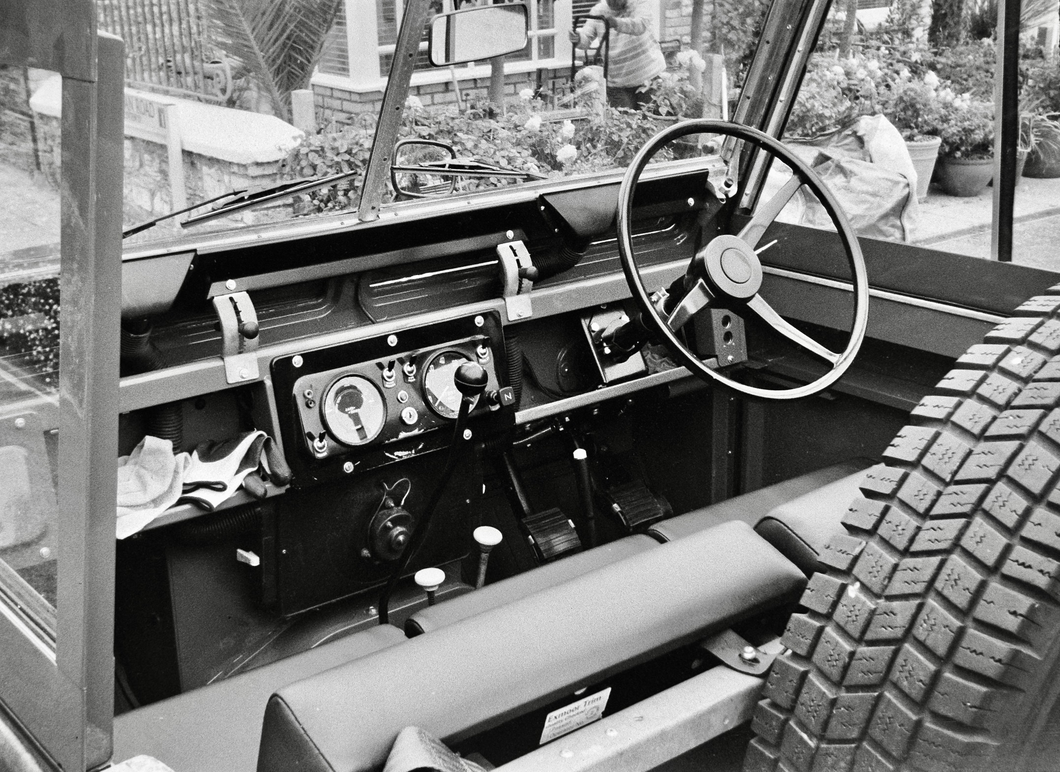

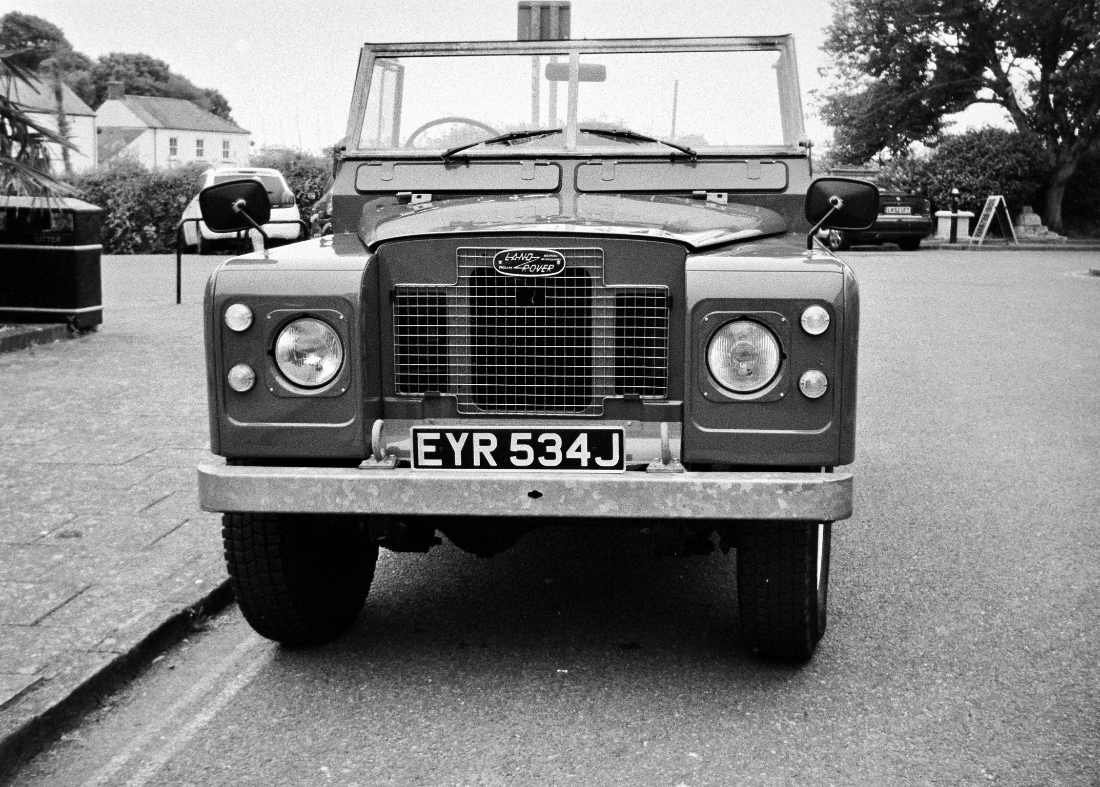

The steering wheel is on the wrong side and the dashboard speedometer, gages and controls are in the middle!
No, the steering wheel is on the correct side. I used to have a job where I traveled to mainland Europe I hated changing gear with my right hand and driving on the wrong side of the road. I blame Henry Ford. The vehicle was “J” registration, which means in was registered between August the 1st 1970 and July the 31st 1971.

Land Rover from view. Minox EC, ADOX HR-50.
It has nothing to do with Henry Ford. Prior to the American Revolution, from the first colony, North and South Americans had it correct by staying to the right on the roads.
I didn’t realise that. The original reason, I believe, was so that you could draw your sword with your right hand, if you were approaching someone aggressive coming towards you. When I was at school, we had to walk on the left along corridors.
It dates to a law passed by the City of London when crossing London Bridge. I do not have a quick reference on that. It was supposed to prevent sword play but when drafted it mistaken was written that when north bound on was to have be on the upstream side, when it should have said when north bound on was to have be on the downstream side. No one bothered to check the wording and the wrong side was passed. In the rest of the world the convention was to keep the swords on the outsides of the thoroughfare.
