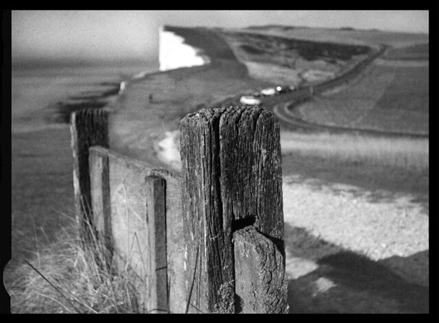

I did a lot of research when I was looking to get into 110, and picked the Rollei A110 and the Pentax Auto 110 as having the best lenses. All the pics I have posted on this thread have been taken by those two cameras.
Out of the Rollei and the Pentax, I favor the Rollei only because it has that spy camera vibe and I prefer the zone focusing w symbols in the VF instead of using a split image screen which for me just seems to take longer as I keep adjusting it to get the “best” focus. The Pentax is easier to advance the film with the 2stroke wind lever compared to the Rollei which is a one time push pull action with a slippery body!

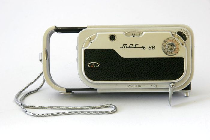

Anyone shot the MEC 16 SB?
I have two of them, but I’ve never gotten around to procuring some suitable film for them.
On paper they look like possibly the greatest 16mm still camera ever.
f2 6 element Heligon. 30mm min focus. 1000th of a second max shutter. TTL selenium metering.
It’s quite hard to find example shots online, done with fine grain film and scanned well.
I’d think it would shine with Ektachrome and… yeah, what fine grained black and white film is actually available in 16mm?
Apart from Foma that is.
The build in filter slot and the fast lens begs for shooting IR. Any kind of Aviphot like film available in 16mm?
Yes I have used this camera, and yes, it's the best that I know of. You need the 2 cassettes, they are Identical. The camera needs perforations for film advance. You can use single perf film if the perfs are towards the bottom of the camera, the camera opens from the bottom and lies on its top if taken out. The film is easy to load, but try to limit yourself to 16 or 20 exposures. Longer film strips may jam.
Have a look at my page in case of... https://www.subcompactcam.com/16mm_mec_16_sb.htm
No photos taken with the camera?
I have a bunch of cassettes, so no problem there.
Do you know of any good example photos?
What film do you use?
Does it take single perf?

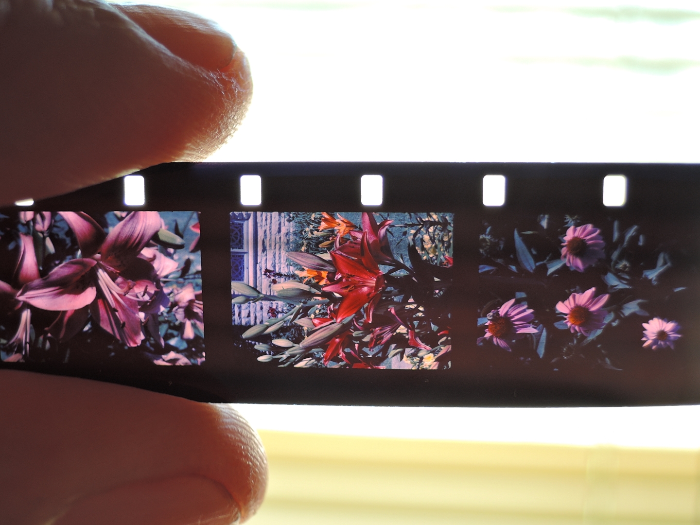

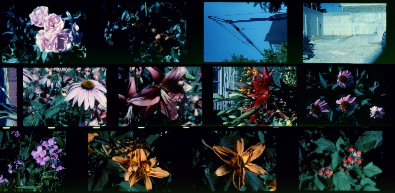

Mamiya 16 De Luxe (1/200s @ f16)
Vision 3 500T unfiltered daylight, E-6 style color reversal; D-19 1st developer, ECP-2 2nd/color developer
Uncorrected positive scan
Uhhhh.... I'm a bit stunned by this TBH. The positives are still too blue even through the ECN-2 integral orange mask. If you filter for daylight (or shoot daylight balanced stock) this process probably produces balanced positives through the integral mask 😲

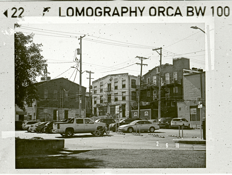

Pinholes galore from Orca 100 this time; the first through a Canon 110ED 20. It might just be this camera, but I had to destroy the cartridge to get the film onto a reel. The film advance ratchets the spool so tightly (or something) I was unable to withdrawal the film from the take-up chamber.
Pyrocat-MC 1+1+100 12'
Mamiya 16 De Luxe
Vision3 processed in this way seems to behave like a slide film with very durable highlights, although these frames are mostly underexposed. The scans don't really do justice to how these look in person. You'd never know there was an orange mask in the film. It's no ektachrome, but damn is it close.
Mamiya 16 De Luxe
Love those "chromes"!
