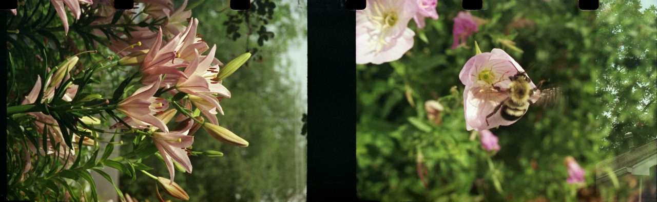

Had another go with the Minolta 16 Mk II, this time with some 500T. I did a single extra advance between exposures which led to inconsistent frame spacing, but its a nice effect if you know its there.
Vision3 500T in 110 cassette (100 ISO, -2 exposure comp)
ECN-2
W/ 85B

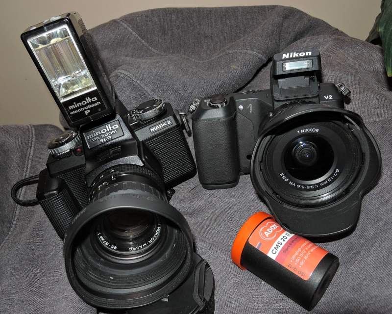

Pictured via 8x6mm sensor: the previously featured Minolta Mk II and its mirrorless doppelganger, the Nikon V2. The format and ergonomics are strikingly similar but they're very different cameras under the hood.

Plants shots are incredible!
Blame the Vision3.... you could take photos of mummified dog turds and still get extremely characteristic, if not amazing, images.

The 500T i shoot in 35mm doesn't look that good...
Hmmm... oughta troubleshoot. I'm using unexpired/fresh film developed in Kodak's formula for ECN-2. Results in 35mm (or half-frame) are similarly cinematic.

I don't develop in ECN-2 and who knows when my film is from. 250 and 50 never seem to have issues but the 500T is quite grainy. I just have to source some fresh stuff in 16mm for my cameras.
I don't know that I've ever actually processed Vision3 stocks (other than 2254, if that counts) in C-41. The color developer is more active than the one used in ECN-2 which accounts for the boosted contrast and other differences (grain?) you see when cross processing.
This is marginally off-topic, but on a whim I tried a reversal cross-process on some 35mm 500T a couple of weeks ago. Badly underexposed for reversal, weak 1st development, and using ECP-2 as the 2nd (color) developer. Super dense 'positives' but I still managed to claw one keeper out of it in post-processing. I might make another attempt in 16mm while actually exposing correctly for reversal.

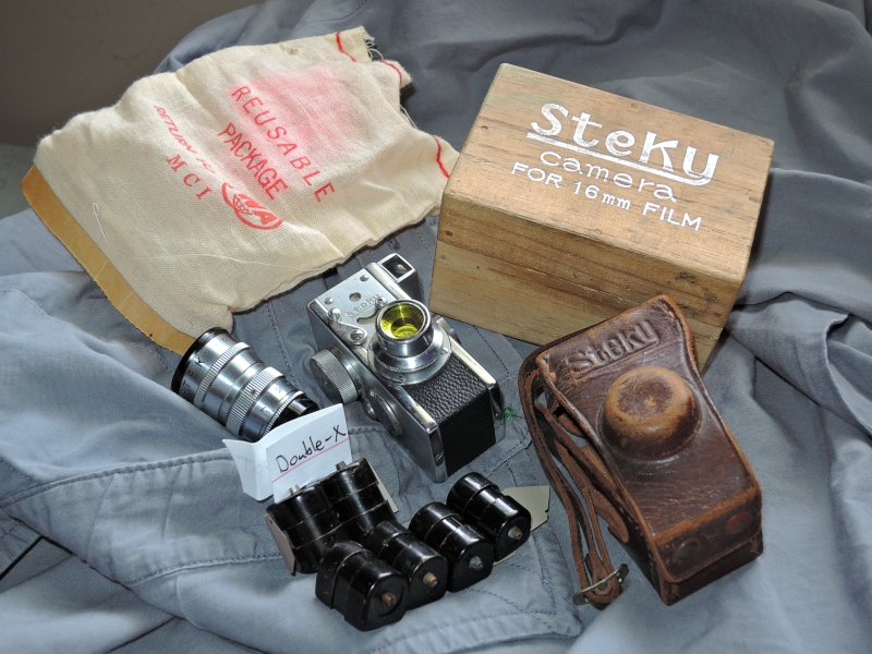

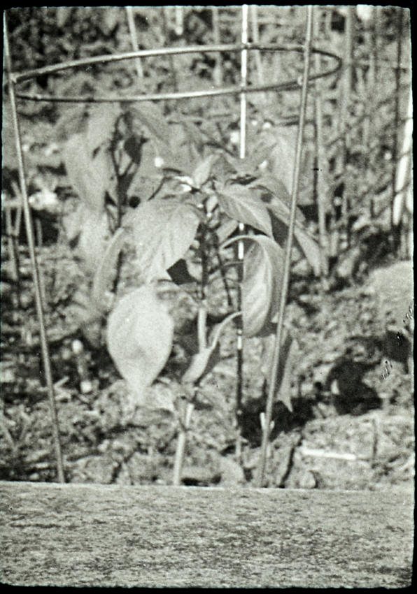

It's probably the oldest camera I own come to think of it; fully functional shutter (B/25/50/100) and film advance. The frame counter reset is broken (or I can't figure out how to use it) but doesn't impact shooting.
Very difficult to keep steady for handheld use due to the lever-style actuation of the self-cocking shutter. Closest focus of the 25cm lens at f16 is just over 2 meters (~7ft).
Steky Model II (ca. 1950?); fixed-focus 25mm 1/100s f/11, yellow filter
Double-X (10x14mm); D-19 reversal 7'
Steky Model II (ca. 1950?); 40mm f5.6
Double-X (10x14mm); D-76 1+2 11'
'Lo-fi' might be an understatement... gotta try some color with this thing sometime.
