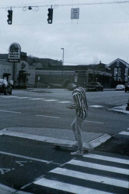

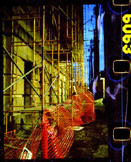

Mg-s 250D f2.8 @ 1/30s in unnatural light, processed ECN-2 N+0. Hastily wet scanned on a V800 w/ auto-adjustments and manual black point. 2-3 stops underexposed judging from the negative.
Spot the remjet clouds...
Do you rub your fingers on the film after the fix? I find the REMJET needs the be manually rubbed off.
I generally don't perform a pre-wash and remove the entirety of the remjet from the film base after the stop bath and prior to bleaching & fixing, in a tray. Those marks (purple-ish 'clouds' on the right of the frame) are from the base side of the film touching the emulsion side as I remove it from the reel. Usually I can avoid it, but it is quite tricky to get out of the emulsion when it happens. The same applies to 35mm Vision3 except its about 4x as filthy per frame.
I find any attempts to remove it in-situ via washing on the reel introduces a remjet 'snow' into the emulsion, still requires manual intervention for complete removal prior to bleach&fix to avoid contamination, and while it can 'fixed' by digital ICE scanning, seriously degrades the image quality. Using the official pre-wash formula and/or moving a wash to after the stop might be something to try but I'm not that fussed about it. It was meant to be removed by a purpose-built machine anyway... a real 1st world photographer's problem :D

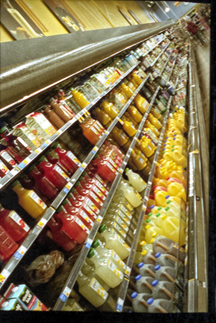

1/60s shutter priority under artificial daylight, haphazardly dry scanned by wedging the unflattened film into one side of a 35mm holder. And Tri-x 7266 in D-19 reversal, digitized with a D850 with a reverse mounted nikkor 24mm af-d. There's a hotspot present due to insufficient masking of the postive.
