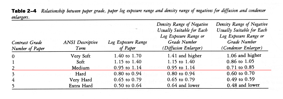

However, since everyone thinks but never tests that a 10 stop range actually fits grade 2 they never get what they think they will get and that will lead to claims of zone system inaccuracy or being wrong. It is and it isn't depending on how you go about it.
A ten stop range isn't considered normal, so it won't fit on a grade 2 paper if it is developed to what is considered normal contrast. Don't know where the assumption that normal luminance range is 10 stops comes from. It might be coming from the print having 10 print zones. I've already approached this question in two different ways, posts 77 & 82. To summarize, the basic scene luminance range is 7 1/3 stops.

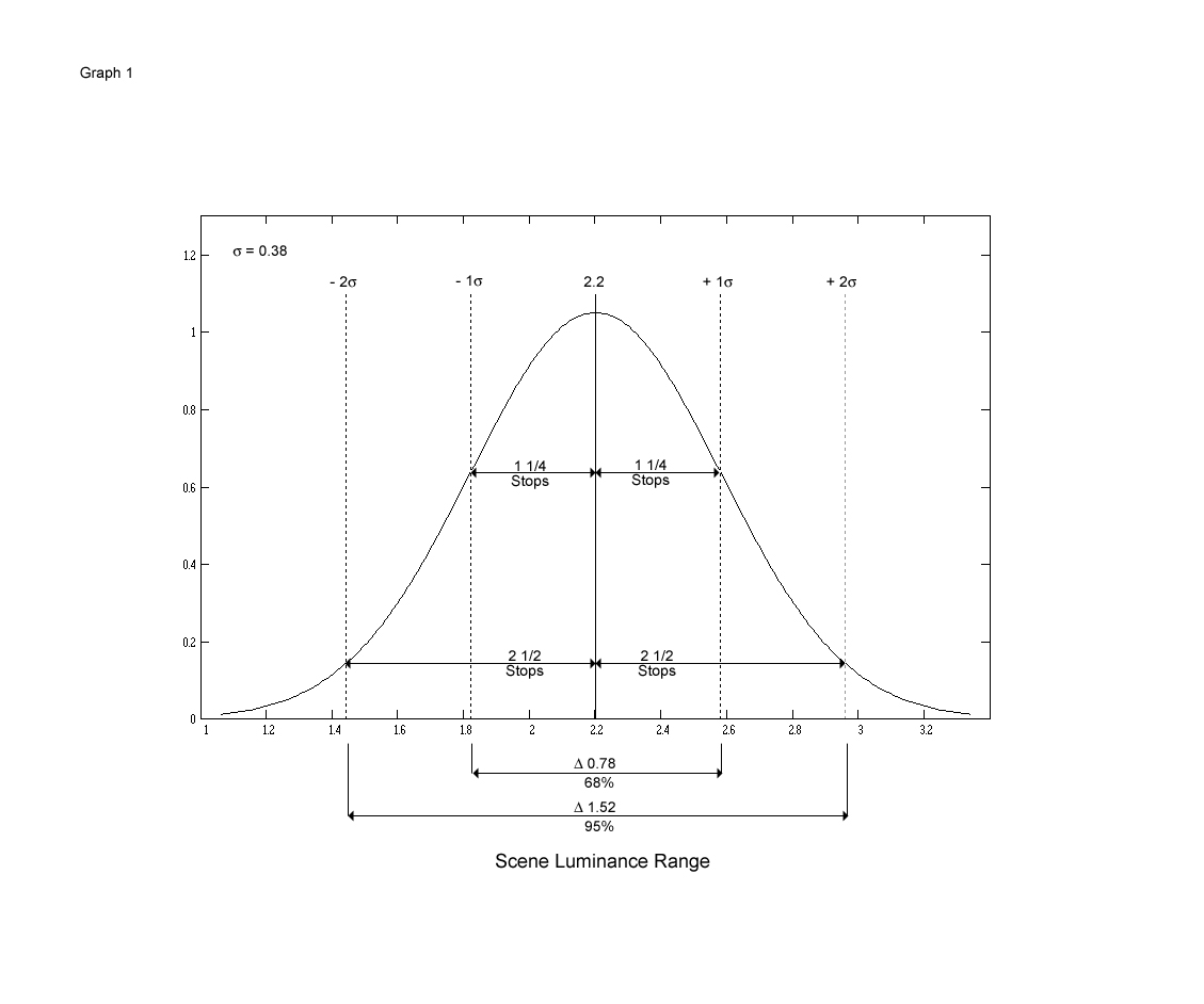

The range is based on the deepest shadow in which detail is visible and the brightest diffuse highlights. The normal range is from a 100% relative reflectance to 0.63% relative reflectance. Accent black and specular reflections are not part of the calculation.
The idea is to fit the NDR of the film onto the paper. The paper's log exposure range is determined from two points that aren't at the paper's D-max or D-min. The idea is to place the deepest shadow in which detail is visible and the brightest diffuse highlights within these two points. The more extreme values will fall outside this range. You do not want to place accent shadow or specular reflections within these two points.
If the scene has a greater luminance range than 7 1/3 stops, then the development needs to be adjusted in order for the negative to fit on a grade 2 paper or a different paper grade is required.
There is an equation: Aim Paper LER (also NDR) / (log subject luminance range - flare) = aim contrast index. Kodak uses an CI of 0.58 for Normal. They consider the LER for a grade 2 paper to be 1.05 and flare to equal 0.40. The average subject luminance range is then (NDR + CI*Flare) / CI = LSLR or (1.05 = (.58*.40)) / .58 = 2.20 or 7 1/3 stops.
A ten stop scene luminance range would require a CI of 0.43 (flare generally increases 1/3 stop per stop luminance range). Using a a fixed flare value of 0.40 would result in a CI of 0.40.
What would be the resulting NDR if a 10 stop subject luminance range was processed at a normal CI of 0.58? 1.51 What paper grade would that most likely fit on?
