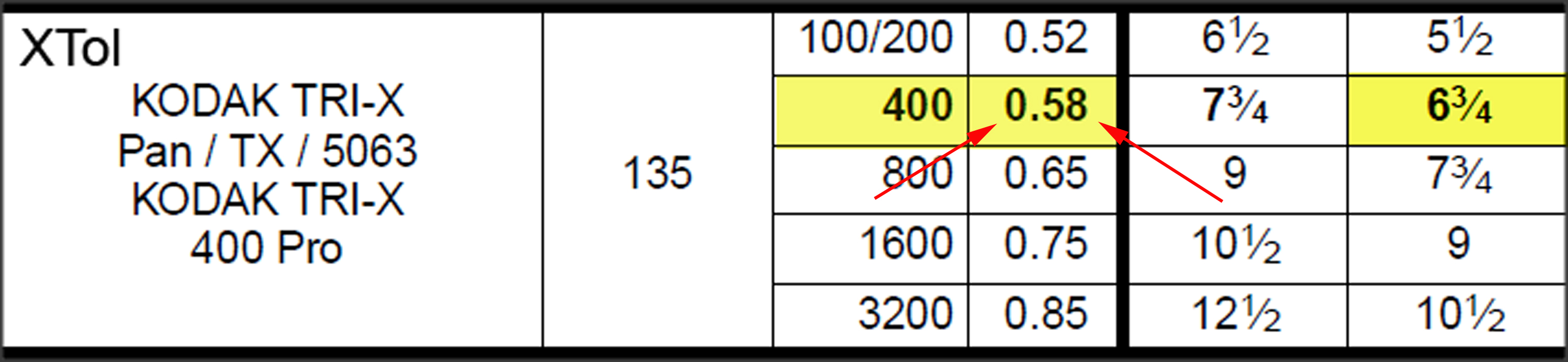

Unless someone gives you a 0.1logd frame for comparison, I don't think someone can guess it without knowing. A light meter is already included in the description. A densitometer is a light meter.
your assumption is that you must target a specific density. I say you do not need to target a specific density value by measurement, you just need to know where it will roughly be visually and you visually aim for what you want which is illustrated in Adams zone patches. If you can achieve that easily then thats all you need. There is no need to cling to target numbers.
when you print anything its a visual exercise based on instincts and perception so why can't judging a negative density be exactly the same especially when you have fb+fog film rebate as a side by side reference which makes it blindingly easy. I don't mean to get exactly some target value, I mean close enough that it works and you prove it works by printing the zone patches so you can see if its worked or not.
