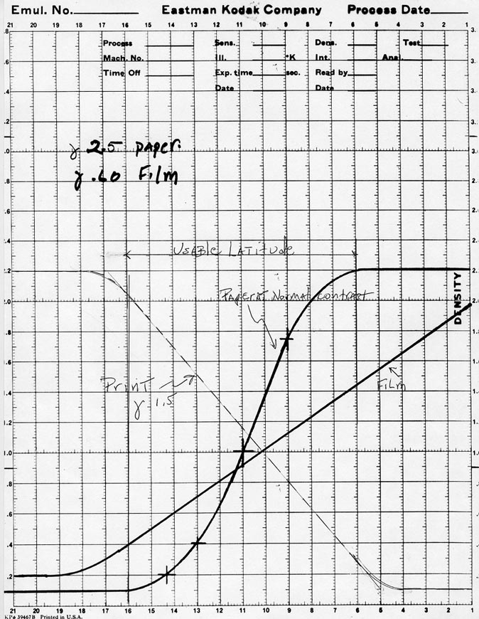

You cannot fit the entire range of a negative film onto a print.
You might get 5 or 6 stops if you are lucky. If you use a paper with a soft toe and shoulder you might add another stop again if you are lucky.
See attached. Negative film on grade 2 paper. The negative film goes off the paper on the right headed for 3.0 which is the usual standard Dmax.

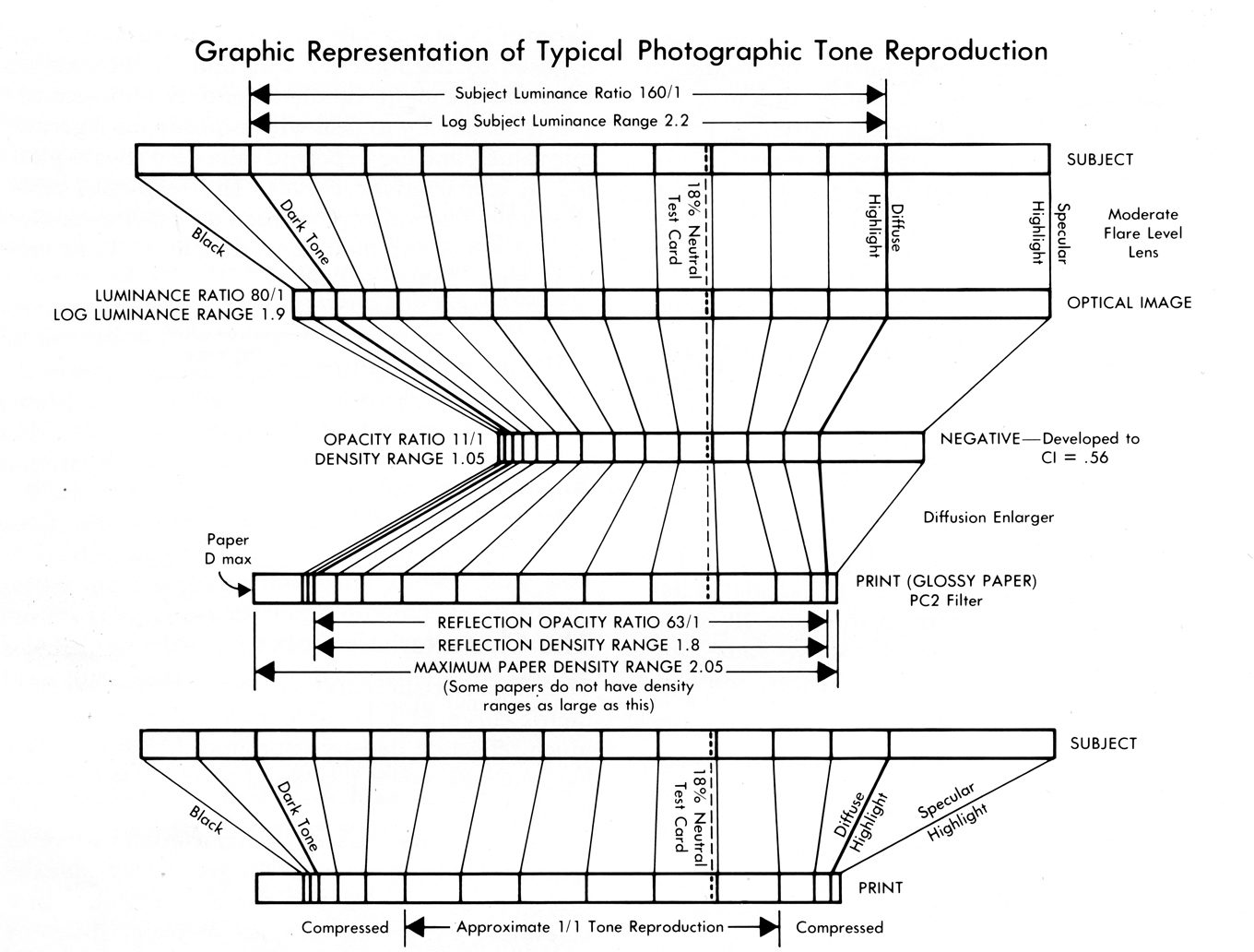

From a Kodak publication. The answer is in there.
The 1.25-1.35 density range from The Negative is an entirely different story. Check out what the negative density range is in the Kodak diagram for starters.

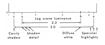

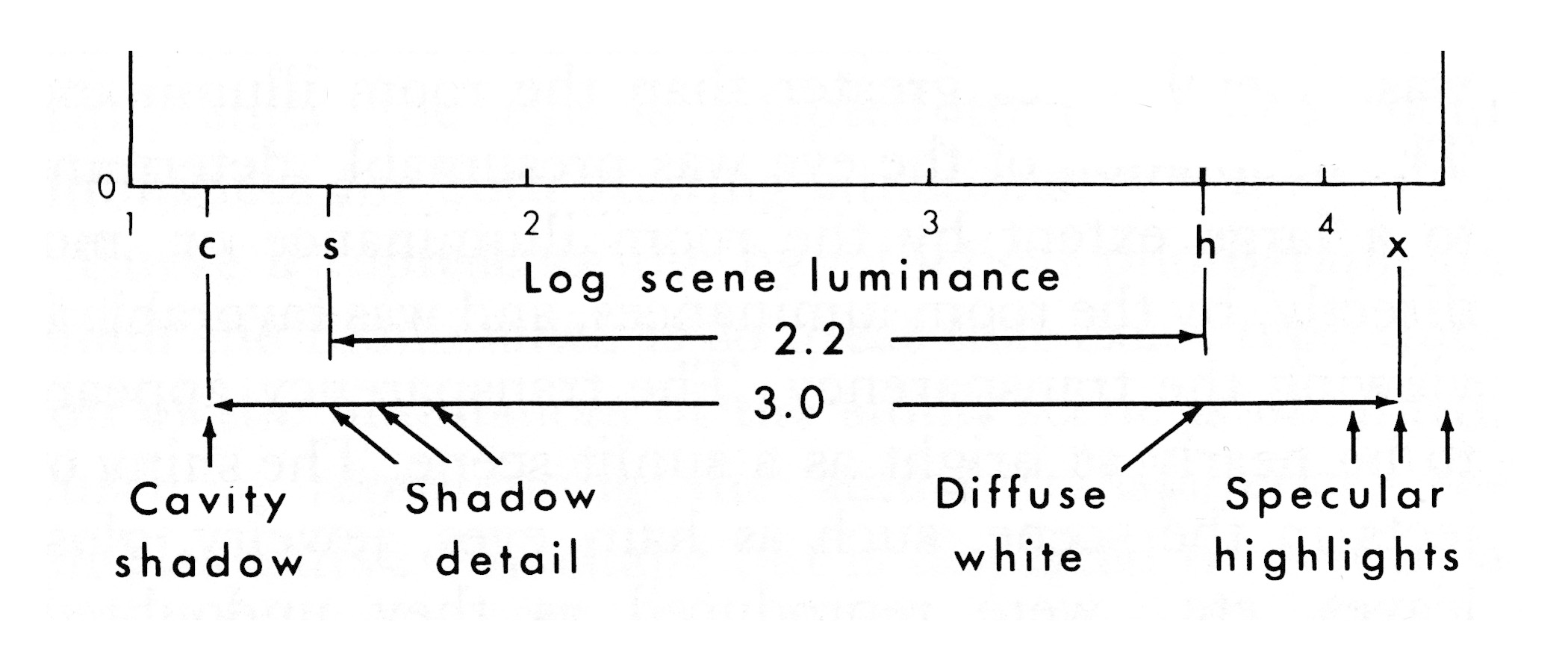

From The Theory of the Photographic Process:
"Small vertical arrows have been drawn at the bottom of Figure 22.2 to show the log luminance of some of the specular or, more properly, semispecular highlights with respect to a diffuse white highlights of the scene. Additional arrows would have to be drawn further to the right, beyond the limits of the graph., if the log luminances of the more intense specular highlights were to be indicated. The image of the sun reflected in shiny metal surfaces has a luminance more than one hundred million times greater than that of a diffuse white object. Experience with the use of transparencies to reproduce the appearance of the specular and semispecular highlights in relation to the other areas areas of the scene seems to prove that it is satisfactory to increase the luminance of the reproduction of a diffuse white object. Consequently, in Figure 22.2 the density difference obtained in reproducing the absicca points h and x should be 0.2 to 0.3 or slightly greater, if the transparency is to viewed with optimum lighting conditions.
Small vertical arrows have also been drawn at the bottom of Figure 22.2 to show the log luminance of shadow areas. The nominal shadow point is the point, s, which is the deepest shadow in which detail is visible in viewing the scene. To the left of s is the point, c, representing one of many small areas that can be called cavity shadows. They are deep crevices in tree trunks or between folds in dark clothing, shadows deep in bushes, or other small dark recesses in which no detail is discerible. Their log luminance values will sometimes fall far to the left of point c. Whether they are reproducing properly or not in a photograph is often of little importance.
The problem of deciding how to define log luminance range of the scene, for tone-reproduction studies, is usually solved arbitrarily by taking the log luminance interval between the deepest shadow in which detail is visible and the brightest diffuse highlight. Whenever this definition is adopted, however, it should be recognized that important semispecular and specular highlights and probably less-important shadows usually lie outside the log luminance range indicated."
