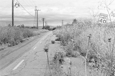

Here are a few shots from my Exakta VX witn CZJ 58mm f2 Biotar. It can be a little low on contrast, but not terrible. The lens has some light haze in it also. I would not blame the lens design.
I did bump up contrast on this one, and sacrificed some shadow in post (Arista Premium 200 aka Plus-X)

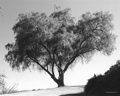

Shimmering Tree
by Mark Wyatt, on Flickr

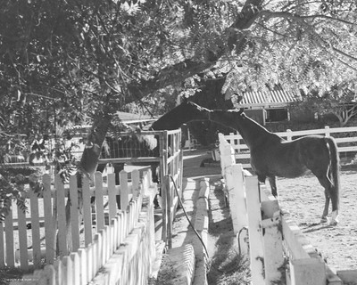

Low contrast lighting, FP4+/Rodinal (not a low contrast combo)
Over Run
Arista Premium 100 again (same roll and development). I guessed at the exposure to not miss the action, and it is definitely underexposed maybe 2 stops. Some of your shots look like this.

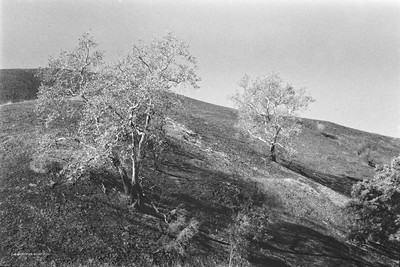

Fomapan 200 in Rodinal
Firescape
