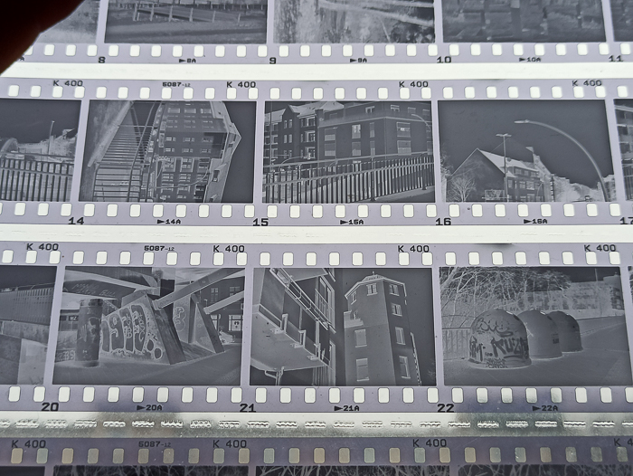

Now, before I show you the negative of the roll I yesterday shot this way, I want to show you first the negatives of the photos I posted at the beginning of this thread, the ones that showed me the difference in contrast (or exposure...) between my Canon fd lens and the Biotar.
Here is the Canon FD in a sunny day.
Here is the same day the Biotar, shot in the wrong mode! In the left upper corner you still can see some shot from the Canon. The difference is noticable, still note sure if that is a difference of contrast or exposure.

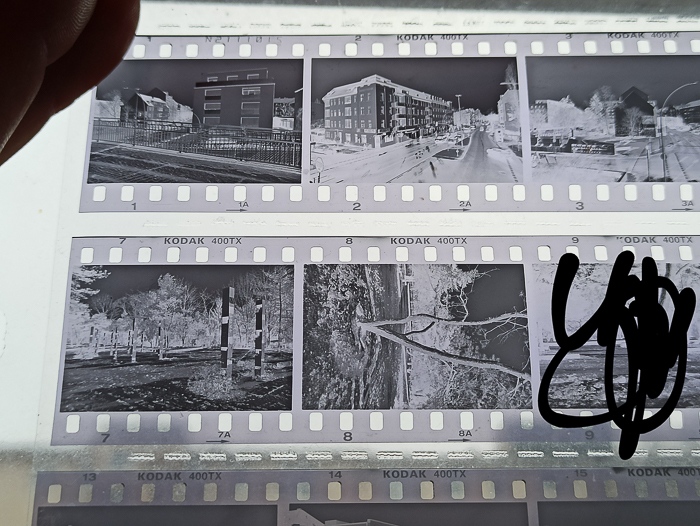

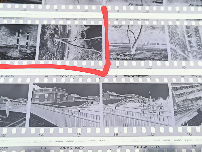

Finally, here are the negatives of the shot taken yesterday with the Zeiss stopped down metering:
what I think is that the photos are well exposed, the negatives are not light neither are they too dark. I think they only lack contrast! May the negative be underdeveloped? I don't think so, the numbers of the film look very dark and black.
So I am happy to see that the problem of the underexposure is solved and that the stopped down metering is effective, but still, something is wrong! I can see from the scans that this lens is good performer in details, but the dynamic range of this negative is very short. I got no whites I got no blacks.
Thoughts?
