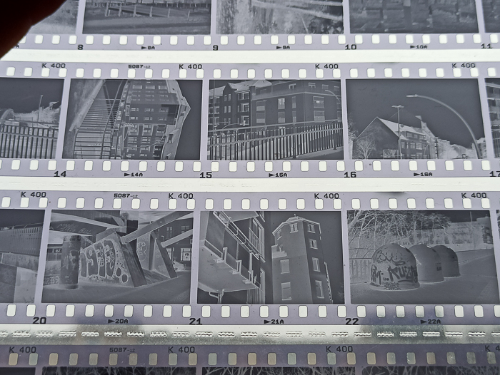

Finally, here are the negatives of the shot taken yesterday with the Zeiss stopped down metering:
what I think is that the photos are well exposed, the negatives are not light neither are they too dark. I think they only lack contrast! May the negative be underdeveloped? I don't think so, the numbers of the film look very dark and black.
So I am happy to see that the problem of the underexposure is solved and that the stopped down metering is effective, but still, something is wrong! I can see from the scans that this lens is good performer in details, but the dynamic range of this negative is very short. I got no whites I got no blacks.
Thoughts?

You switched films - Tri-X to Kentmere 400 - and the new film was developed to give what appears to be lower contrast. If the development were to change in order to match the contrast of Tri-X exposed using the Canon lenses, then the results would be similar.
You will probably find that if you use the FD lens with the Kentmere film, and develop the film the same way as the Kentmere negatives you showed us, then those negatives will also be lower in contrast.
That being said, I'd be willing to bet that the Kentmere 400 negatives will be quite usable. To my mind, they actually look more easy to print than the Tri-X negatives exposed with the Canon FD lens.
I think they are well exposed now, before they defenetely were underexposed, but still I think they lack contrast,
I think so too.
You have done a good job narrowing it down. You can develop a little longer to increase contrast in the negatives next time but with the good exposure now things are definitely better. You can get something out of this roll.

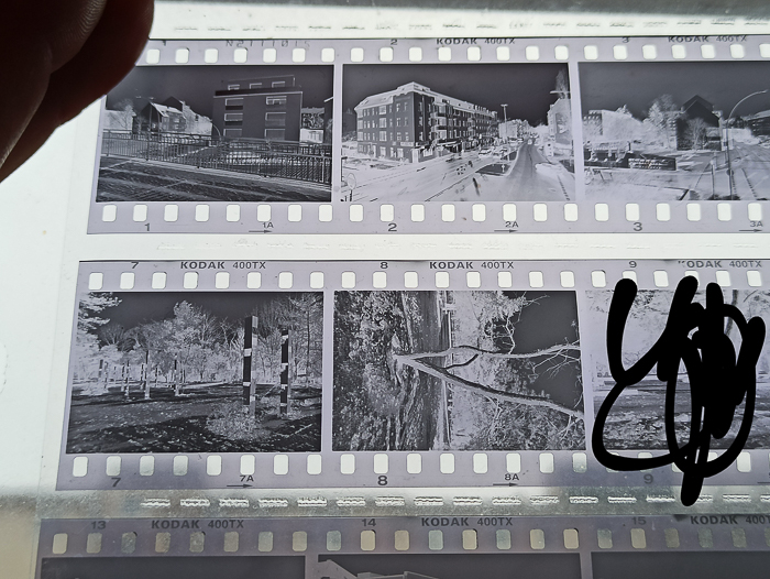

Thanks for posting pictures of the negatives, that helps.
Look at the negatives shot with the Canon FD lens, the sky areas are really dark on the negative.
The sky areas on all of the other negatives with the other lenses are a sort of medium gray.
In the second example, the underexposed roll on Tri-X, there are a lot of very thin areas, for example the background behind the V-shaped tree, or the railing running diagonally across the picture. These are going to look very blah on a positive unless you let the shadows all go completely black.
In the third example on Kentmere, there are fewer really thin areas except for deep shadows. But the sky is still medium gray. It's almost the same tone as the buildings. I don't know if this is a lens, exposure, or development problem. I don't think it's the lens, though.
I would suggest 1) figuring out how to be absolutely sure you are operating the aperture correctly (because full manual and preset lenses are a little different). Look through the lens to be sure f/5.6 is really 5.6. Then 2) do a controlled test. Go out with both lenses, meter a scene through the FD lens at some aperture, say f/5.6 and 1/125 or whatever, take a picture, then put on the Biotar and take the same picture at the exact same settings (don't use auto, use manual so you get the exact same exposure), then do the Helios at the same settings. It's impossible to isolate the variables when you have different lenses at different times on different rolls of film.
