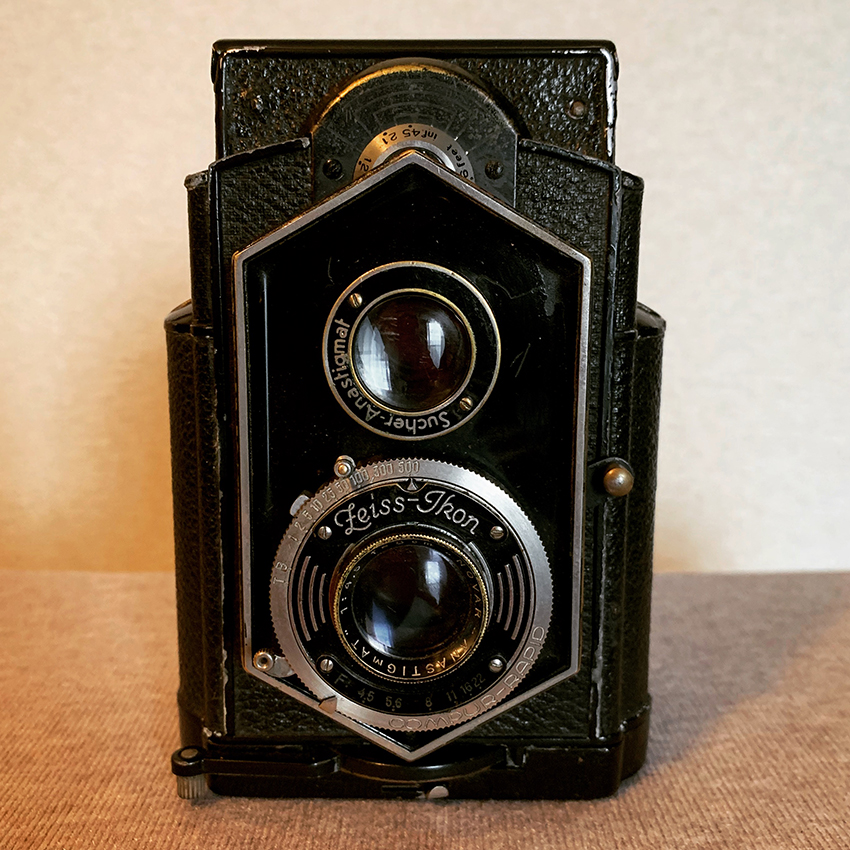

I've always been interested in unusual or beautifully designed cameras, especially TLRs, and the Zeiss Ikon Ikoflex coffee can has been on my list for some time. Over the years I found it hard to find one that was in working condition, with a decent (but not collectable) appearance, and that wasn't too expensive. But, a few weeks ago I was lucky in finally finding one and it arrived yesterday. Everything looks good, the glass is clean, the shutter speeds sound accurate, I've downloaded the manual, and it just need to give it a quick clean before going out later today and testing it.
However, I've noticed that it's hard to find any good, detailed information about the camera. The same 2 or 3 information sites get mentioned on Google and various websites/blogs but it tends to repeat itself. For example, this site and this site shows two examples of the camera: the 850/16 version 1 and version 2. If you look at the taking lens, they both say "IKOFLEX ZEISS IKON" or "ZEISS IKON IKOFLEX". A slightly different version can be seen here. More information about the Ikoflex can be found here. In any event, none of these cameras are the camera that I got, which looks like this:
As you can see, around the taking lens it just says "Zeiss Ikon" in a script font, with no "Ikoflex" mentioned. It's a 80mm Novar 4.5 lens with a Compur-Rapid Shutter. It has a much wider range of speeds than listed for other versions - T, B, 1, 2, 5, 10, 25, 50, 100, 300, and 500. However, if I want to use a shutter speed higher than 10 or 25, I have to press a little lever in order to move the ring to the higher speeds. In any event, this particular version shows up in google image searches, but not on any specific site that talks about the cameras. I'm assuming it's a later model? Does anyone know? The serial number is the the 4,000,000 range, which does not match up with other numbers I have found.
These cameras did have some accessories - a yellow filter, close-up filters, and a lens hood. I don't really care about the filters as I can handhold one in front of the lens if needed, but the lens hood would be particularly useful I think. I haven't been able to find any, which I guess is not unusual, but if anyone knows of where I might get one, that would be great. The lens is quite small - about 25mm, and there is no filter thread. Would a lens hood that fit the other Ikoflex models fit?
Finally, these cameras can take both 120 and 620 film, and the there are two film counters - one on each side of the camera - for the various sizes. The manual talks about metal and wooden film spools - would I be correct in assuming the wooden spools refer to 620 film and the metal ones to 120 film? Based on the history of these film sizes, that's what makes sense to me, but it's not clear in the manual (just assumed I guess).
Anyway, I'd appreciate any information people have about this camera.

Why do they call it a coffee-can camera? Folgers never came in something that looks like that -- which, I hasten to add, is very cool.
I would have to see the back, but I bet it has multiple windows to allow use of film that only has backing paper showing 8 exposures -- so you use 1 in the top window, then in the bottom window, then 2 in the middle window, or something like that.
It may also have a single window in the center for rolls with 12 numbers. I've got a camera that has this transitional configuration, a Balda. Here's a shot of the back ... look familiar?
Better practice with a sacrifice roll before using.

What are the lens serial numbers?
A Lens Collectors Vade Mecum shows Zeiss East Germany 4000000 as 1955; Zeiss West Germany 1965.
Compur Rapid shutters with a top speed of 1/300 are late 1930's to early 1940's; the next advance was the top speed 1/500 then with flash sync then the Synchro Compur.
The shutter should have a serial number but may have to be removed from the camera to see it.

Your coffee can has a much nicer shutter than the Derval with speeds of 1/25, 1/50, 1/100 and B only on mine. Lens is a Novar 80mm 4.5.
The serial number is stamped on the back of the main camera body casing and becomes visible when the film chamber assembly is removed. In my case the camera is a model II with body serial number Y15813.
Does your camera have the Mayan temple stepped WLF? if so, your's is a model I. This is the feature which caps of the art deco look.
Somewhere on the web is information giving approximate year of manufacture using the numerical prefix of the body serial number.

Thanks! I found the number (I think): Y38075 (the last two numbers are a bit iffy, but I think they are 7 and 5). It's a much higher number than yours, and that, combined with the greater range of speeds, makes me think it's a later model that no one seems to know much about (It also does not have the classic stepped WLF - I am still keeping an eye out for one those!). Maybe it was created for a different market? Special edition? I wish I knew German, I have a feeling I would maybe be able to find more information about it. It's too bad it doesn't have the same brand loyalty that the Rolleiflex has - with lots of websites and forums telling you everything you need to know about every model, every serial number, every variation...

One more question - what would be the best way to get my f/stop numbers to be lighter and easier to read? If you look at the photo I posted, you can see the numbers right below the taking lens - clearly whatever paint was there has mostly rubbed off over the years. I'd like to find a way to lighten them up without ruining the aesthetics of the camera.
JPD
Mar 24, 2007
2,155
Sweden
Clean the numbers with alcohol and fill them in with oil pastel (the crayon type), or try using acrylic paint tihiined with water - brush on and wipe off the excess paint.

What is the View Lens serial number?
Classic Zeiss Jena serial numbers:
400,000's 1921-1923
4,000,000's mid 1950's.
1929 shown as the change to Compur Rim set shutters, about serial number 97,091. The Compur Rapid is a rim set shutter.,
125,883 1st Contax lens, 1931.
1,890,000 switch to chrome finish, 1936.
Compur Shutter Serial numbers: http://camera-wiki.org/wiki/Compur_serial_numbers
A 4,000,000 Compur shutter serial number will fall in late 1936 to early 1937 which sounds period correct for the camera.

Further research finds that Z-I body serial numbers with the Y prefix are from 1933-34 which jibes with the serial your Compur shutter.

The Y serial numbers are 1934-35. The lens has no serial number that I can see - it is a Novar so any serial number will not be a Carl Zeiss number. If the quoted 4,000,000 serial number is the shutter serial number, that dates from 1935 to 39. Zeiss Ikon made bodies in batches which they used up over considerable time - the Ikoflexes were not a major seller so the body casting could have been in stock for a year or more. Zeiss Ikon also bought shutters in bulk and the same applies - the shutter might be made 12-18 months before it got used.

Thanks Peltigera! The 4,000,000 number is on the side if the lens, not visible in the picture. I’m currently out of town, so can’t post it. All signs point towards the fact that it was it was made in the mid-30s, I just wish I could information about this particular one - it’s not the versions I or II that get written about.
Pioneer
May 29, 2010
3,878
Elko, Nevada
Everything about your cameras suggests the version II but Lawrence Gubas book on Zeiss and Photography does not even show a front shutter of the style seen in your photograph. The book does mention a model called the 850/16CR that came equipped with the Compur Rapid shutter but it doesn't provide any information other than that. It does mention that the only place that the Ikoflex name is found is on the shutter face. Even the Zeiss Ikon script is different. All the examples I have seen of the Ikoflex coffee can TLR have block letters on the shutter. Yours is in cursive. Just speculating but perhaps your shutter actually comes from a different Zeiss Ikon camera and was mounted as a replacement sometime after it left the factory?

Tubb's book "Zeiss-Ikon Cameras 1926-39" lists the Ikoflex I with a choice between:
Novar 6.3 Derval shutter
Novar 4.5 Derval shutter
Novar 4.5 Klio shutter
Novar 4.5 Compur Rapid shutter
Your camera was the most expensive at 10.2.6 pounds
The f6.3 was priced at 6.12.6 pounds
Book doesn't specify between type 1 or 2 but type 1 has the Mayan stepped WLF.
Incidentally, this is a nicely done and informative Hove book from 1977 which details the offerings
of Contessa-Nettel, Ernemann, Goerz, Ica and Zeiss-Ikon before and after the merger..
