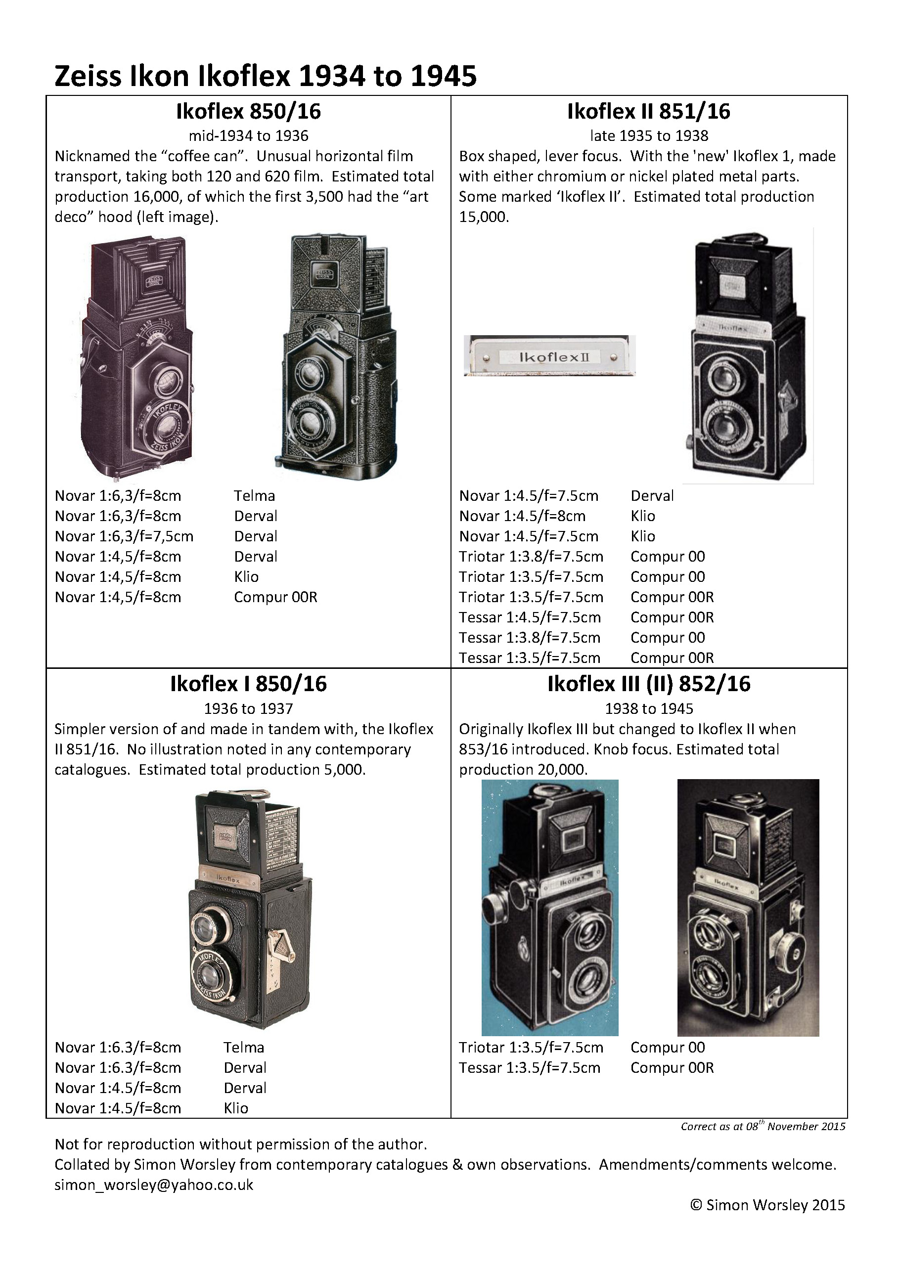

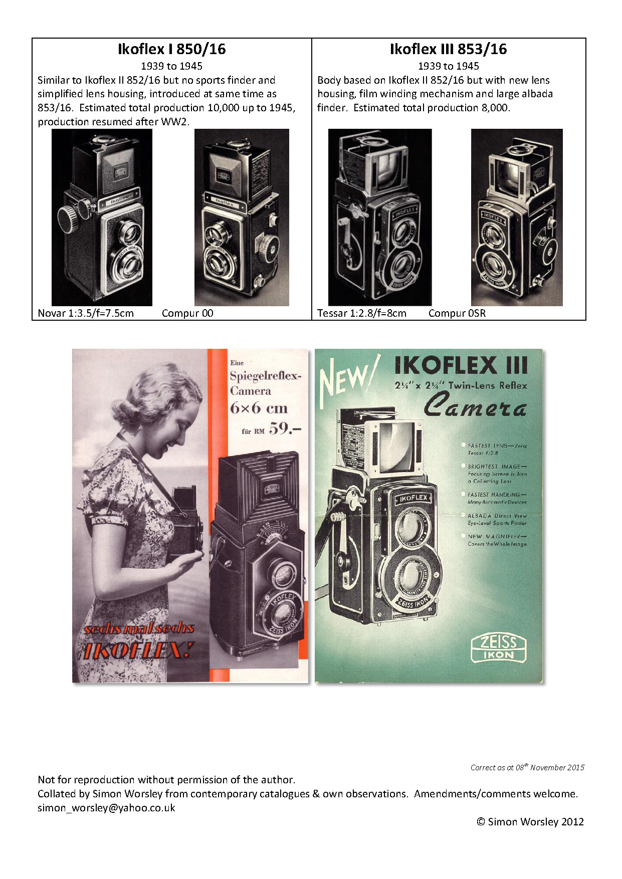

Just stumbled across this website and I hope the attached Ikoflex 'fact sheet' may be of interest (although I should stress that the 'facts' are just my observations over the last few decades of things Zeiss Ikon 1926 to 1945).

What is the View Lens serial number?
Classic Zeiss Jena serial numbers:
400,000's 1921-1923
4,000,000's mid 1950's.
1929 shown as the change to Compur Rim set shutters, about serial number 97,091. The Compur Rapid is a rim set shutter.,
125,883 1st Contax lens, 1931.
1,890,000 switch to chrome finish, 1936.
Compur Shutter Serial numbers: http://camera-wiki.org/wiki/Compur_serial_numbers
A 4,000,000 Compur shutter serial number will fall in late 1936 to early 1937 which sounds period correct for the camera.
There is a degree of confusion regarding Compur shutter serial numbers as there are some unhelpful (although I am sure well intentioned) 'tables' of Compur shutter serial numbers that suggests that they were consecutive (i.e shutter with a serial number of 101 was made straight after the shutter with a serial number of 100), sadly that is not correct as there were a number (I am not sure how many but I suspect at least three) consecutive serial number ranges being used in the 1930s, with Zeiss Ikon equipped with the Compur 00 shutter (top speed 1/300s) having serial number in the 1xxxxxx range and other Zeiss Ikon cameras made about the same time but equipped with the Compur 00R (Compur Rapid) shutters (top speed 1/500s) haveing serial numbers in the 4xxxxxx range (I believe contemporary Kodak cameras used Compur shutters which I had serial numbers starting with a '6', but I cannot confirm that)
