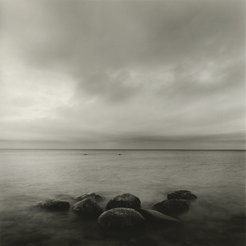

Kodak TMX + Xtol 1+1.
Print on Ilford MGIV in replenished Ethol LPD, untoned.

Why would that be weird?
You would do the reverse if you were using something like Perceptol - not that I would expect you to use Perceptol and TMax 100.
Weird on many levels... firstly because it is somehow expected that by under-exposingTMX I shall l start liking how it looks in XTOL. Since when is under-exposing actually exposing correctly? As far as I know, TMX is a Iso 80 film... so what would be the correct Iso for xtol, iso 100? Iso 160? 125 or 200?
Weird because for a few people it seems unacceptable that someone would not like this particular combo... crazy fine grain is not everything.

I think what's happened is that you've been caught out by Xtol's safety mechanisms - it has higher shadow speed, a somewhat shorter (with some emulsions) straight line than D-76 etc & an often relatively longer softer shoulder/ roll-off. All of these are intended to help make negatives on average more easily printable - not necessarily more absolutely optimal, but more printable across a range of contrasts and metering habits. The same development inhibition effects (a useful characteristic of Phenidones) seem to help improve sharpness as well. In essence, the aim seems to be to achieve a degree of real compensatory behaviour that heads somewhat in the direction of what the DIR/DIAR couplers in XP2 Super are more fully able to do - and which most claimed 'compensating' developers signally aren't doing.
However, if you are coming from a background of developers that are often just-about box speed or slightly under (universal developers, HC-110 & antecedents etc) - and which are low enough in solvency that they don't produce much roll-off - or keep a straight-line into the highlights for longer, the speed differential can be significant enough to have an impact, yet not be immediately obvious - the subsequent reaction to insufficient highlight contrast is usually to bump up the processing, but all that'll do is increase the development inhibition effects & further shorten the straight line & roll the highlights off more - and increased exposure will squeeze you further on to the shoulder. So, if you are used to a fairly vigorous developer without much shouldering/ late shouldering & a slightly low shadow speed, Xtol may be an exercise in extended frustration. Approach it as a speed increasing D-76 evolution with a slightly earlier but somewhat softer shoulder & you might find it more tractable.
PQ/ PA developers can add 1/2-2/3 stop of real shadow speed. If Xtol had been used as the ISO speed defining developer for 100TMX, it might well have ended up as 160TMX instead - and if Ilford had used Microphen for that, we'd probably be talking about Delta 500 - and HP5+ being a 640 speed film. Rating TMX at 80 may be fine with D-76 and your exposure methods - but is clearly excessive with TMX/ Xtol.
