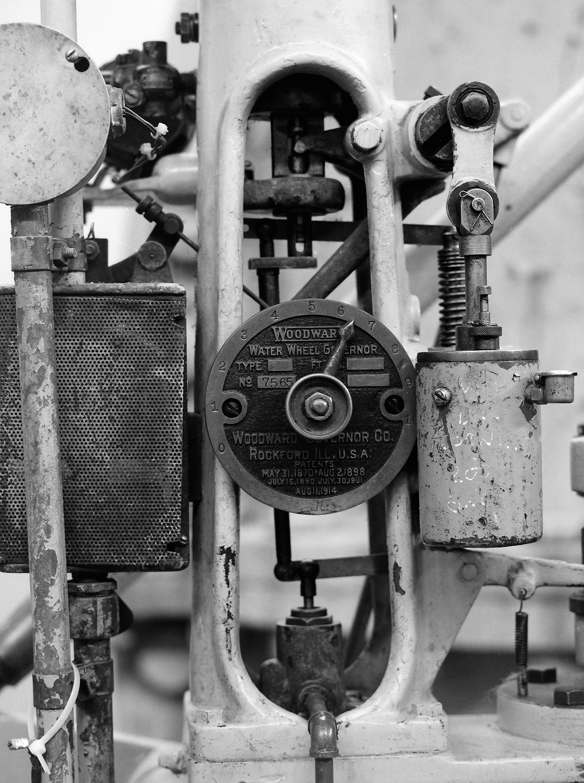

Very nice image. Is that TMX + Xtol?
Yes - replenished X-Tol (development number "38"). It is a scan with faux toning added, but it is pretty close to how I would print it. Not much manipulation (other than the toning) but density and contrast were chosen very carefully.
There is diffused, open sky through a window light coming from above and behind, with light from a warm white LED ceiling fixture providing a bit of fill from the front and above.
No filter on the camera - a Mamiya 645 Pro with the 80mm macro lens.
The film and developer works well for me, but paying close attention to the light matters.

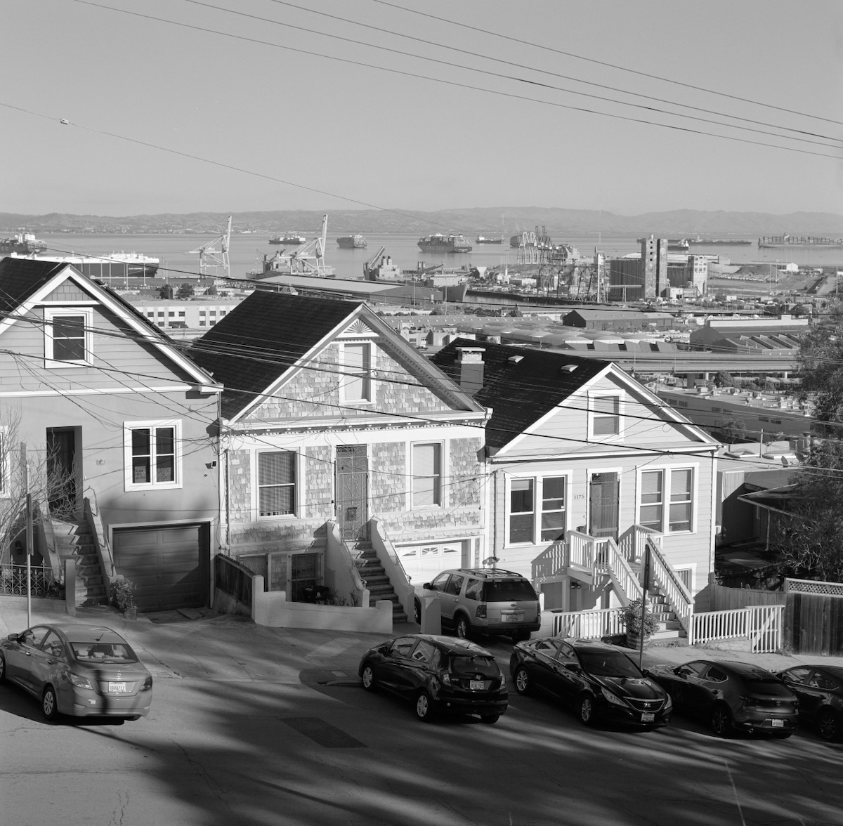

Here is another type of image - also 645 Pro using TMax 100 and replenished XTol, although this film was really old.
