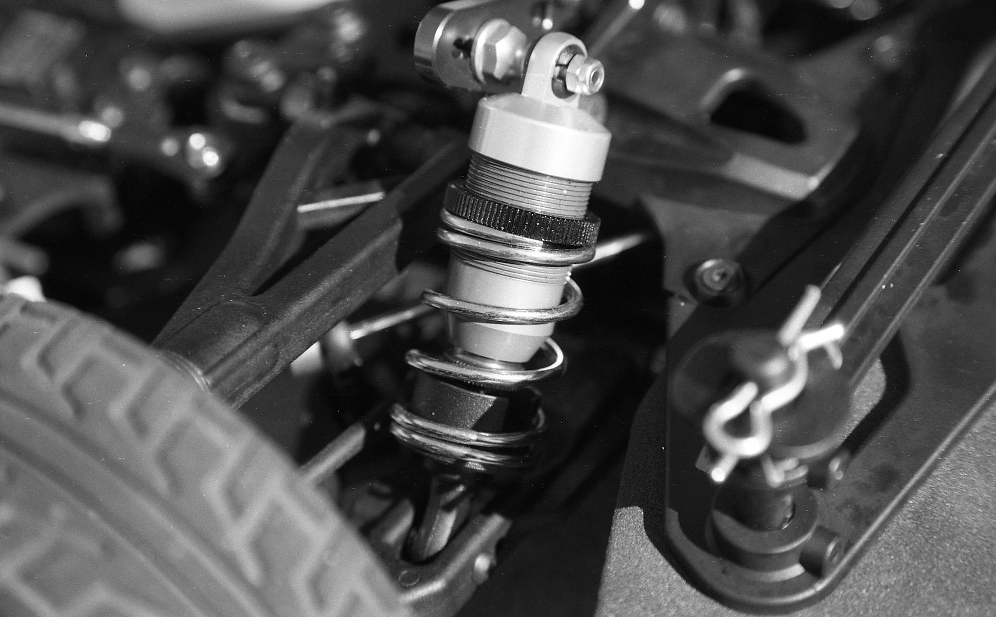

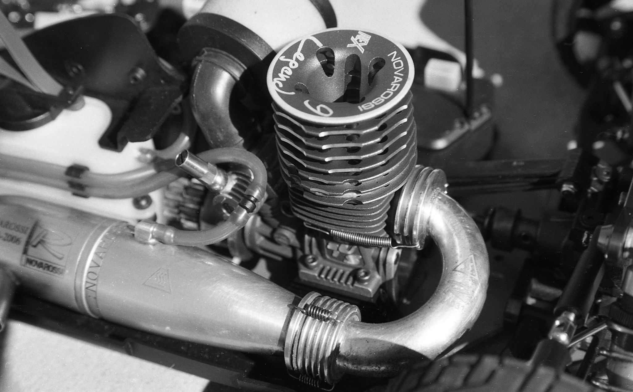

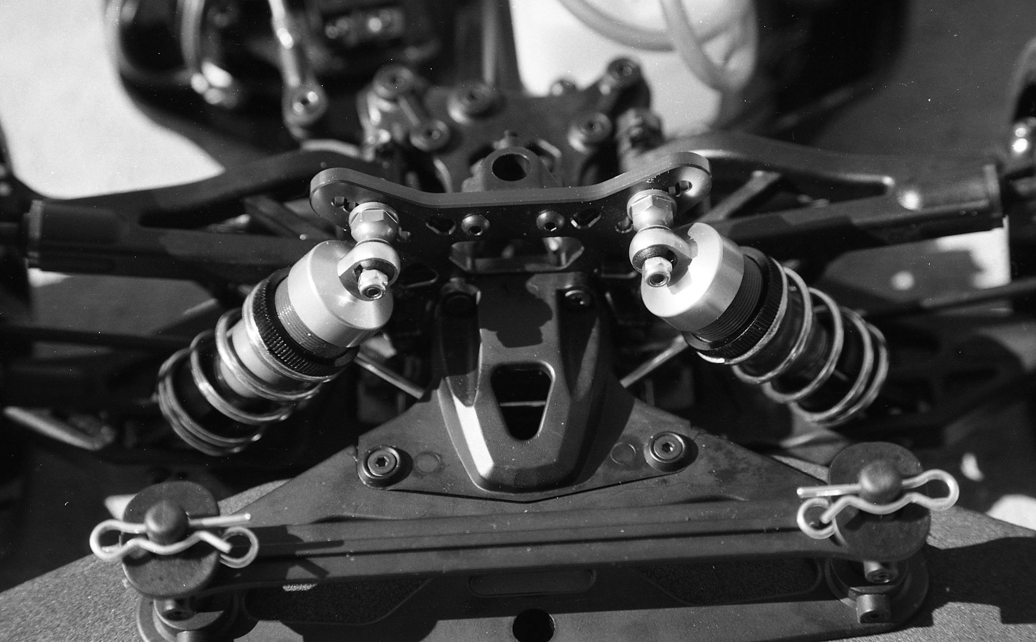

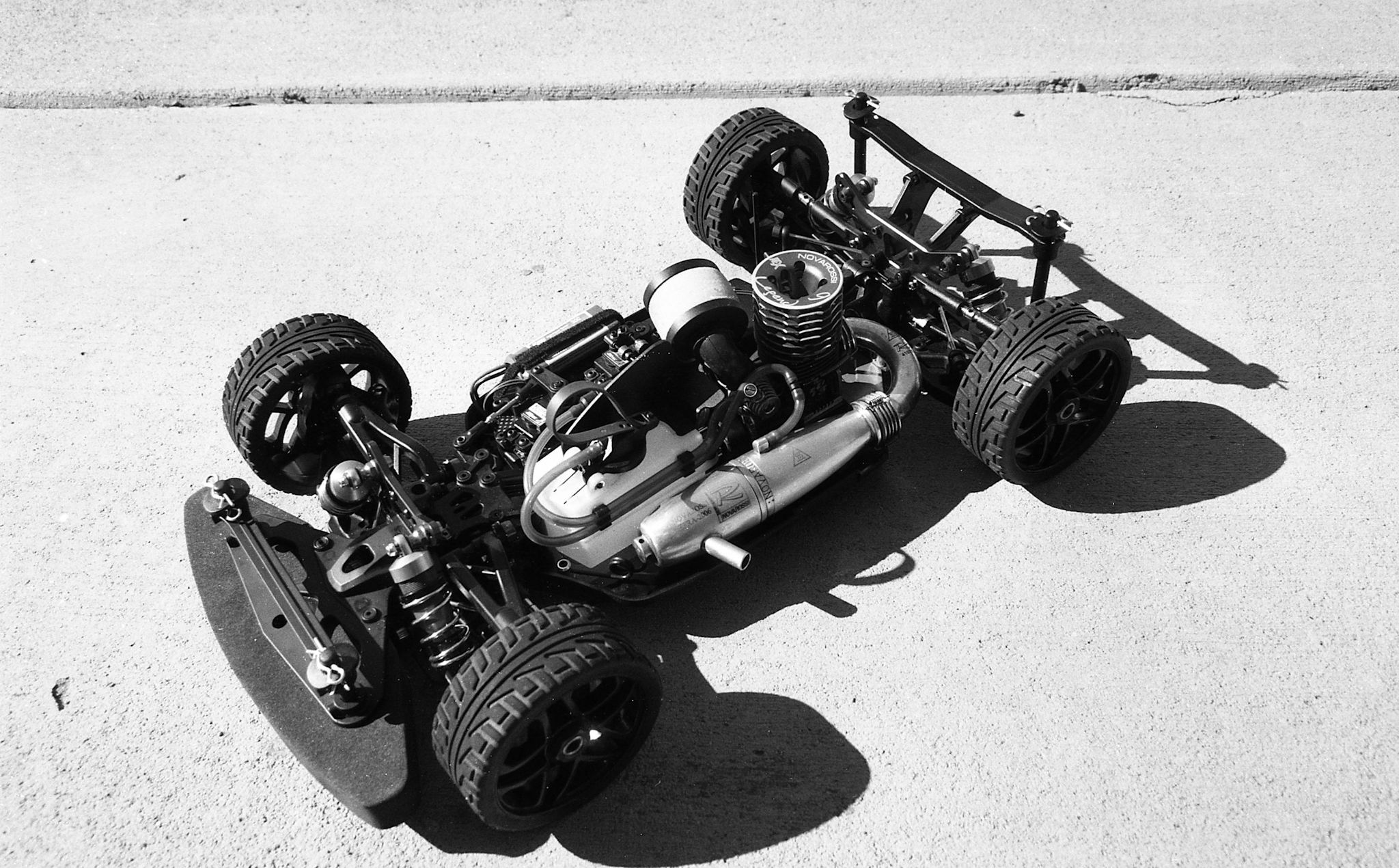

It's been a while since I've taken any shots. Today I decide to grab my 1/8 tour car to see if this XTOL is still working ( same batch, ya, I know ).
Anyway, very happy with the results and impressed it is still going strong. Now if I could only solve my dust problem.
View attachment 196112 View attachment 196113 View attachment 196114 View attachment 196115
A great testament to Xtol's longevity when kept airless with argon. If it is the same Xtol you mentioned in your previous post then that is almost four and a half years old now . Good as winebags are, I doubt if they'd keep it that long.

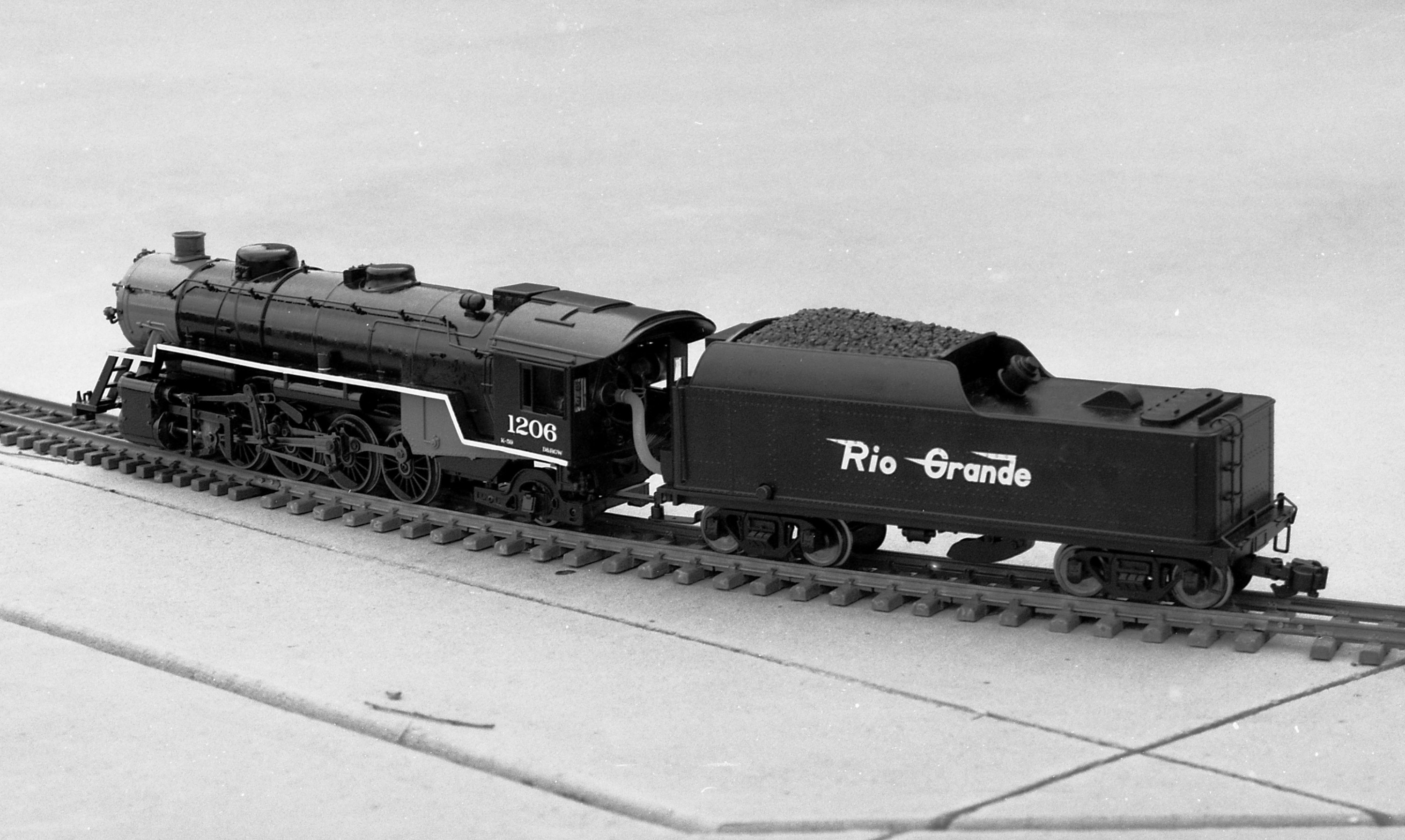

And it continues. For Thanksgiving I decided to fire up my live steam locomotive for my grandkids. I took a few pictures of it and developed them in my now ancient XTOL, seems to still be going strong ( I really really need to get out and shoot more, embarrassed that I can even have XTOL this old ).
Now, I thought I was hosed because I started to process the film and was working on something else at the same time. I took a look to see how the time in the developer was coming and saw the timer still at the start time ( hate when that happens ). Fortunately my internal chronograph works pretty well and the negatives came out OK.
Here is a sample from the now very old XTOL, film is FP4+.
