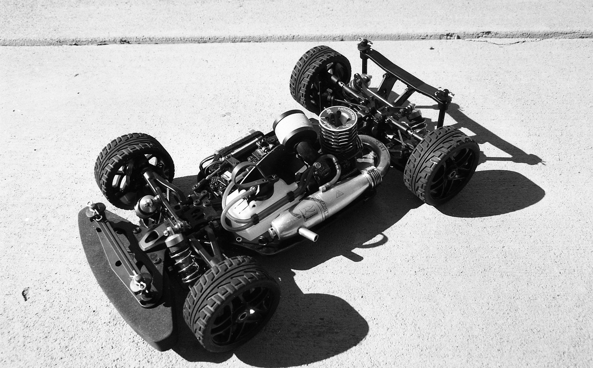

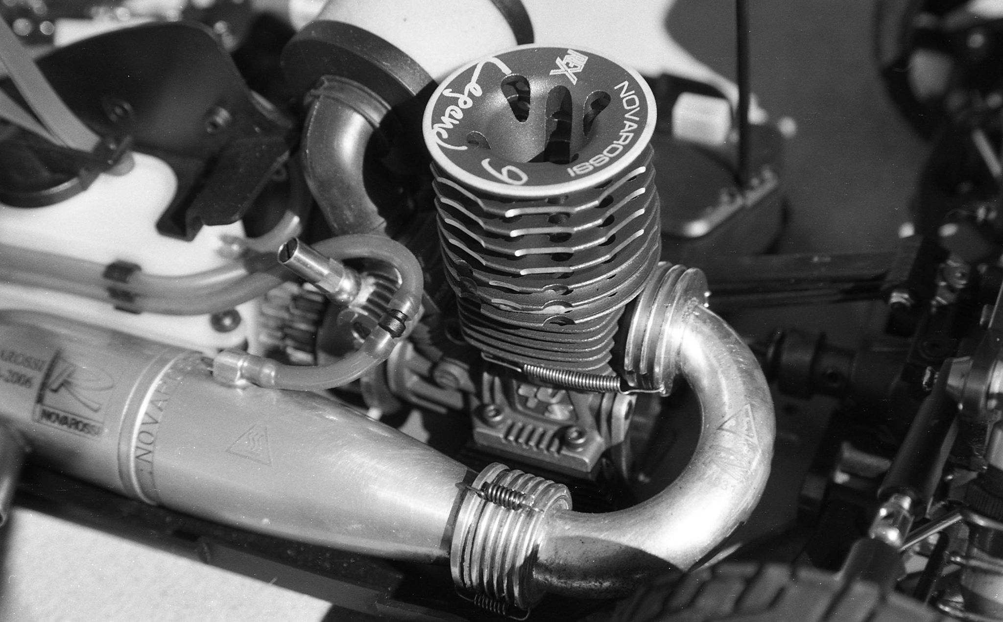

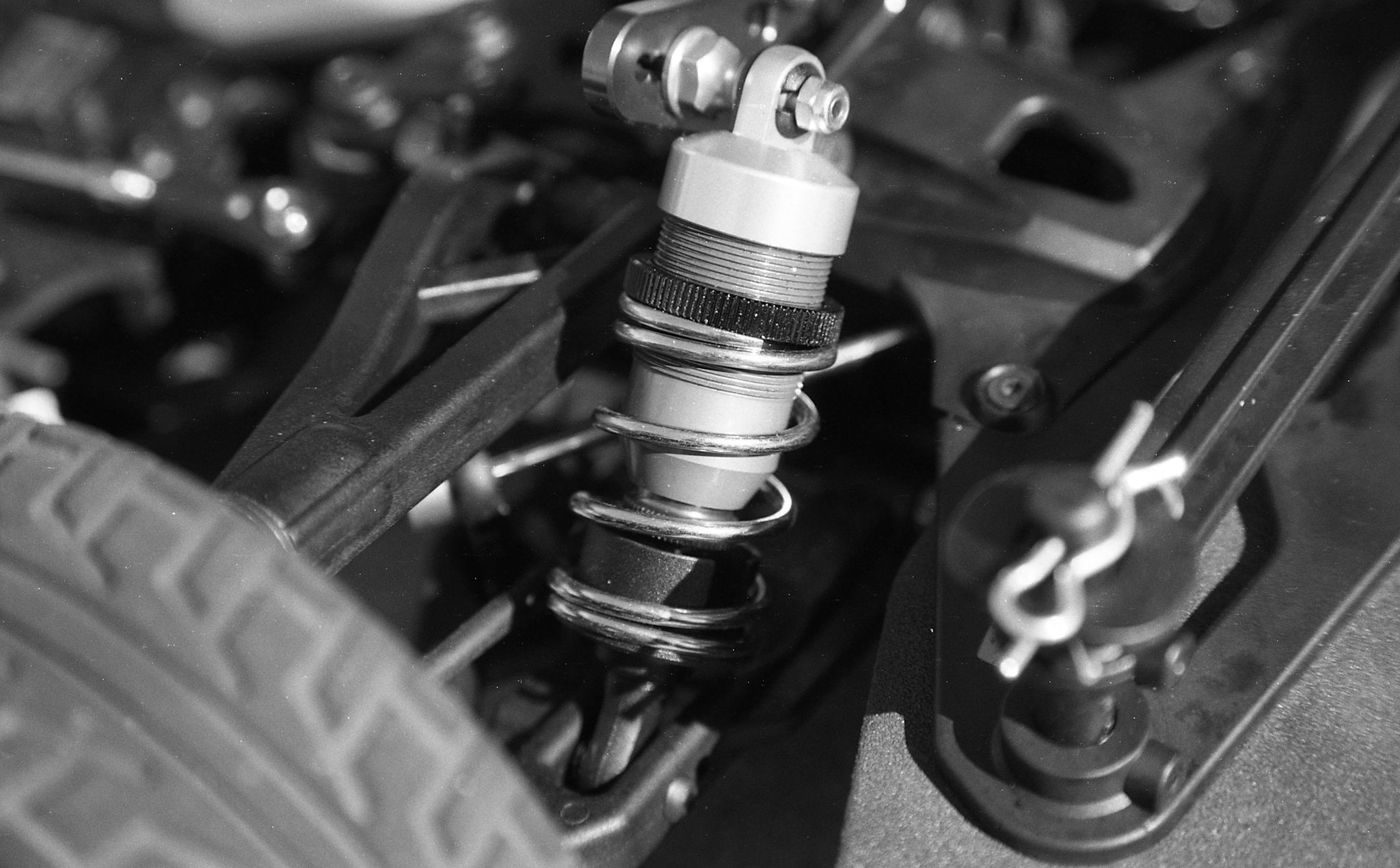

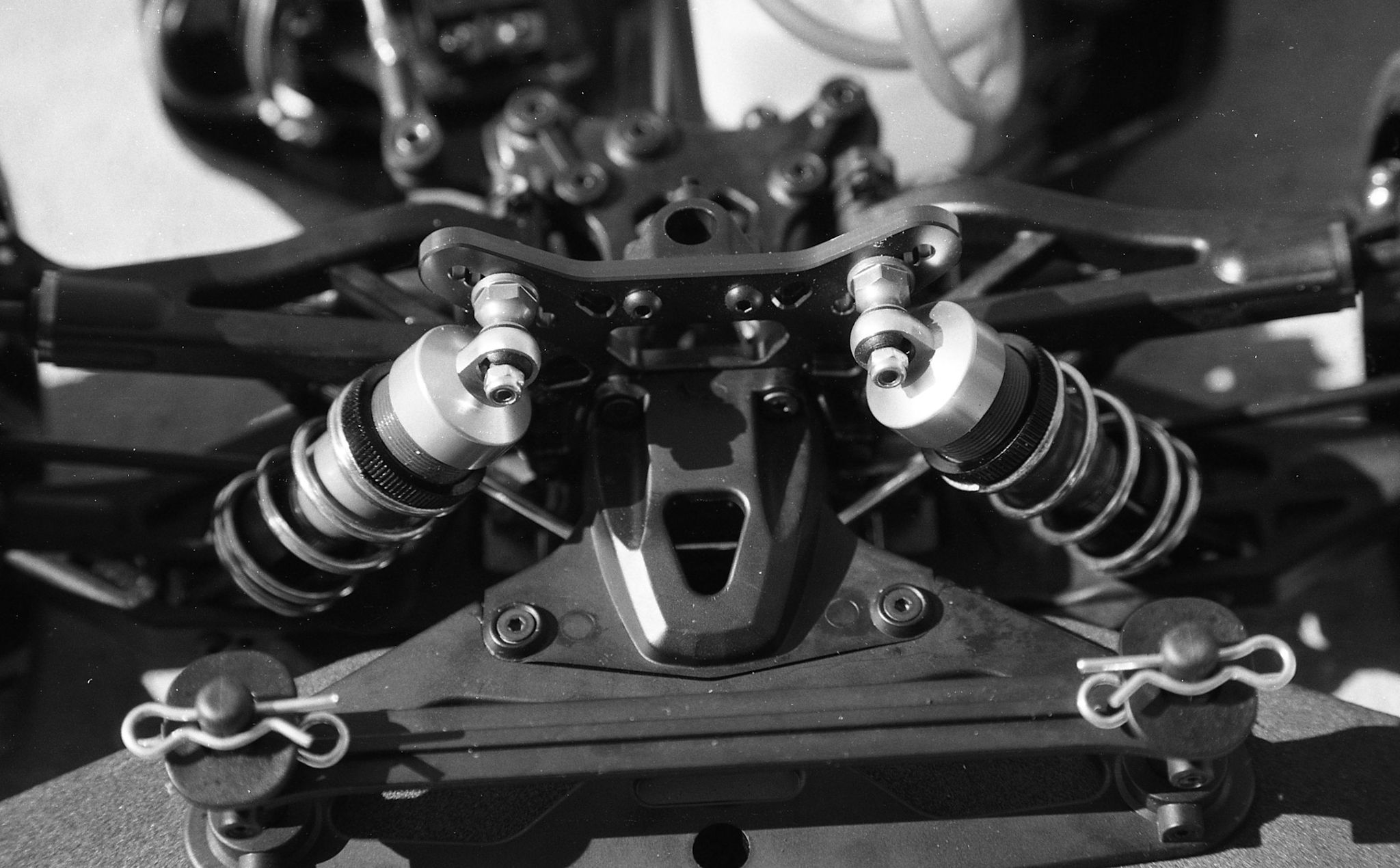

It's been a while since I've taken any shots. Today I decide to grab my 1/8 tour car to see if this XTOL is still working ( same batch, ya, I know ).
Anyway, very happy with the results and impressed it is still going strong. Now if I could only solve my dust problem.
