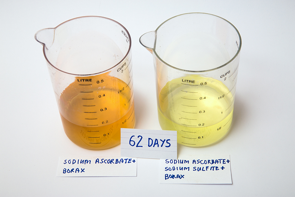

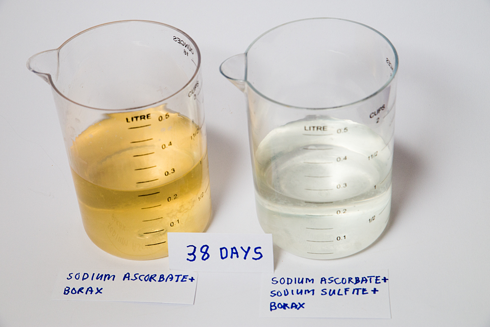

Regarding the initial tests, pH makes a difference in the keeping qualities of just about any reductant. Sulfite is an antioxidant, and it also alters the pH.
PE
The oxidation test was repeated with the addition of Borax buffer (see attachments for color vs time).
........................................with sulfite..............................no sulfite
Sodium ascorbate......................12g......................................12g
Sodium sulfite ...........................20g
Borax decahydrate.....................10g......................................10g
Water to....................................1L........................................1L
pH start.....................................9.1.......................................9.2
pH day 38..................................8.9.......................................8.2
pH day 62..................................8.9.......................................8.2
Since the pH was the same on day 38 as on day 62 I will assume most of the ascorbate was oxidized by day 38.
(1) In absence of sulfite the ascorbate is probably oxidized first to the unstable dehydroascorbate and then to an unknown derivative colored orange.
(2) In presence of sulfite,I suggest that ascorbate and dehdroascorbate combine to produce a semiquinone (shown to the left of that labelled DHA under "Forms of ascorbate" here:
http://www.healthcare.uiowa.edu/cor...erpubs/pdf/Buettner-Ascorbate-Chemistry-1.pdf
The semiquinone is then sulfonated, as happens with hydroquinone, to a (near colorless?) ascorbate sulfonate.
This may also explain the lack of color when Xtol first oxidizes.
There might be a different explanation but IDK what.

Nice comparison.
They mention in the article that D and E support each other in a sense, but since E is not very water soluble, we can't use it. Also, in their "pecking order" the Iron is not very important, but in ours it becomes nearly paramount.
PE
sfaber17
Jun 1, 2014
245
Illinois

A few things come to mind:
  1. Sulfite doesn't buffer at all above pH 8.0. If you think you have fully oxidized Ascorbate after 38 days, pH of both liquids should be about equal, since Na2SO4 has little effect on pH in this range.
  2. There are research papers which claim that Sulfite + HQ oxidizes much slower than Sulfite or HQ alone. A similar process could be happening here.
  3. You should be able to test presence of unoxidized Ascorbic Acid by taking a droplet of your liquid, adding trace amounts of Phenidone and putting that on a film clip in broad daylight.
Alan Johnson
Nov 16, 2004
3,379
Rudi,
I did actually do a test similar to your part (3).
On day 62 , metol 3g/L was added to samples from both solutions and film leaders developed 1 hr stand development.There was no blackening in the without sulfite solution and minimal blackening in the with sulfite solution.
In the with sulfite solution the slight blackening could have been due to development in metol-sulfite or as you suggest, metol in residual ascorbate.Anyhow it indicated there was little activity and no significant ascorbate left.
It seems to me the key factor is that the dehydroascorbate produced by ascorbate oxidation has to undergo a different chemical reaction in the with and without sulfite solutions to give the different colors.

The problem with your test is twofold, and 0.03 g/l Phenidone instead of 3 g/l Metol would have avoided both: first, there is a good chance that Metol develops at pH 8.9 but a lot less so at pH 8.2, so the difference could have been due to pH difference more than from difference in Ascorbate. Second, development by Metol requires Sulfite, too, so the difference could have come from the presence/absence of Sulfite.
Alan Johnson
Nov 16, 2004
3,379
These tests are interesting but not really relevant to my main point, that there are two different reactions, colorless to yellow (with sulfite) and colorless to orange ( without sulfite).Even if there is a little ascorbate left after 38 days, with sulfite it is still going to be the yellow reaction.Nobody has Xtol gone orange.The dehydroascorbate reacts in a different way in presence of sulfite I believe.

I agree with your conclusions but the colors seem backwards. I'd expect the sulfonate product to be orange and the threonic acid and oxalic acid to be colorless. If you had iron in the water that might explain it, otherwise maybe something else happens to the products after a long time. I does seem unlikely any organisms could grow in the borax solution.
Photo Engineer
Apr 19, 2005
29,018
Rochester, NY
Many sulfonates are colorless.
But the fact remains that we don't know exactly what went on and what the final products are.
Good experiment, as I said, but not enough information.
PE
Rudeofus
Aug 13, 2009
5,119
EU
If you dilute the dark orange liquid 1:100 with water, does it have the same hue as the yellow liquid? Also, if you add Sulfite to the orange liquid, does its color change?
Alan Johnson
Nov 16, 2004
3,379
If sulfite is added to the orange liquid it does not bleach it.The dehydroascorbate evidently cannot be regenerated from the orange substance, that reaction is not reversed.I tried this some time ago.
The yellow is the eventual result of ascorbate and dehydroascorbate combining to make two molecules of semiquinone which is then sulfonated.If you try to make yellow from the orange stuff , even if successful it wont be the same chemical substance.
Experimentally one would like to know if there is a chemical test that could identify the presence of sulfonate in oxidized Xtol but I don't think there is.
