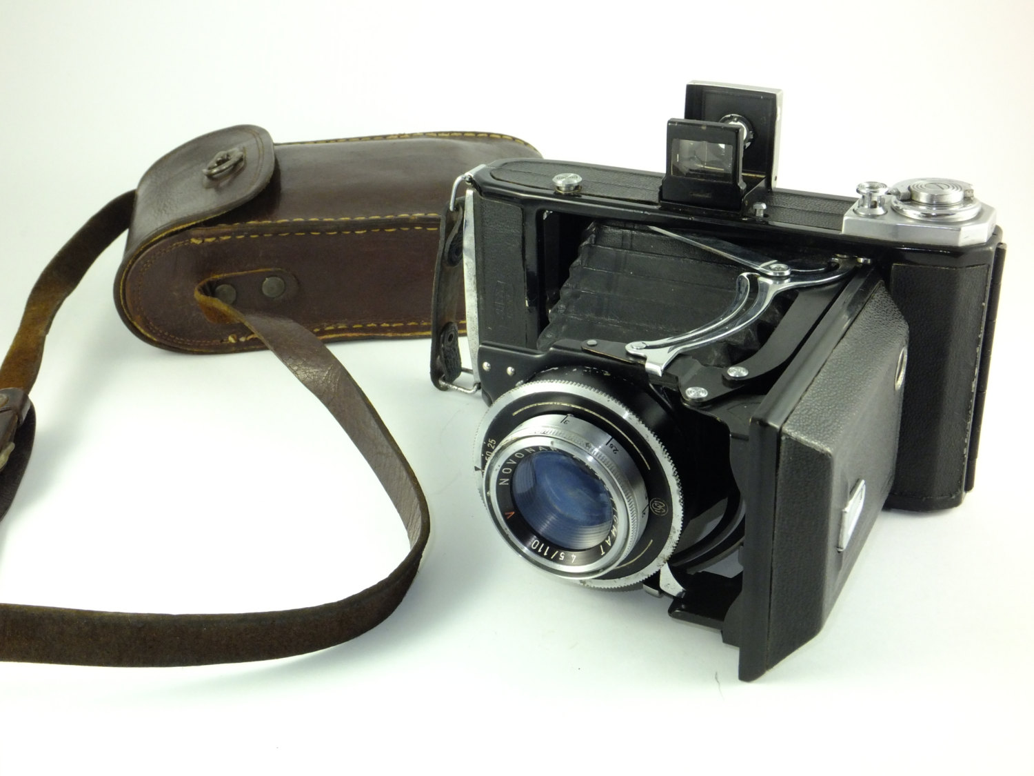

Yes, the M645 is compact, but a Voigtlander Bessa, Zeiss Ikon, or Agfa Billy will fold up enough to fit in a coat pocket, usually have superb lenses (alas at a fixed focal length), obtainable at or less than what you'd pay for the M645 + lenses and accessories.

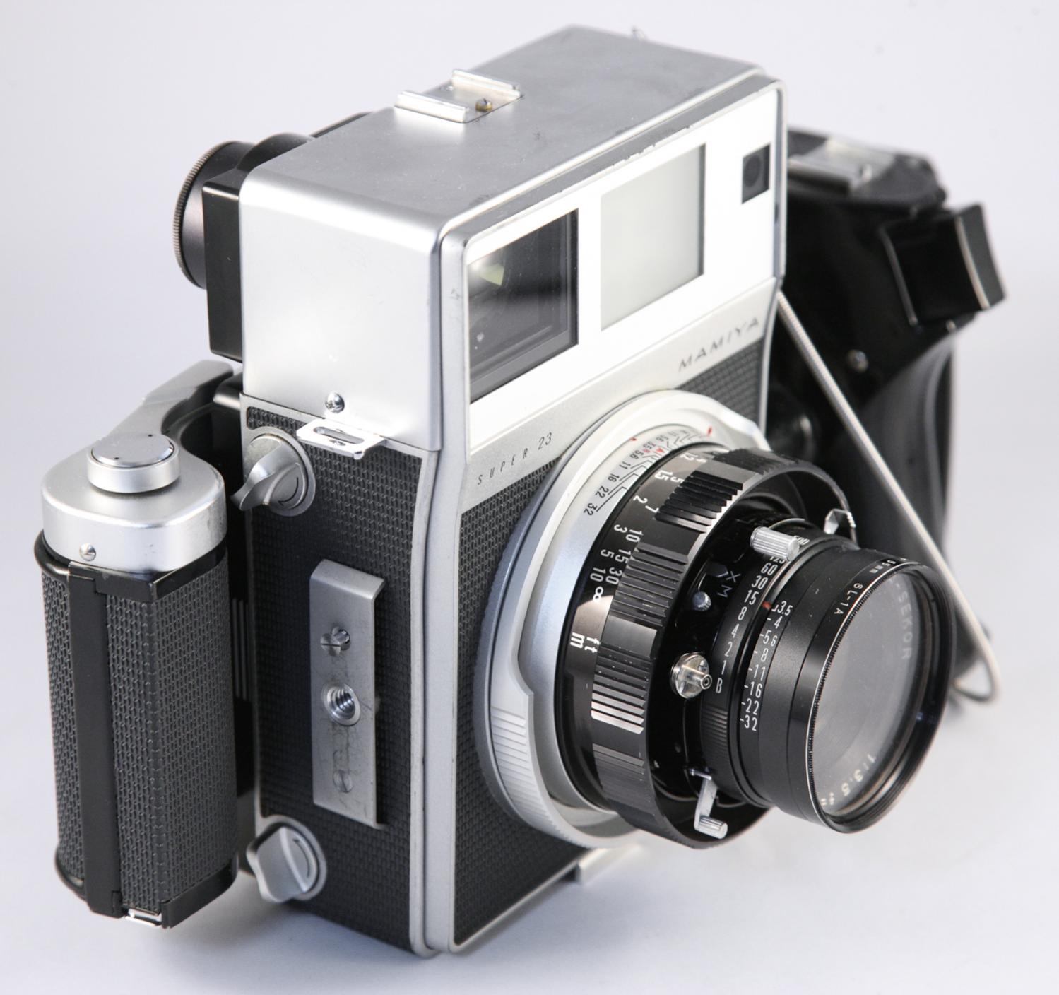

If you really need a system camera in that format, you can get a Mamiya Press 23 and go nuts, though not exactly a pocket camera.
