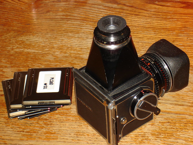

Here's my Hasselblad Single Exposure Back and Holders. I use it because it if fun and different. See how compact it is?
001 by Nokton48, on Flickr
Late to this thread, but unless I missed something in reading through the posts so far, there's another reason not yet mentioned: if you're working on a project in which long-term stability of the negatives is important to you - say, a documentary project that's important to your family or your community - the polyester base on which sheet film is coated is more stable over the very long run, particularly under less than ideal storage conditions, than the acetate base on which roll film is generally coated.
