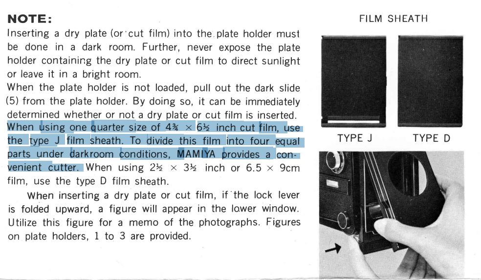

    I'm interested in getting one of these setups for my C3. Based on my research, it's 2.5 and 3.5 films for the Type D holders. Looks like there aren't much available in terms of that size.
    What does "Type J for one-quarter of 4.75” x 6.25” sheet film" mean? What size is the film for the Type J holders?
    Edit: Ok, just found this in the C330 single exposure manual:

    This was my first thought when I saw the single exposure backs. Pocket sized tintypes (Tinytype?). I've shot a tintype on 4x5 and it's seriously fun. Although I am not quite sure about the two types of backs Mamiya offers. Will both of them work with film that is still available today? Which one would you use if you wanted to do tintypes? And are there compatibility issues between the backs for a Mamiyaflex C2 and say a Mamiya C220?

    From j gather, there's a back holder and the individual sheet film holders. Similar to large format.
    The c220 doesn't have interchangeable backs, but not sure about the C22.
